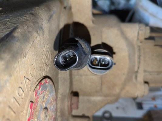

I'd like to have a working speedometer/odometer. I assume the transfer case output is used for that? The GMT800 connector is on the left, the GMT400 connector on the right. GMT400 connector is larger. Assuming this is my speedometer wiring, does anyone know of someone selling adapters, or where I could get pigtail to put this together? Unfortunately, I don't have any wiring harness parts.

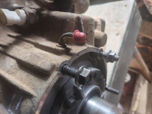

What is this port with the red cover for? A breather?

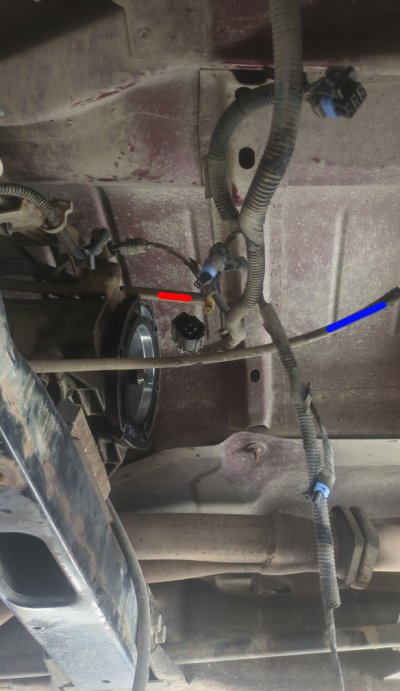

What is the red marked and blue marked line? Blue marked one looks like maybe 3/16" or 1/4" hose.
I am assuming one is a breather, but confused at why I'm seeing two. Not sure what I should do here.

1. Yeah, just steal one of those connectors and cut/splice into your wiring.
2. Yes, that's a breather. I think it routes and terminates near the transmission top of the bellhousing. There's another breather for the transmission as well.
3. The red is the breather, looks like. Isn't the blue the cable for the transmission shifter? Doesn't that come from the floorboard?

You're right about that one cable going to the transmission... Not sure how I got that confused.

Got the swap done! Well, most of it anyway. There's a clearance issue with that red-covered breather and a bracket that I didn't forsee. Breather tube barely fits on and is pretty pinched.
I found a connector and wired it up. In testing, I had the speedometer working. After taping it all up, I must've had a bad connection and it's no longer working.
