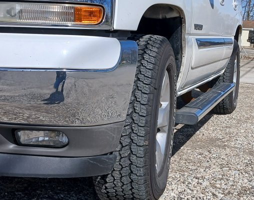

I have 2019 Ram 1500 18" wheels on my Yukon... anyone know whether the 2019+ calipers will clear these wheels? (why? they were priced well with Falkens in good shape, and I like how they look on the truck, and they are different than other GMT800s out there).
My pads are still "OK", but I will be doing an upgrade before they were out. If I can determine that the four-piston calipers will clear the Ram wheels, I may go to them, if I do't feel confident of the fit, I will upgrade to the GMT900 calipers (already have the larger rotors).

I think I'll wimp out and just use the GMT900 brakes. Current brakes are not bad, upgrading to the GMT900 will be an improvement, which should be sufficient.
It looks like the Ram wheels have less offset than the GM wheels, which is why the tires are basically slush with the body, which I really like how they look. While this will diverge a little from the OE front-end geometry, it is small enough to now worry about it, and I see many trucks with much greater change, with tires a couple of inches outside the body, that I should be fine.
