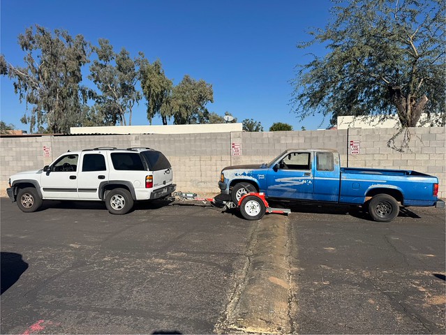

My cousin ended up with it and drove it for a while. Ended up with a DUI and the truck got parked. Fast forward a few years, he learned his lesson and had bought a new truck, so Grandpa's was sitting. His apartment complex was giving him grief, so this past Thanksgiving he asked if I wanted it. That Sunday I dragged it home.

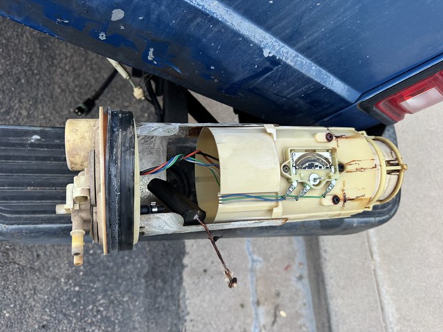

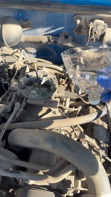

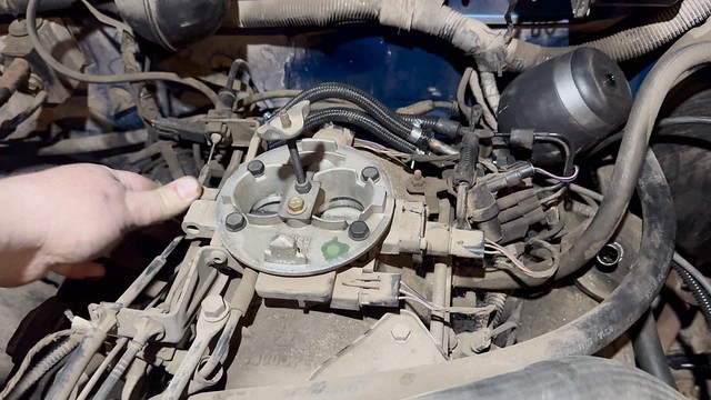

Starter wire needed repaired. Fixed that. Fuel pump is toast, so I got it fired up by bottle feeding it.

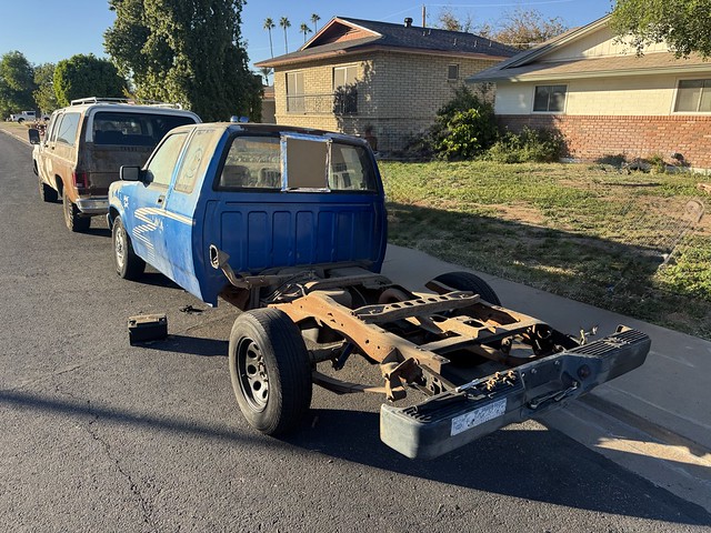

Son and I pulled all the bed bolts and lifted the bed off in preparation for pump replacement.

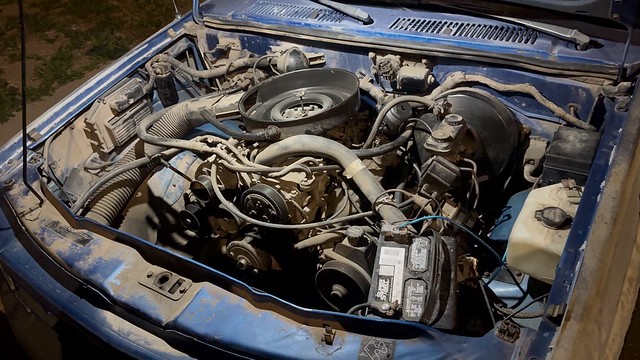

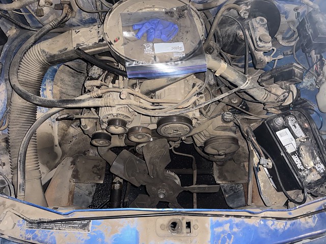

In desperate need of a cooling system flush, so we yanked the radiator and cleaned it out. Water pump and thermostat will be replaced next.
Slow going. Just working on it here and there with my oldest. It'll be neat to have it running again.

Old pump was toast.
We did get it fired after a wicked fuel leak.
Noisy lifter. Quieted down a bit after an rev-up tune up.

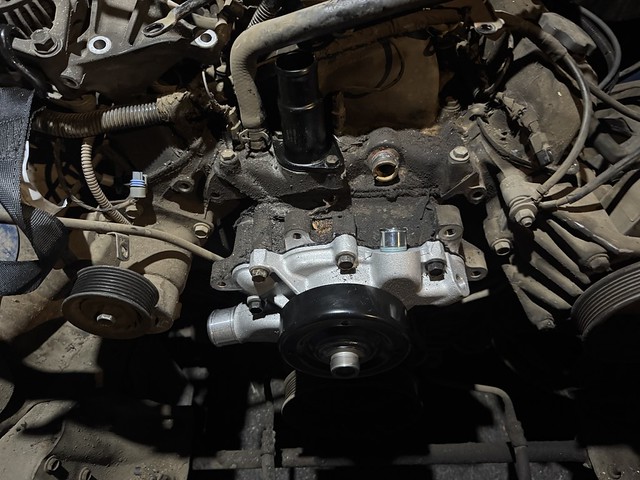

Pulled the upper accessory bracket so we could get at the bypass hose. New water pump, thermostat, and housing. Bypass hose is next, along with the missing heater fitting.

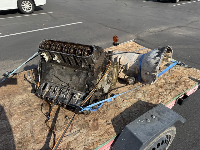

I was able to score a VERY rusty 2004 5.3 engine, already torn down, with all the accessories. Including the wiring harness, intake, throttle body, and PCM. Only thing missing is the pedal. $100. Once I laid eyes on, I saw the short block was beyond shadetree rebuilding.

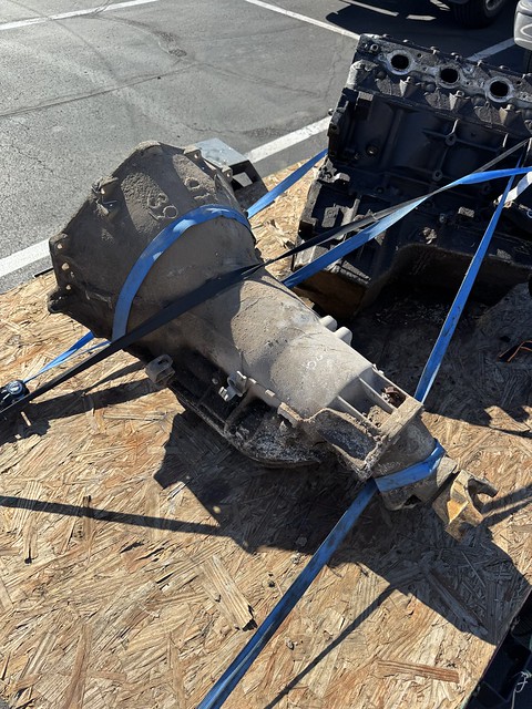

Scared up another 5.3 long block with lifter tick and a TH400. $550

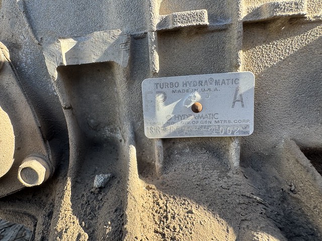

Get it all home and I find out the TH400 is actually a TH375 out of a '72 wagon. Call the guy up, no problem, he's got more TH400s, just have to go back and swap it out. Go back and end up getting this TH400 straight across.

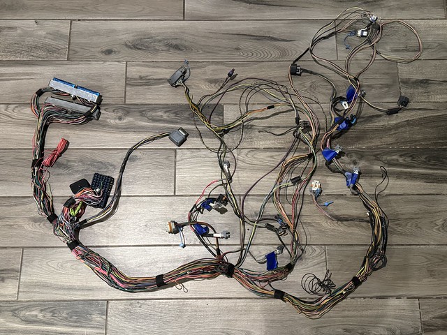

I got rid of the rusty block and crank, kept all of the accessories. Plugged the PCM in to my laptop and verified reading and programming. Got to work on the harness to make it a stand alone. Got rid of a 5 gallon bucket worth of crusty loom and unneeded wires.

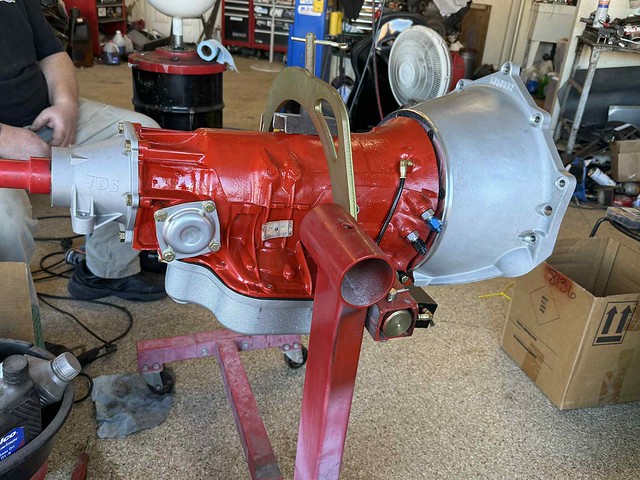

I used his info and Nick from Nick's Transmissions to build a heavy duty race TH400 with my buddy. That's why we're already set up. Bought a couple of sets of Kent-Moore tools on eBay and was able to make a nearly complete TH400 rebuild set. Completely emptied the case, cut the bell off for an SFI one, and built it from the ground up.

Oh, so what i meant to ask earlier was how the TH400 works with the LS engines? Isn't there a TV linkage on those units? I'm not familiar with them.

There’s no cable on a TH400. Kickdown is actuated by a 12v input on the side of the trans. I plan on using the AC off command at WOT to activate the kickdown.
