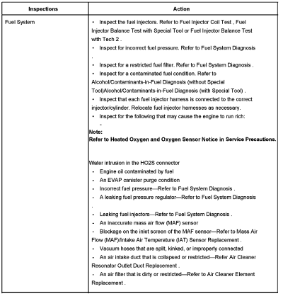

Inaccurate maf can cause lean/rich it's on the list there in the shop manual. I have a feeling it is some sort of electrical gremlin, bad wire or ground, maybe a sensor.
I'm not saying it can't cause lean/rich or stumbling etc. I'm just saying I don't think it's likely to be the sole cause of stalling.
479
1,099
I don't know, here is one of the tables. Intermittent things like this are annoying. I'm going to check it to cross it off the list though. He might be getting a drag on the engine that pulls the idle too low, such as when a compressor comes on.
