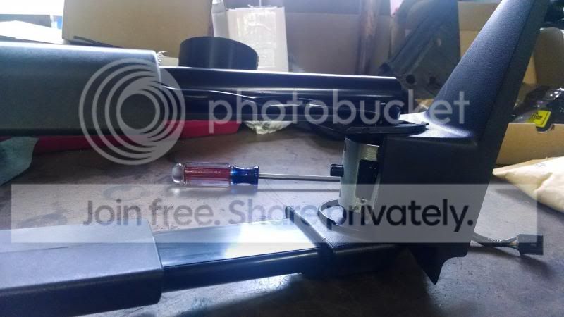

There are some things you should remove from the mirror before drilling and wiring can begin. Extend them out fully and remove the plastic around the top arm and the middle section as shown below. This will allow you to run the wires back through the mirror to the existing plug.

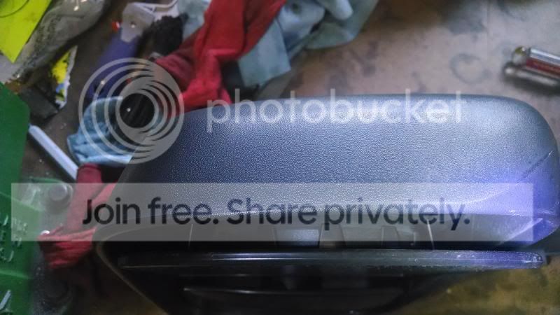

Next, remove the top glass from the housing. You can see in the next picture there are a bunch of small tabs holding the mirror to the housing. Put a small amount of pressure on the mirror pushing outward, and with a small flat screwdriver pry up on the tabs one by on until the mirror glass comes out. If you have heated mirrors unplug the heating element. (this is for power/heated mirrors. Manual mirrors may differ)

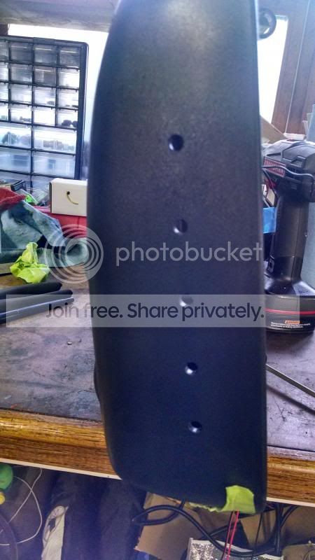

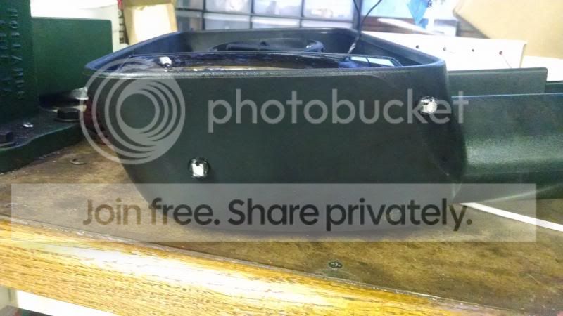

Now you are ready to mark the outside of the mirror for your lights and drill the holes. This is the orientation I decided on. 5 vertical LEDs on each mirror, and 2 of the white LEDs on the bottom for the courtesy/puddle lights.

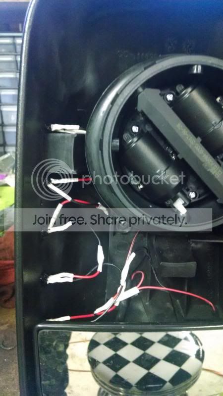

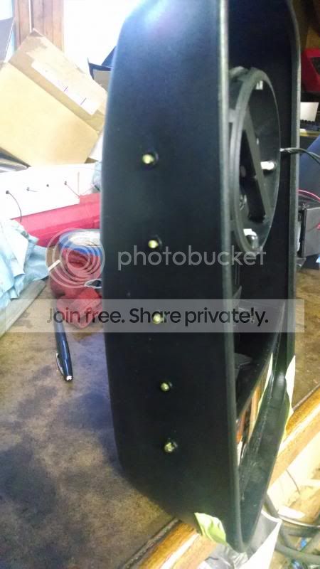

Once the holes are drilled you can insert the LEDs and wire them up. Like I mentioned earlier, the turn signals are wired in series, and the puddle lights are in parallel since they have their own resistors. All of them share the same ground, but have two separate power sources.

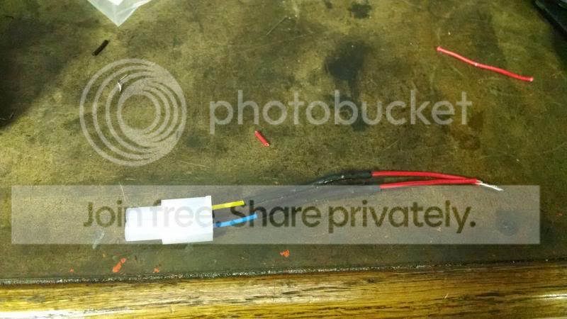

The pin/socket connectors mention in the parts list are used to bring the parking light and turn signal power sources to the Amber LEDs. Here is the connector for the mirror. The 150 Ohm resistor is soldered to the light blue wire, and the 560 Ohm resistor is soldered to the yellow wire. I also have on of the 1N4001 diodes in with the blue wire, to prevent the parking light power source from flowing back into the turn signal circuit. You only need one diode because the electricity will follow the path of least resistance and the LEDs offer less resistance than the 560 Ohm resistor. After the resistors, the two wires are tied together to one red wire to power the LEDs in the mirror.

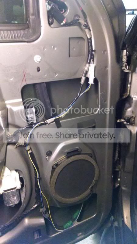

Here is the wiring inside the door panel following the factory harness.

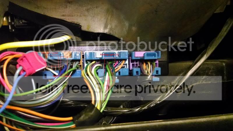

Here is a picture of the BCM. The wires used for the turn signals are the light blue and dark blue wire right next to each other in the left brown color plug. The light blue wire is the left turn signal, and the dark blue is the right. The parking lights are powered by the brown wire in the middle light blue plug. I used the pink crimp style connectors on these because I could not get my soldering iron under the dash. You can see one in place already on the left turn signal wire.

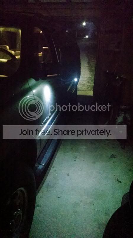

The finished pictures are the greatest but you can see how bring the puddle lights are:

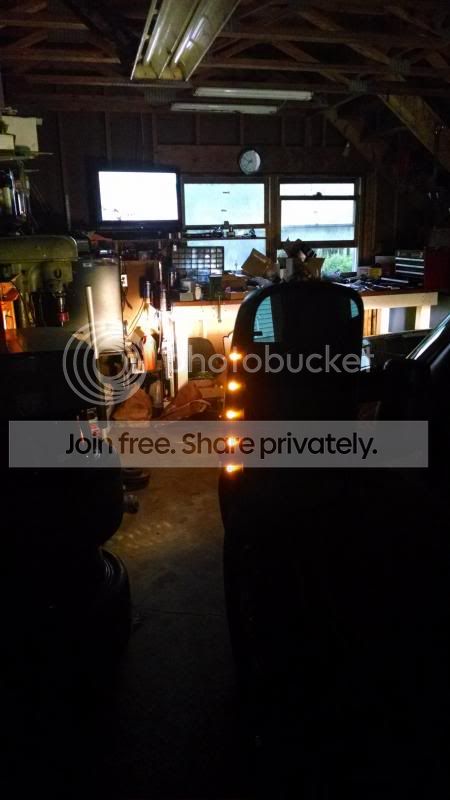

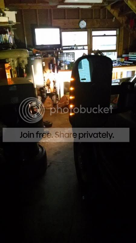

And the turn signals are much much easier to tell in person, but the second picture with the turn signal you can see the background is darker so you know the LEDs are putting out more light. I can try and get better ones or a video if someone would like.
Parking Lights:
Turn Signal:
