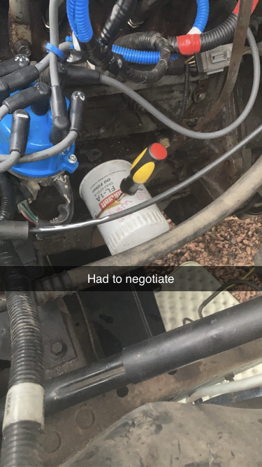

I use a drill , i punch more than one hole because i want to speed it up, but just get a small drill bit and drill one at an angle in the veryb ottom (you dont want hot oil directly into your hand and drill) that angle means you have time to pull it away
Then you can put a few more in the thing or just let it do its thing. to not walk the bit i just gently punch the thing with the bit to make a mark and start slow

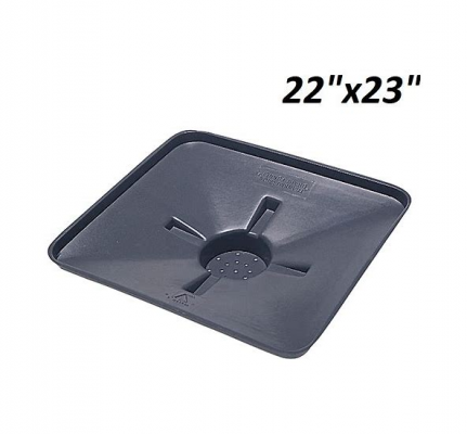

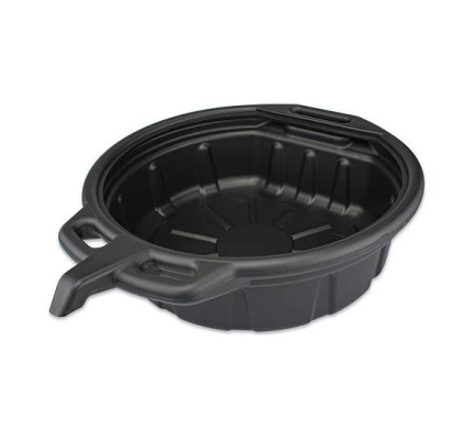

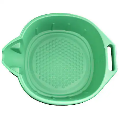

I guess I'm just being nit-picky. I probably just need a larger drain pan. I've got one with the screw top, but it's kinda small... SMH
My next new post is going to be: what is the best oil drain pan? LOL

i have that second pan. Usually i drain the oil first, then come back when its done dripping and move the pan under the filter and remove and replace. Im more annoyed by the fact 2/3 of the filter is un grabbable where it is, which is why i like Frams grippy texture. Ive had some real challenges with smooth ones

if you drill a hole or punch a hole in the filter, a little screwdriver gives you that little extra turning power to loosen it off
