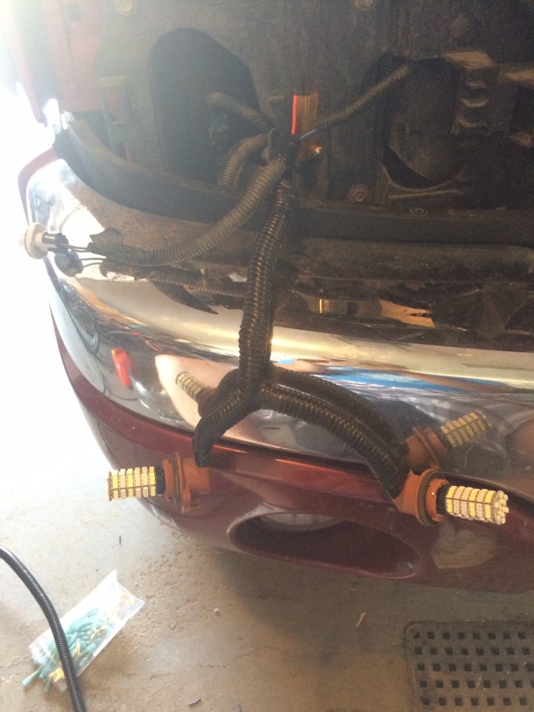

Lol sorry guys I fixed this up quite a while back. The parking light not working turned out just being a blown fuse. The switchback bulbs turned out being faulty and I bought new type 1 that alternate amber white amber white. Here is the setup I'm running now.
Deleted my drl and tapped my parking light to my drl wire. Wired up another signal socket. This makes the led switchbacks operate as my drl until I activate the signal.
