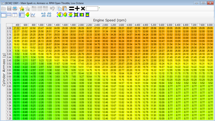

I dont know where you find a list, I just started learning one item at a time. Start posting them here and lets all talk it through. By the way, here is a spark advance table, 30 is very common.Screenshot 2025-08-06 095105.png
