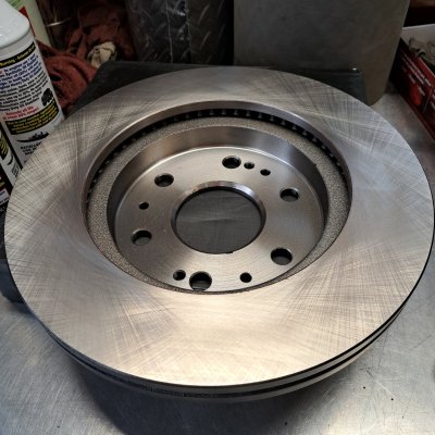

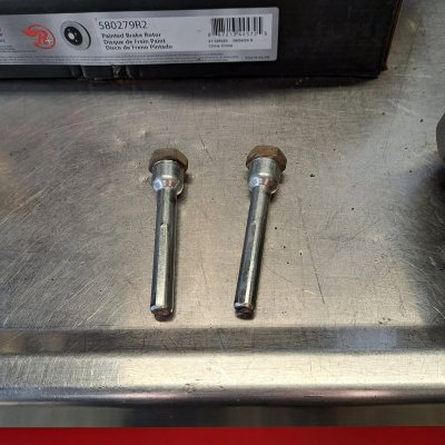

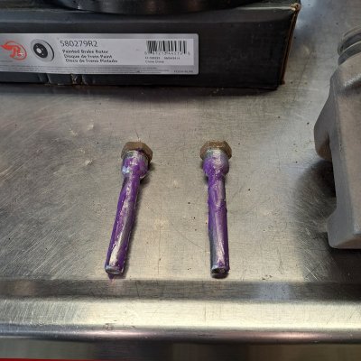

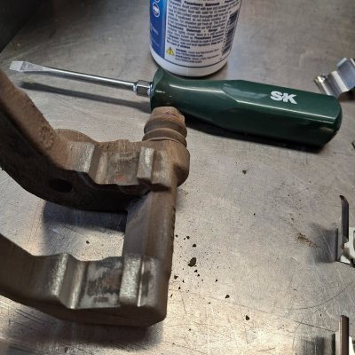

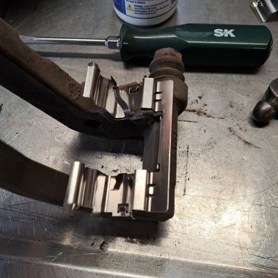

Landlord's 2018 Suburban LT needed front pads and rotors. Pretty bad pulsation. Took apart and found both inner pads were wearing at an angle. Took a long breaker bar to break loose the bolts that bolt the caliper brackets to the hub. All fixed and is now smooth. Pics are of the new rotors after I cleaned the coating off with brake clean, caliper slide pins cleaned and lubed, new pad hardware...
Looks like a nice job.

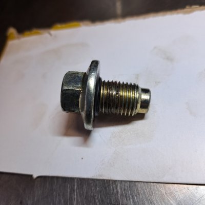

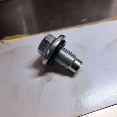

I did the oil change and the drain plug had been overtightened and came out slow and found stretched threads and had a slight oil leak at the drain plug. I had already bought a new drain plug and it went in with no problems. Old and new drain plug pics.

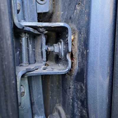

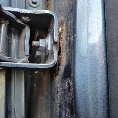

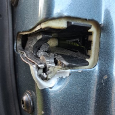

The wind noise is caused by the upper hinge mount area, of the body, being cracked and pulling away and door sag. Someone at one time or another had loosened the attaching bolts at the other side of the hinge, where it attaches at the door. I tightened up the bolts and now you have to slam the door to close. When you push door by hand, up to the latch/striker, it has a springy effect that springs it back. He is aware the door will have to come off, new metal at hinge backing on the body side, reassemble and align.

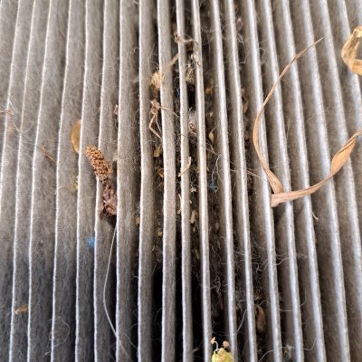

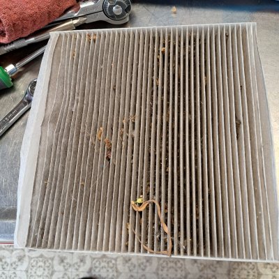

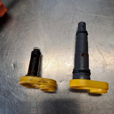

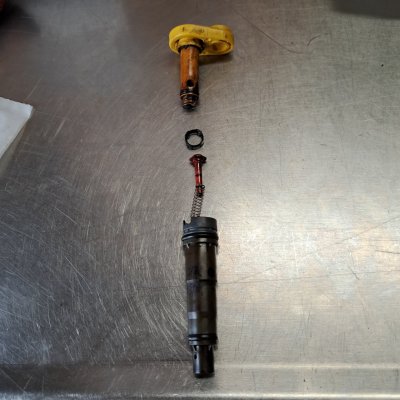

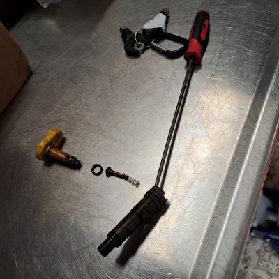

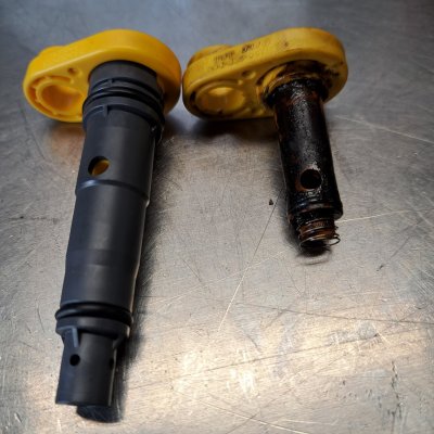

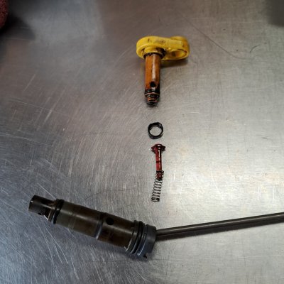

Did an oil change on a 2019 CRV with 1.5 turbo. All was going good till came time to change the PCV valve. Puches in a bore in the valve cover at the back passenger side. As you can see in the pics, the center pulled out of the housing and left the housing in the valve cover. Gonna have to remove valve cover and push out from inside. Rescheduled for later in the month. As you can see the cabin air filter was filthy.

I believe I have a way for getting that broken piece of the pcv valve out, without removing the valve cover.
#1. The underside of that valve cover, where the tube is for the pcv valve, is not open on the end. It is enclosed. My thoughts of valve cover removal to push out from the inside is a no go but if need be, I could remove the valve cover and have it on a bench to have easier access. Or replace the valve cover assembly, if is a worse case scenario.
#2. There is plenty of room between the passenger side back end of the valve cover and the firewall. I believe there is enough inner diameter to the grey housing of the pcv valve to reach in with a pick with a 90 degree or curled hook and grab at the holes you see in the pics. Then pull it out and I can use a bigger tool to use for leverage at the handle end of the pick. The only thing seized up is the o-rings.
#3. I have a set of left hand thread easy outs that are big enough to slide inside that grey broken piece and see if I can twist it out,
#4. I cannot use penetrating fluid and spray in there because I do not want it mixing with the new oil.

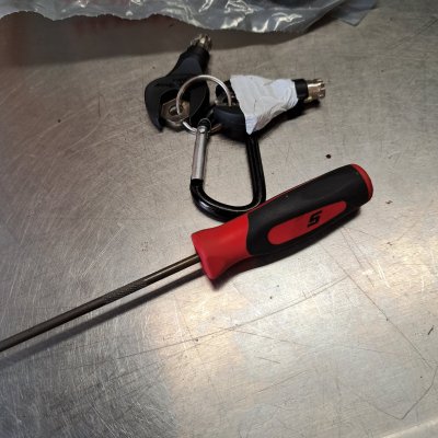

The long Snap On pick shaped like a fish hook on the end, was able to be pushed inside the stuck outer housing and 2 good constant pulls got the housing out. Cleaned the bore and made sure there were no other pieces inside there. Lubed the new PCV valve o-rings and installed and threaded down the hold down bolt. Saved the lady the cost of the new valve cover and the approx 3 hours labor. She was very happy. Then she surprised me with a homemade loaf of sourdough/wheat bread. Turns out she likes to bake. Hope the following pics tell the story.
