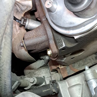

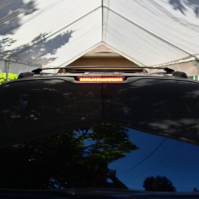

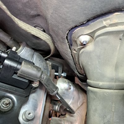

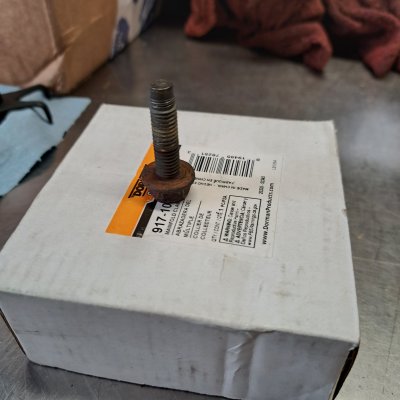

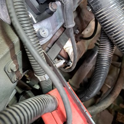

Went back to work on the 2005 Tahoe today. Started with a new 3rd brake light. Then on to the exhaust manifold broken end bolts. Did the driver's side front and rear and the passenger side rear. I had 4 kits and the p/s front end bolt broke loose and came out. I had the extra kit if that bolt broke but it did not break. I installed a new manifold bolt. As usual, the d/s rear bracket kit was a PITA and the p/s rear required the dipstick removal and then the starter unbolted to allow for me to find the dipstick hole when I went back together. All together and no problems and drove out with no noises.

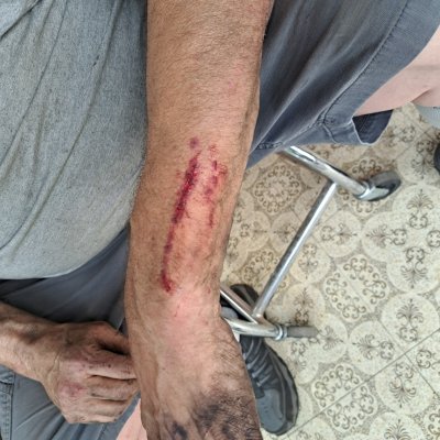

Got a NICE gouge on my left forearm that bled pretty good and after cleaning, my girl sprayed the Bactine on it and watched me squint.

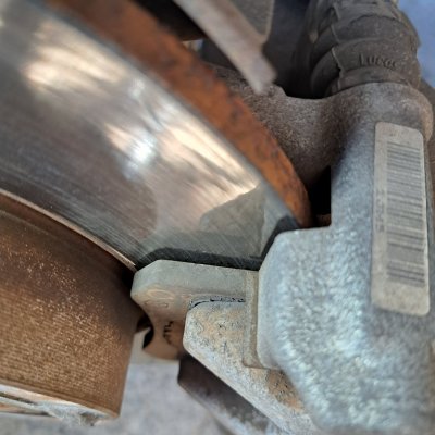

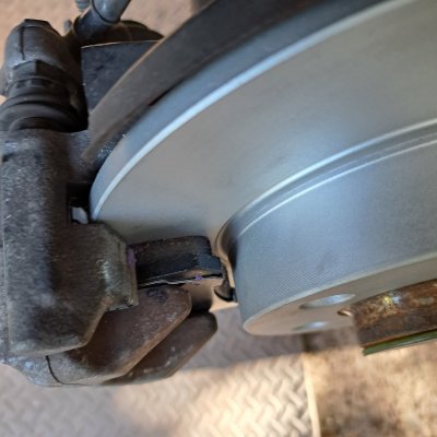

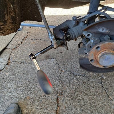

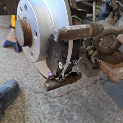

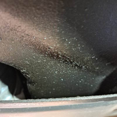

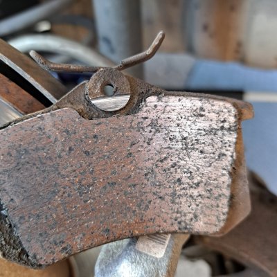

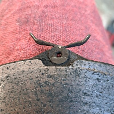

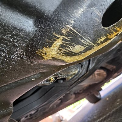

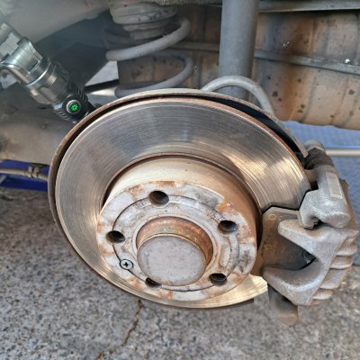

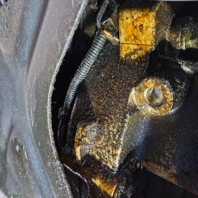

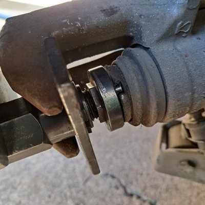

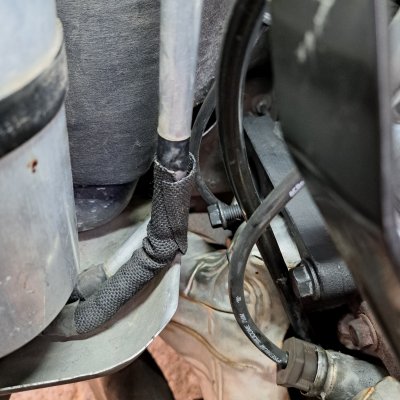

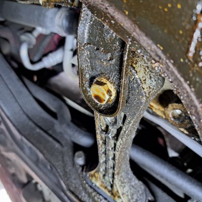

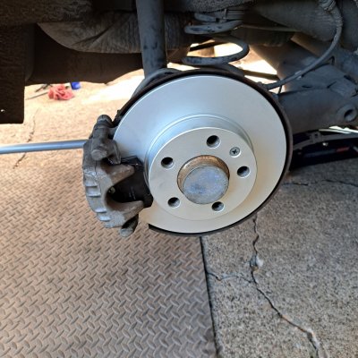

This morning worked on a referral. A 2006 VW Beetle with exhaust smell in the passenger compartment when at idle or moving real slow. A LF klunk noise when turning, like backing out of driveway. Brake noise.
Found severe oil leak that is getting on exhaust and is the smell source. Klunk noise easily duplicated going 20 mph in neighborhood and rock steering from 3 to 9. Suspect in steering shaft or coupling or strut bearing assembly. Suspension and steering LOOK tight. Brake noise is the rear inner pads are thin enough that the rivet that holds the caliper mount springs is rubbing the rotor. Requires a special tool to collapse the caliper pistons. Have to turn the piston clockwise while applying pushing force. Tool worked great.

These vehicles are known for driver's door window regulator problems. This one has that problem. I looked at 3 videos at you tube and it looks like a royal PITA to do. Their window is stuck about 5" up and moves a little up and down but is stuck. He said he will do that. Fine by me. Also has no passenger side headlight. He says he has "fixed" numerous times. He has a wedge of wood behind a harness connector to help hold it in place. Yep, he fixed it.
I told him the likely oil leak is the d/s side of engine cam cover o-ring. He also needs the klunk noise looked at with a drive on rack.

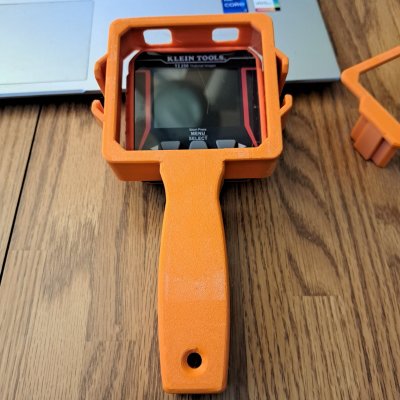

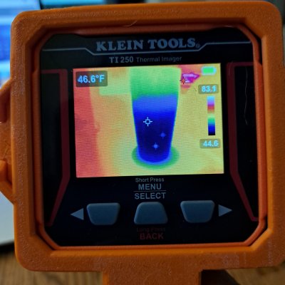

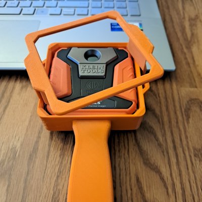

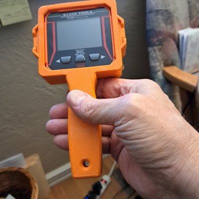

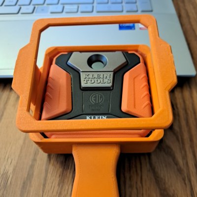

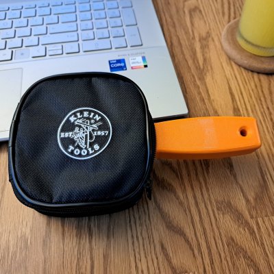

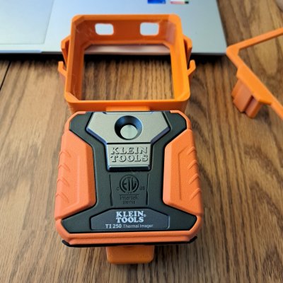

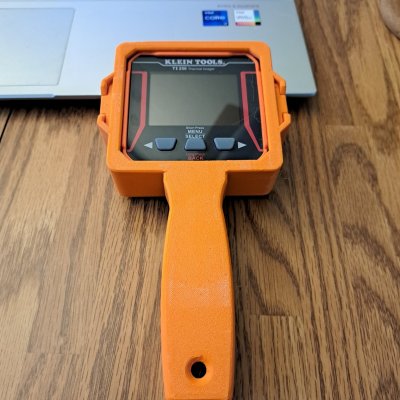

Recently thought about spending large bucks for a new Snap On EETH310 Thermal Imager at ebay. I have come across about a 12 times when a thermal imager would help with diagnosis problems.

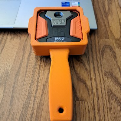

If I was still in shops I could justify it but since I am not, I justified, to myself, that a Klein Tools imager and handle is in my financial wheelhouse. You can see how it drops in to the handle and then can use it with or without handle.

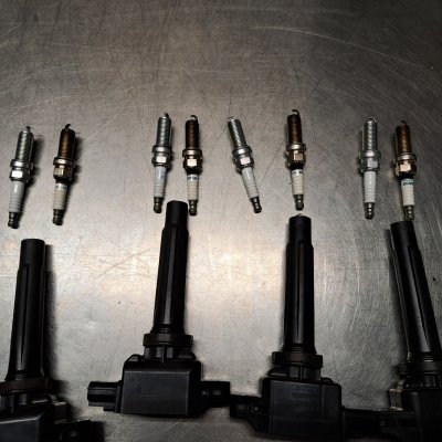

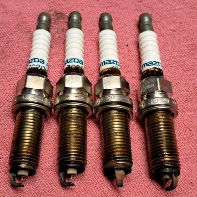

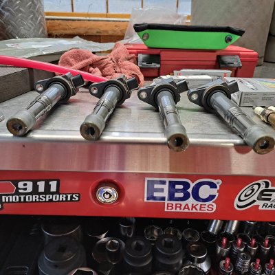

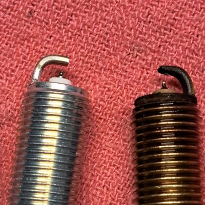

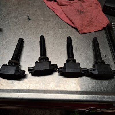

Friend of one of my neighborhood customers called about her 2014 Mazda CX5 2.5 CEL on and no power. Had P0303 only. I think it went in to a limp mode. This happened on her way to work, yesterday. She has her own code reader and cleared the codes and then drove here after work and dropped off. Said it had a misfire but no CEL. I attached my reader and no codes. 125k miles and still had the original plugs in it. Plug ground burned badly and deposits from weak spark and absolutely filthy filthy backside of throttle body bore and plate. I replaced plugs, cleaned MAF, replaced filthy air filter and spent 30 minutes, just doing the cleaning of the throttle body. Back together and runs like "A striped ass ape"!

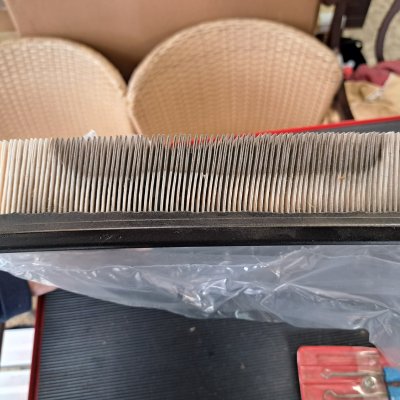

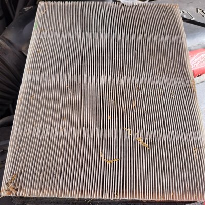

Oil & filter change day. WIX 51522 oil filter and Valvoline Restore & Protect 5W-30 full synthetic oil....6 quarts.

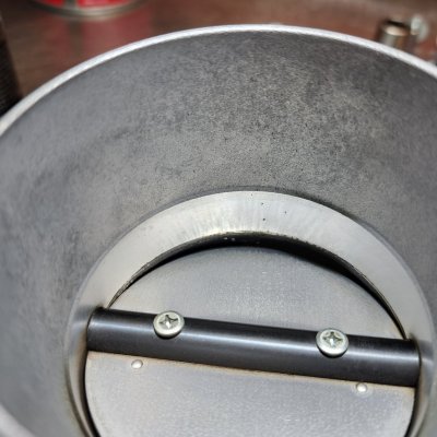

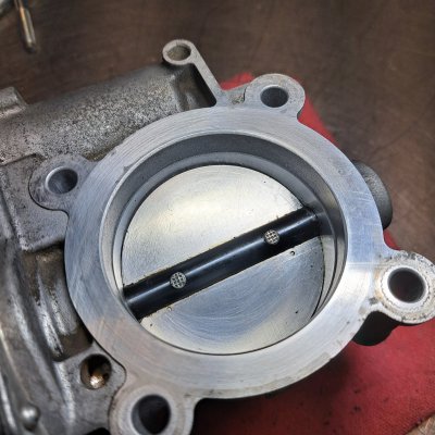

Cleaned the MAF and changed the air filter with a WIX filter.

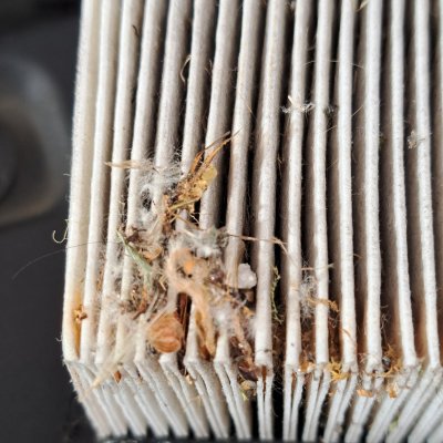

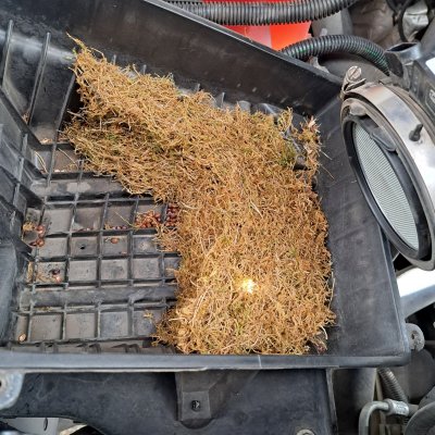

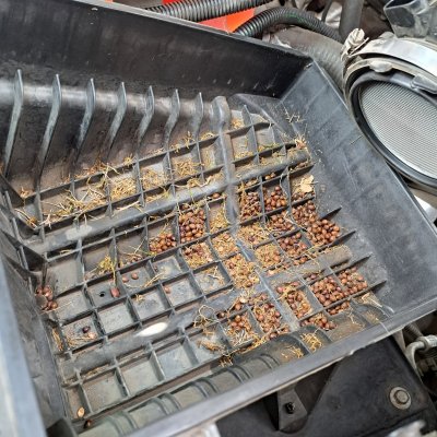

Then I found this and pulled the nest out and vacuumed out the case and sprayed rodent deterrent inside the case and all over the cowling area and the engine compartment.

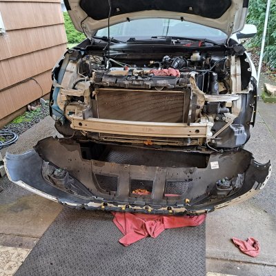

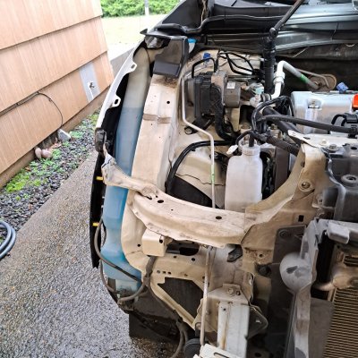

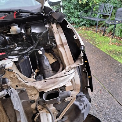

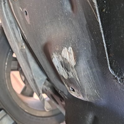

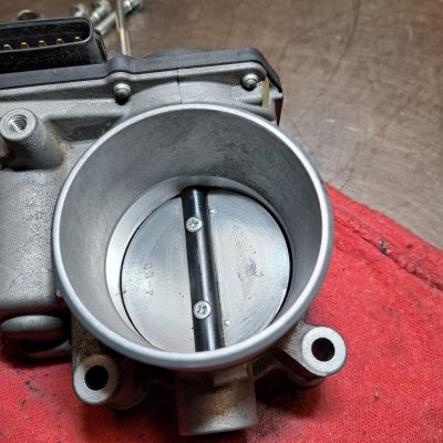

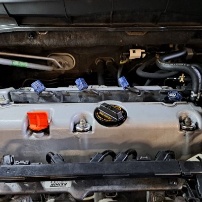

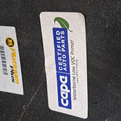

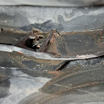

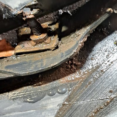

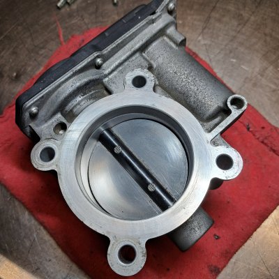

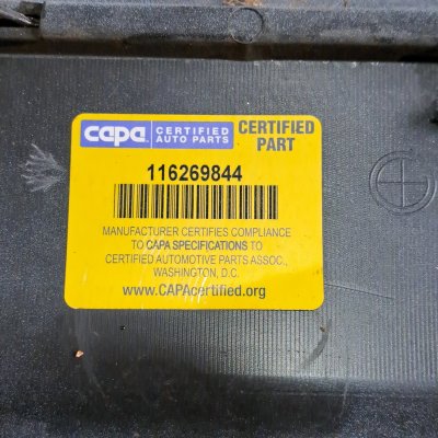

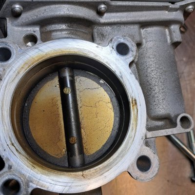

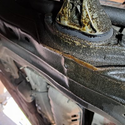

Yesterday started work on a 2012 Honda CRV. Doing headlight assemblies, oil filter/drain plug access cover replacement and a splash shield replacement. Plugs, pcv, engine air filter, cabin air filter, remove and clean the throttle body. Found that the front bumper had been replaced before. D/S bolt to lower wheel well was rusted and ripped the captured nut but is easily fixable. Most done yesterday but headlight assemblies did not come till 4:30 via UPS. Gonna finish headlight assemblies this morning along with the lower shields. Yes, that is dielectric grease in the ends of the freshly cleaned ignition coil boots.
