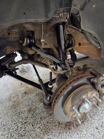

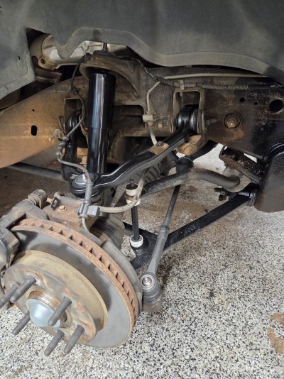

I was rebuilt the front end of a 2002 Silverado 1500 4WD...I should have know better, but a bought the Monroe OE Spectrum shocks from Suspension.com because I had bought the Monroe upper and lower control arms. Anyway, I noticed that the Monroe shocks were about a 1/2" shorter than the shocks that I took out...the result is that the upper control arm doesn't bottom out on the droop stop when the suspension is unsupported - the Monroe shock doesn't have enough travel and the upper control arm bottoms out on the shock. Here are a couple of pictures. I've searched for bumpers that would go and the droop stop, but didn't find anything.
Suspension.com said the Monroe tech didn't see a problem with this...I should have bought the Bilstein 5100s...I was dumb to go with the Monroe shocks.
If I overlooked something, happy to learn. The truck is stock.

If you search the specs on all the shocks that fit any vehicle they will not all have the same max extended or compressed length, i just checked 2 Monroe shocks for your truck and there's a 3/10ths difference between them.
I remember discovering this myself when i was deciding to not put Z71 shocks on a Z71.

Thank you all for the information and comments. I did hear back from Monroe technical support - they let me know that the GM Manual says the shock can act as the down limiter instead of the droop stop. Just the same, I am changing them out to the 5100s.
