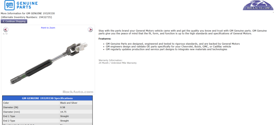

I didn’t. Thinking I could use a new upper intermediate shaft?
You have to pull the upper shaft to do the column bearing correct? I would, my upper shaft was worn and making noise. I replaced it with a nice GM Genuine one. If it is out, you might as well replace it. I hate trying to wedge myself down under the dash

I am not seeing the GM genuine unit offered anymore, I guess mine has been in there a while...

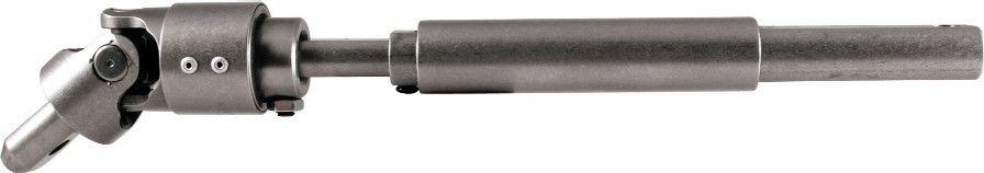

But, it looks like Borgeson makes a nice one for the GMT800

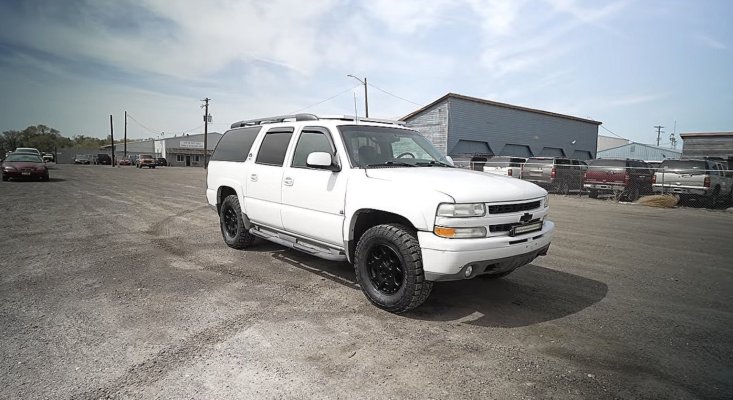

Went looking for pictures of your suburban - they are identical. Plans seem similar too. This was my end goal before I bought mine:IMG_5573.jpeg
This is a screen shot from a Suboverland video - almost went to Idaho to buy from them but the 1 we got in Texas was a better fit.
Have you painted your wheels yet? I’m going to try plasti dip first.

Nice! Yea you did well buying a single owner family car from Texas. She’s ready for adventure
I haven’t.. been too busy with the kids and work. My Father’s Day plans are to detail the Burb, polish wheels headlights restore plastic and clay bar. I’m pretty pumped. I wanna rock the polished wheels for a while and really talk to some experts about the best options for the black. I’m thinking a matte semi shining finish similar to the pic in my thread would be best for the snow flake wheels. Not sure if that’s achieved through cerakote or powder coat or some other means.. in any regard it needs to be durable and then look good. Can’t have any paint or flaking over time
In any regard the wheels are probably a few years out when I get the Burb back for my daily and we get my wife some new wheels
