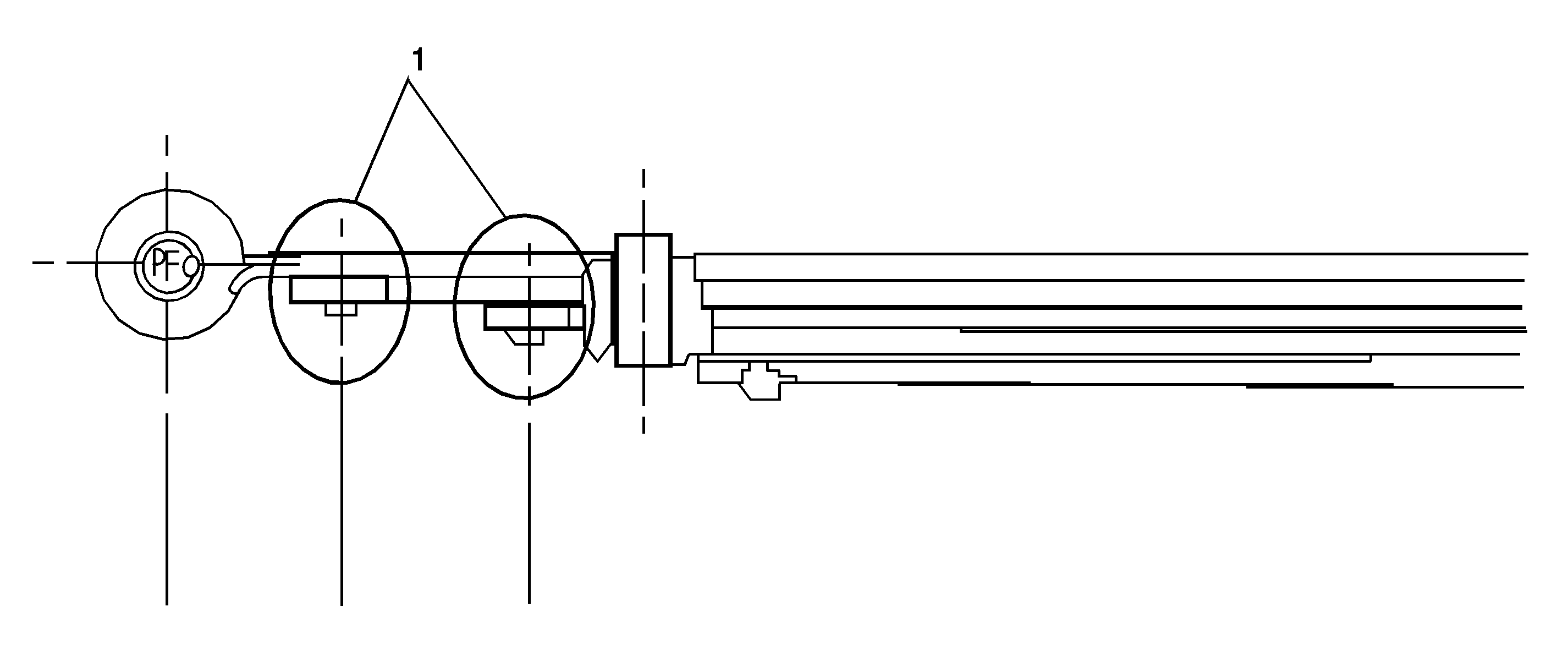

[H3]Condition[/H3]
Some customers may comment on a rear leaf spring slap or clunk noise. This noise is most apparent when the vehicle is operated over irregular road surfaces.
[H3]Correction[/H3]
Important: DO NOT disassemble the main pack on the leaf spring or remove the bushing from the spring.
Object Number: 1998759  Size: SH
(1)​
Insert -- P/N 15604067​
Object Number: 1998758  Size: SH
(1)​
Insert -- P/N 15247030​
Verify that the rear leaf spring inserts (1) are present on the leading and trailing ends of the overload spring (second stage leaf). The insert may have broken apart from wear and fallen out. If the inserts are not present, install new ones.
Important: On some models, the vehicle may have to be raised to allow the springs to separate enough so the insert can be installed.​
