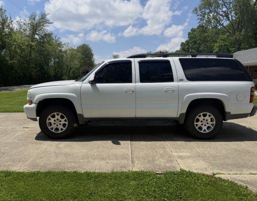

I recently picked up a 1 family owned 03 suburban z71. Threw tires on it and drove it home 1000 miles (Texas to the rust belt!) I’ve started to do some maintenance/upgrades: leveled with torsion keys & new bilstein 5100s. Now that the front end isn’t on the bump stops the steering is very light. I ordered a Wolff engineering bearing for the steering column because there is a slight noise in that area. The ball joints, tie rods seems to be in good shape, with the front end in the air all play from the wheels matches the movement in the steering column if that makes sense. Any suggestions on what to try next? I planned on getting an alignment after installing the keys but I want to get this steering situation figured out first.

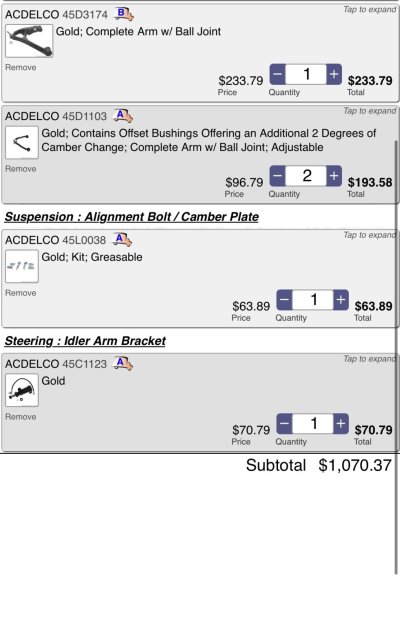

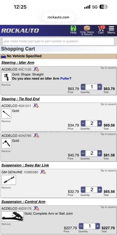

A complete front-end rebuild seems like a really good idea. If you want to save a bit of coin, consider ordering the ball joints and the bushings for LCA. Those are the forged type LCA and definitely can be swapped, but you need a shop press. A transmission or suspension shop can get those swapped and probably wouldn't charge you that much. Or buy a cheap used shop press and resell it after doing the job yourself. Just a thought.

All the parts should be here by the end of the day - hope to get this project done by the end of the long weekend and have it aligned next week. Are there any good resources for the torque specs for these front end components?
