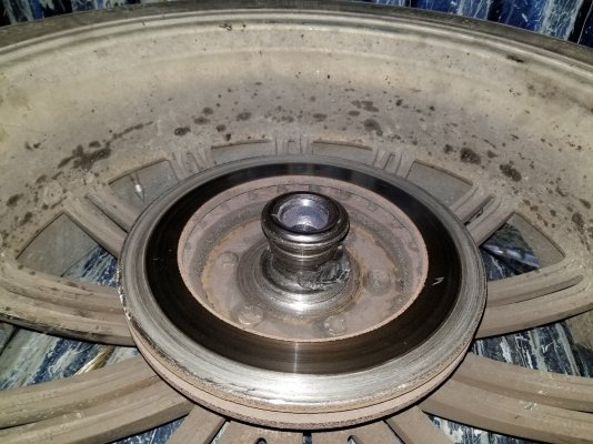

Hi guys, I'm hoping someone can help on this. My 06 Suburban 2500 has had this mild shake when I brake at higher speeds since I bought it back 2020. I replaced the front rotors a few months after I bought it, but nothing really changed so I just kept on truckin'. That was around 225k and it's now near 270k.
I now drive like 60 miles round trip to work in horrible city/highway traffic and the shake is still mild, but somewhat annoying.
I just bought that dial indicator gizmo and measured excessive run-out on the front driver's side. I believe it's the hub, maybe not even the rotor? I'm pretty sure the hubs are the original ones.

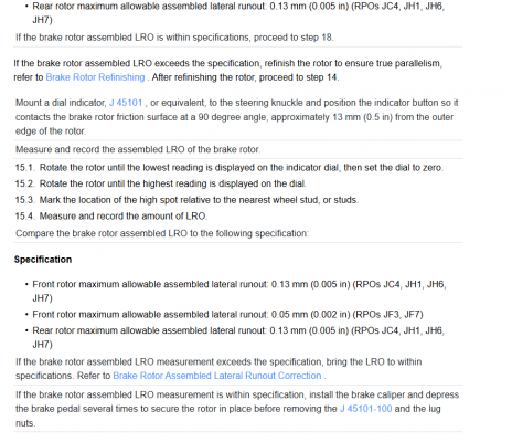

Anyone have experience on this? The Haynes manual lists rotor run-out spec of 0.003, and I have twice as much. Hub is 0.003", which seems high to me, but I haven't found a spec on that. Front passenger side is actually really good. What do you guys think of these numbers?

The hub does sound bad, most manufacturers say 0.002 max runout, and a bad hub will amplify the runout at the rotor. When I was still a mechanic, I saw a lot of problems, vibration, pull, were caused by tires. Plus at that age, miles, the suspension and brake components are likey to be worn. I'm sure you know this though. Best guess it is the hub, could be something else, or a combination.

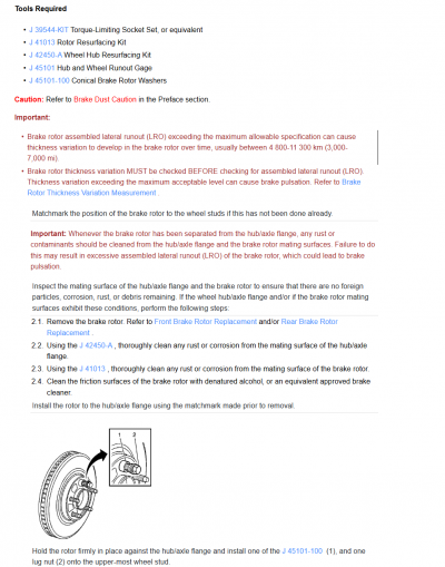

Who's to say the rotor did not have excessive runout when you bought new. May have rust build up where the rotor face and hub face meet. IMO, have rotors machined, if there is enough thickness, and clean the hub face and then drive it. Also, check and clean up pads contact and lube and check pad hardware. Since you have no shafts, should be easy to check drag after road test.

Yes, the rotor being out of spec did cross my mind. On that hub measurement, I checked the lip of the hub directly, which I think shouldn't matter what the rotor is doing, no?
I didn't do any kind of cleaning when I replaced them where the hub and the rotor interface, but I've never done that anytime I've replaced rotors on my vehicles. I don't recall any rust, but I can remove it and check.

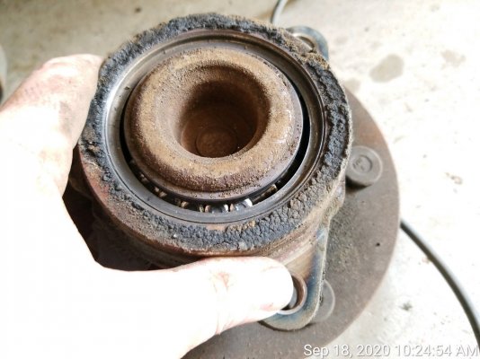

I can't speak for the hubs used on a 2500, but I have serious doubts about the ones on a 1500 making it to 270K. I replaced all four on our two 1500's at just past 100K as they had obvious wear. One of them, the seal had given up on the back and the rollers ran dry, got crunchy, some of them turned sideways. Fortunately the wife noticed the front end sounding like hell and turned around to come right back home.

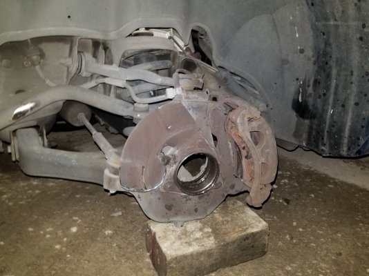

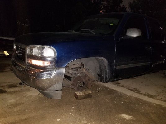

Here's the one from her truck, can't remember the exact mileage at that time but it was between 100-120K. We got the truck with 56K on it and it had the original cast aluminum 20" wheels. I replaced them almost right away with much lighter Centerline 20" forged aluminum wheels and they've been on there since. You can see some of the rollers had already given up, not surprising considering the lack of lube, and no seal against dirt or water intrusion. So this one is an extreme example. However, the ones on my truck failed near same mileage (wobbling) with no seal failure.
Example of some random truck in the impound lot, towed in from broken down on the road. Extreme case of bearing failure. Of course you can see in the pic he's running big, aftermarket heavy cast aluminum wheels.
