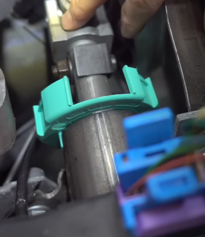

So, I was only able to find one video of it on a gmt800, but this is the sensor I see in the back of my lower bearing.

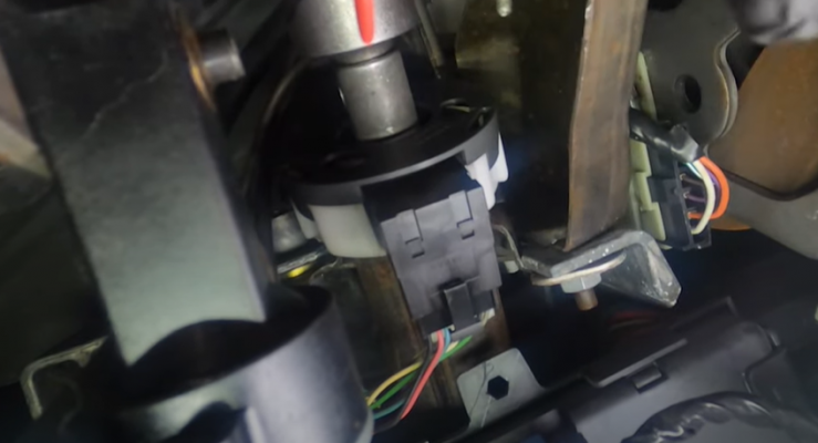

In all my other video-watching for how to swap that bearing, the sensor hasn't been there, here's it without the sensor from this video.
This is why I was surprised to see it on mine... and sort of confused what it's doing there?

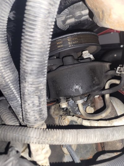

But, does one of the lines have a valve or switch in it? The way I understood the SAS explanation is that it is for the power steering valving for engine speed or steering stability control. Signs of that would be in the power steering system or on the dash.

Ok I maybe I missed it, but I followed the lines and I really don't see anything. I think if there were something, it would have to be hidden in the hydroboost unit or gearbox itself.

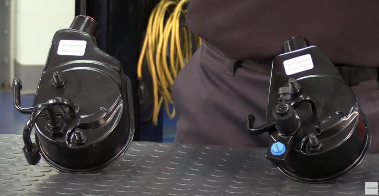

Hmm the difference in deleted vs EVO for 97-99 look like this supposedly, not that that would really matter for gmt800s / 2004.
