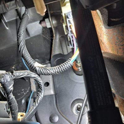

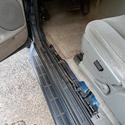

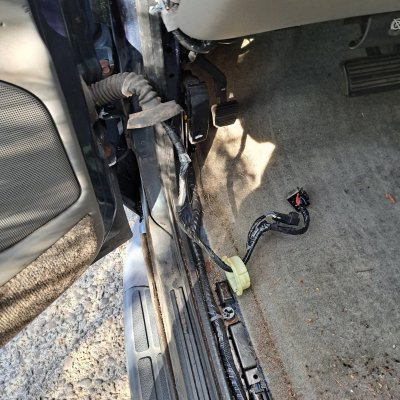

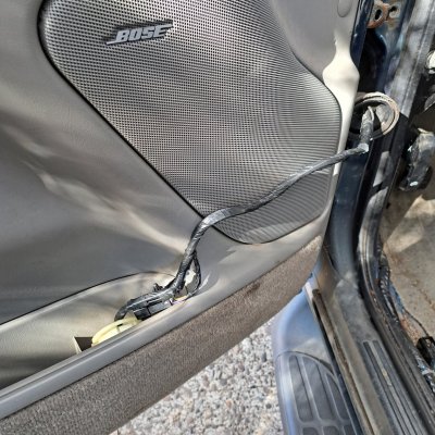

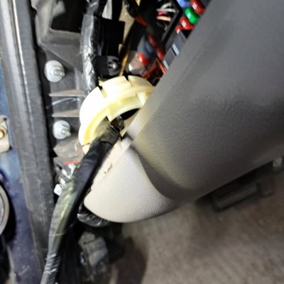

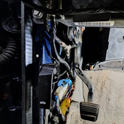

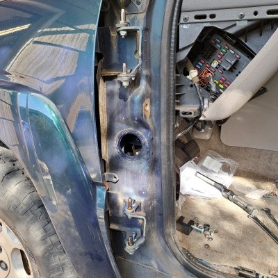

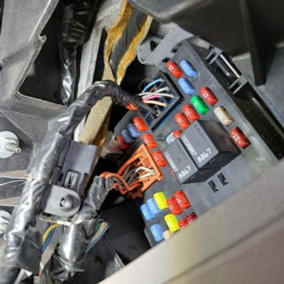

The 2005 Tahoe LS got dropped off at 3 today and then I took her home and came back and removed the door step sill, the kick panel cover and the side dash fuse cover. Located the ONE connector and harness that plugs in at the fuse box, right behind the cover, and then feeds down behind kick panel cover and then thru the hole where from the outside, the rubber boot/umbilical cord attaches. Disconnected and fed it all the way thru and then plugged back in for the night. I will remove hinge bolts and limiting strap bolt and lift the door straight up and off the hinge pins. Then I will be grinding off the swelled bottoms of the pins, 4 of them, use my special press tool to push the old pins out and then bolt in the new hinge pins and rehang the door and feed the wire harness back in and install the kick panel cover, step sill cover and the fuse box cover.
Be aware, if you tackle this job, it is a base LS vehicle. If you are working on an LS with more options, and LT or a Z71, you could have up to 3 harnesses that feed thru that umbilical cord rubber boot.

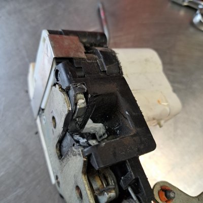

Then I will be doing the door lock actuator/latch assembly on the same door. These pics are all I did when I got back from dropping her off and spent about 30 minutes on where I am at now. You should notice the harness connector is plugged back in till in the morning.

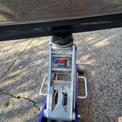

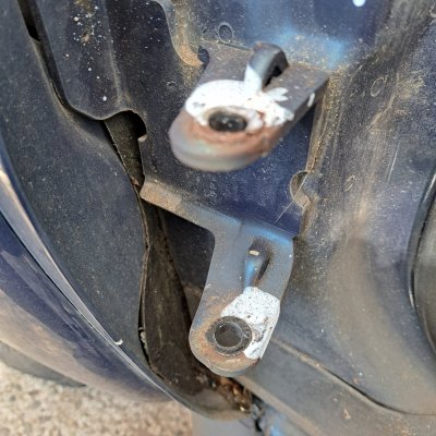

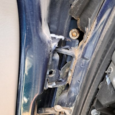

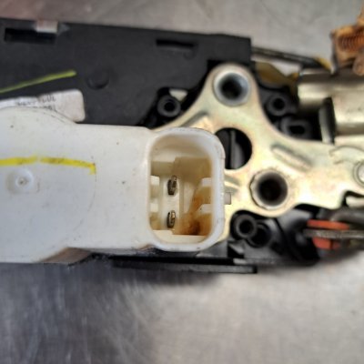

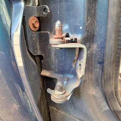

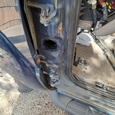

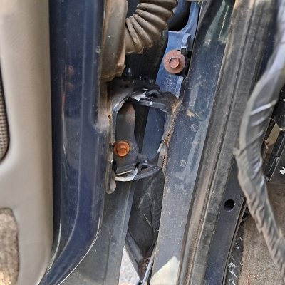

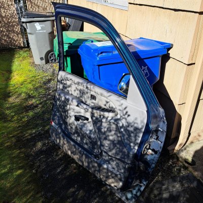

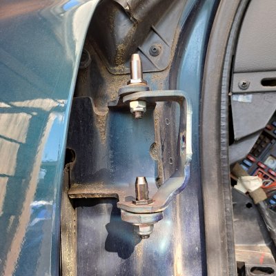

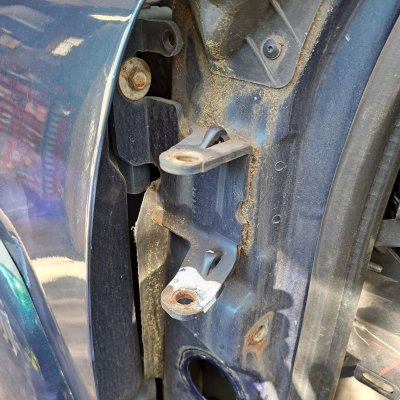

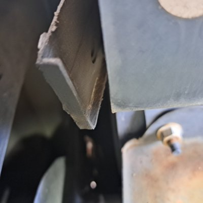

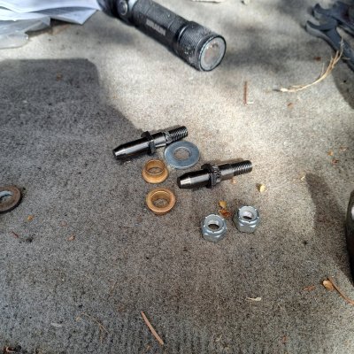

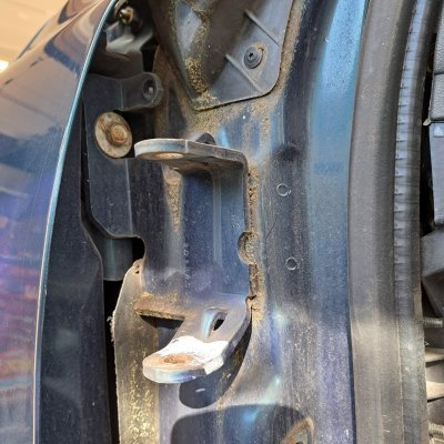

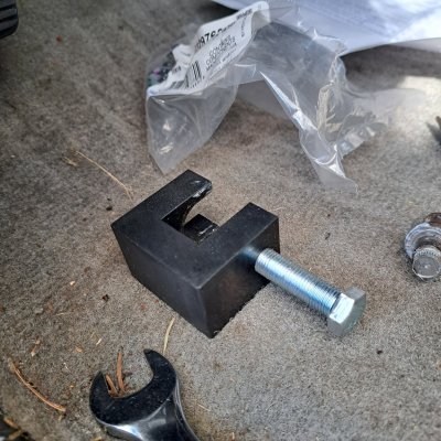

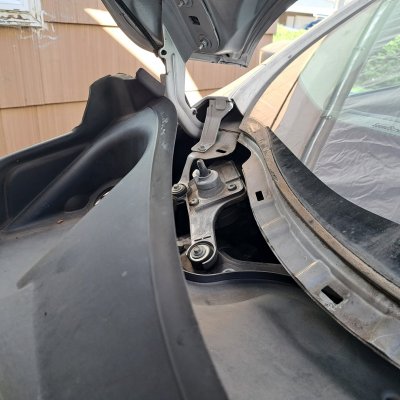

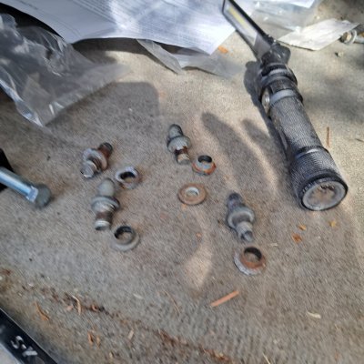

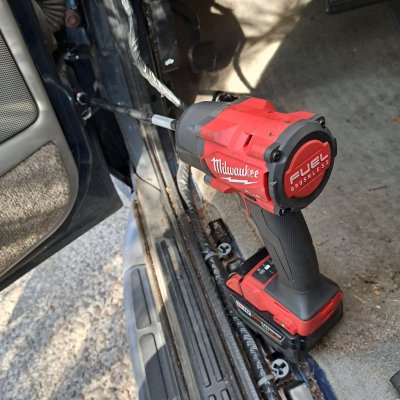

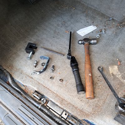

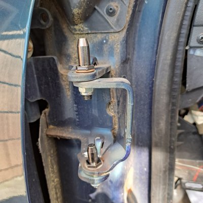

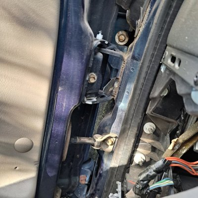

Well today was just fun fun fun. Unbolted the drivers door from the hinges and then, with the help of my neighbor, lifted the door straight up and off the pins. Used my floor jack to lift it, using a special cup that is designed for pinch weld lifting. Cut the bottoms off of the 4 pins and used my special push tool to remove the old pins. Bolted in the new pins and set the door back on and all went well.

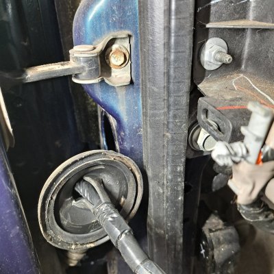

Moved on to the door lock actuator and that went pretty smooth except for water coming out of it. See the red water at the pin connector area. Found leaking water at the glass wipe seal. Repositioned that and fixed that.

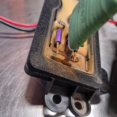

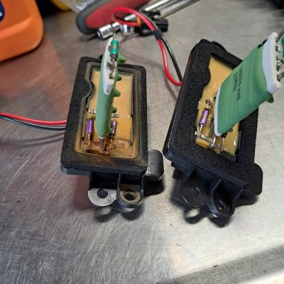

Then went to the blower and resistor and found one of the attaching screws for the resistor was rusted and when dropped the resistor, found it rusted badly. Blower was dry.
Gonna remove cowling tomorrow and locate source of leak.

Curious, which door seal was out of whack that let water get into the connector?
The glass wipe seal on the outside, for some reason had a chunk missing at the back, just above the actuator. I was able to grab and stretch back to cover the gap. She knows, because I told her, it needs replaced asap. I am slowly but surely getting repairs and maintenance caught up. She is not good about it and I have to jump her about it.

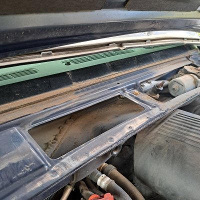

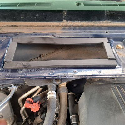

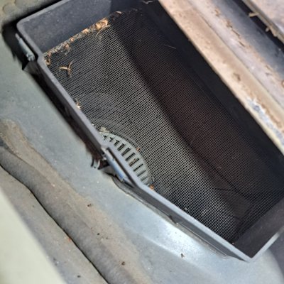

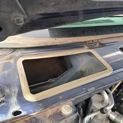

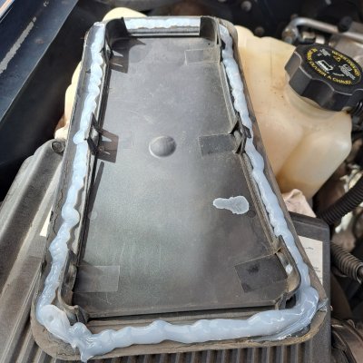

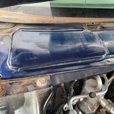

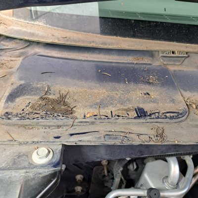

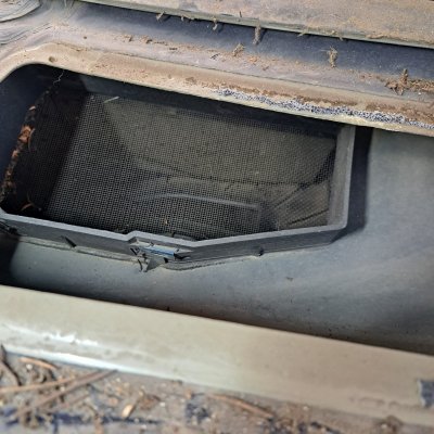

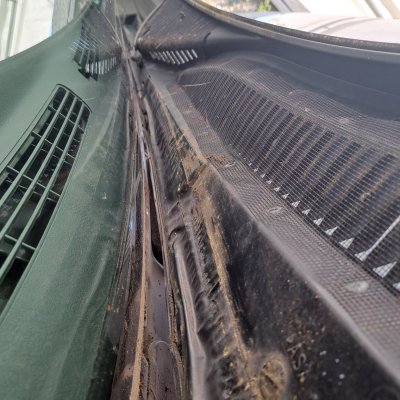

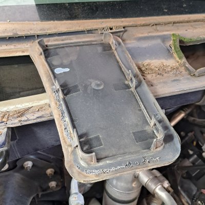

Gonna be a thorough inspection for water leak source above the blower/resistor area. When the wiper arms and cowling cover is removed that exposes a cover that is over a rectangular screened area that feeds ventilation down in to the area above the blower and resistor area. Where that vent mounts, the seal around there deteriorates over time and the cover also breaks down and there is a soft foam seal where it sets on top of the vent hole. There is also another soft foam seal that is exposed, more to the center area, when the cowling is lifted off. At each end of the tunnel under there, where the wiper motor is located, there is a rubber flap that also gets clogged up on the inside and backs up water that should drain out of there. You do not have to remove cowling to access these. It is literally just a rubber flap. Look deep and you can see and reach to them. Pull them back and reach in with a finger and check for debris.
2,646
4,847

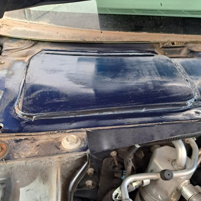

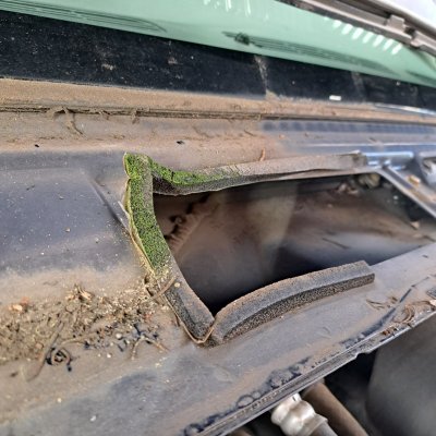

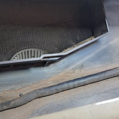

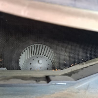

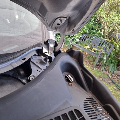

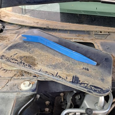

Ok, back at the 2005 Tahoe today. Removed wiper arms and the upper cowl cover. Found the p/s inner most vent hole foam seal was crap. The outer cover, when pried off, seal was crap. The screen cover below it had the spongy foam seal and was wet. You can see the blower motor wheel in pic. Cleaned it all completely. The outer perimeter of the outer vent with the cover, got a good cleaning and sealed with fresh silicone sealant around the whole perimeter. The cover was completely cleaned and sealed and when I pushed it back in place, the extra sealer oozed out and sealed smoothly around the outer perimeter. The inner most vent hole was cleaned and new foam seal installed. The bottom of the cowling cover was completely cleaned so that it would lay against that foam seal. Reinstalled everything. Waited 1 hour for sealer to set up. Pulled the blower resistor. Ran the water hose for 20 minutes and watched and felt for water back at the resistor mount hole. Felt dry and saw no water drips. Almost forgot, did check the ends of the lower rails and there was no blockage. You can see one, in the first pic is torn on the p/s.

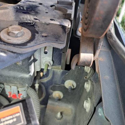

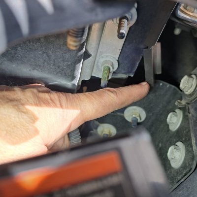

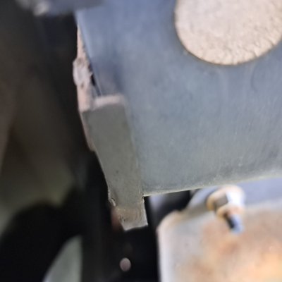

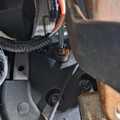

On the same Tahoe, it has hydro-boost brakes and when on a rough enough road or over bumps, there is a rattle noise under the dash on d/s and sounds close to the firewall. I checked and is not the lower collar bearing on the steering column and not the attaching shaft at bottom of column. Did find a lot of play at the upper brake pedal pivot. Has a large horizontal bolt with a threaded nut. Cannot seem to see or feel the other side of it to see if the bolt head is there. I was tired and did not spend a bunch of time digging. Also has P/S fluid seepage at back of hydro-boost at the firewall. See pics of seepage and threaded bolt. Bolt is at top of the pic. Anyone ran in to this before and know anything about tightening the bolt? Is there a bolt head or is it captured? Thanks in advance.

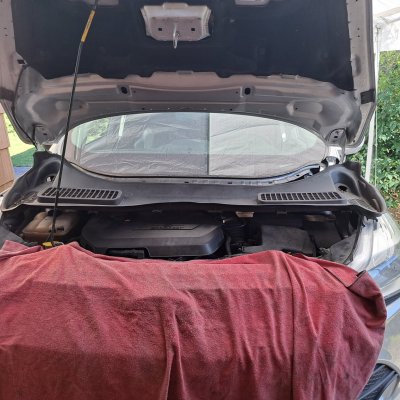

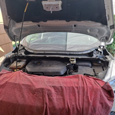

Then I had a customer from previous work, call me out of the blue and asked if I could install his new battery. He said other shops were putting him off for at least a week. It is a 2015 Ford Escape SLE AWD with the 1.6 turbo. I found a coolant leak that 3 other shops could not find, about 1.5 years ago. Done a couple oil changes and Reinstalled a rubbed off fuel tank cover for him as well.
Took 30 minutes to install battery. Remove wiper arms, remove upper and lower cowlings and dig out of the box it is in, in front of driver close to the firewall. Then I reset his oil change reminder light and asked why? He said he had the oil changed and realized that he slipped up. I saw a new sticker and he did not call me for the oil change and the shop did not do the reminder light reset.
I told him $40 for the battery install and he paid me $50 instead and begged forgiveness for not calling me about the oil change.
