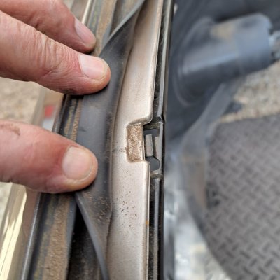

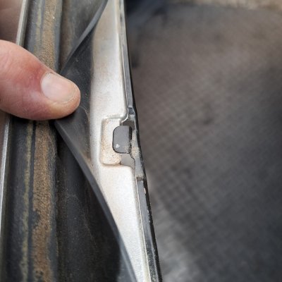

Ok, back at the 2005 Tahoe today. Removed wiper arms and the upper cowl cover. Found the p/s inner most vent hole foam seal was crap. The outer cover, when pried off, seal was crap. The screen cover below it had the spongy foam seal and was wet. You can see the blower motor wheel in pic. Cleaned it all completely. The outer perimeter of the outer vent with the cover, got a good cleaning and sealed with fresh silicone sealant around the whole perimeter. The cover was completely cleaned and sealed and when I pushed it back in place, the extra sealer oozed out and sealed smoothly around the outer perimeter. The inner most vent hole was cleaned and new foam seal installed. The bottom of the cowling cover was completely cleaned so that it would lay against that foam seal. Reinstalled everything. Waited 1 hour for sealer to set up. Pulled the blower resistor. Ran the water hose for 20 minutes and watched and felt for water back at the resistor mount hole. Felt dry and saw no water drips. Almost forgot, did check the ends of the lower rails and there was no blockage. You can see one, in the first pic is torn on the p/s.
View attachment 2189View attachment 2190View attachment 2191View attachment 2192View attachment 2193View attachment 2194View attachment 2195
Those flaps at the ends of the cowl, pretty sure those are torn off on both 06's, the one we still have and the one I sold. Found the loose ends of them down in the fenders IIRC. Rotted rubber, weighted, presumably to provide a little holding power for it to stay shut. Figured they had something to do with cowl venting but didn't find where they used to live.

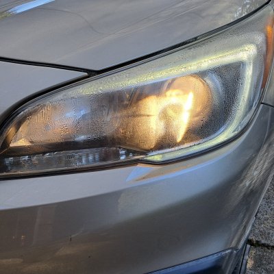

Tomorrow, replacing both headlamp assemblies on an American Legion friend of mine, wife's 2017 Subaru Outback 2.5i Premier. Assemblies arrived this morning and will do work starting at 11 tomorrow.

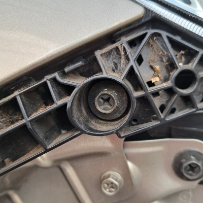

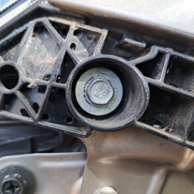

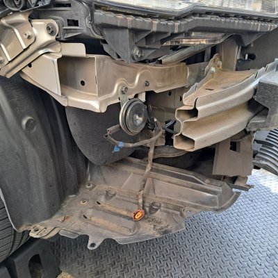

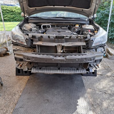

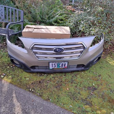

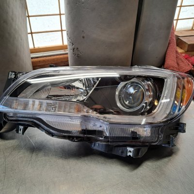

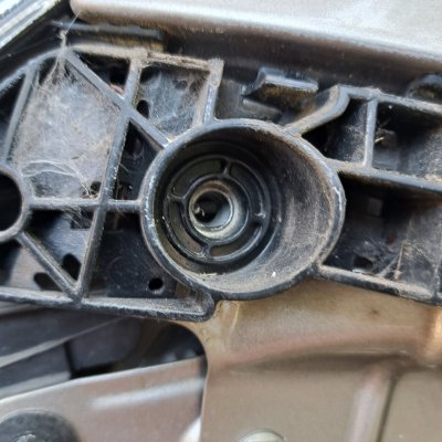

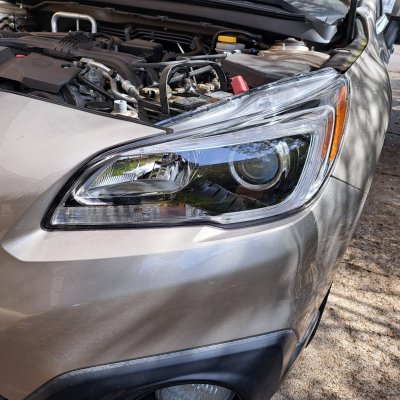

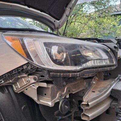

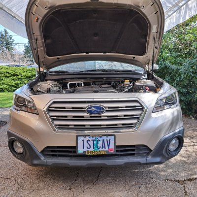

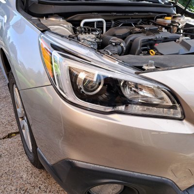

Replaced both headlamp assemblies on this 2017 Outback. Involved complete front bumper facia removal, detach fog lights, remove brackets that the facia clips press in to so that they snap out and back in to place, found that someone had to be in there before because one of the bracket bolts were missing. Found a replacement bolt and installed. The rest of the attaching bolts are black and my replacement bolt is grey. Also found that an attaching bracket across the top had not been reinstalled as should have been. You can see where there was no shadow of where the bracket tabs should have been and where I realigned and set tabs as should have been. Some sloppy previous work. All that is required to remove the bumper facia is clips removal. Rest of work went as planned, see pics: Some pics are out of order but you will figure it out.20250309_104309.jpg20250309_104337.jpg20250309_104342.jpg20250309_110552.jpg20250309_112436.jpg

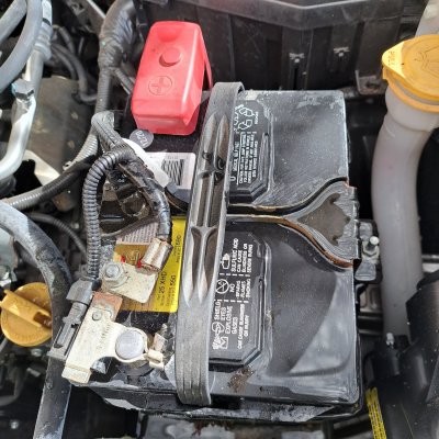

The manager at my taco place I go to on Tuesday and Thursday, told me her mother's 03 Camry SE 3.0 would not idle right and would die in gear at idle intermittently. I went to check for CEL and there was none but I could duplicate her concerns. I opened the hood and saw the problem immediately. A brand new battery just installed about a week ago. She hardly ever drives the car. I changed the scanner to live data and the short trims were way negative and showed no readings at all on long trims. I knew it was gonna need a reset on the ECU. I got the engine completely warmed up, set the park brake and put my foot on the brake and put it in drive and sat there for about 6 minutes. At first the rpm's were below 400 and acted like wanted to die and tach needle was floating a little. Then it started to climb and settled at close to 700 rpm. After 6 minutes I took it on a 40 mile round trip. The fuel trims went to spot on and the rpm's were between 680 and 700, stopped in gear at lights. I parked it and handed the keys to the mom. I will be getting free tacos for several days now.
