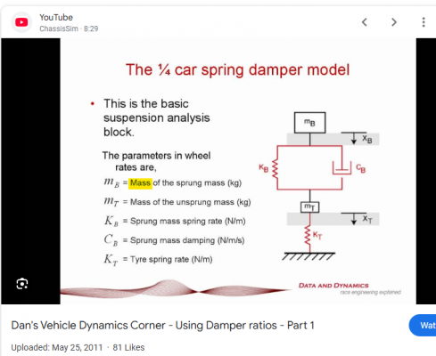

And regardless, you can't compare a lighter vehicle with the same torsion bars as a heavier vehicle because they don't weigh the same: damping factors are unequal.
And the rear suspension stiffness won't be the same either (coil spring vs leaf springs, even with stiffer coil springs,) so there's that. I think even different wheelbase lengths may have an effect on ride quality...So it's not an apples-to-oranges comparison.

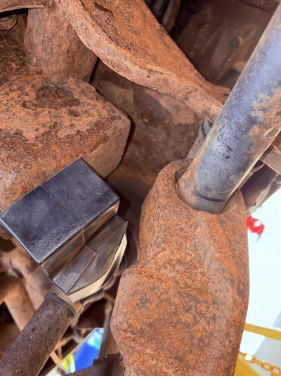

Looks like a jounce bumper for an H2 or for 2500s & 3500s ... ?
This is a black version of that one (kryptonite) on a 2500HD
The squish is probabyl because I did not yet replace shock absorbers, since doing so the shape has 80% returned to proper
if your front suspension matches this yes you can use it, but to my knowledge you cant because i assume yours is like the 1500 which is im pretty sure different
The squish is probably because I did not yet replace shock absorbers, since doing so the shape has 80% returned to proper
Kryptonite sells these? One of the few companies that seems to have a reputation superior to GM OE. If so I'll get it from them.
i dont see any listed under 1500 or suv section
they are not the same im 99% sure so you probably cant use them without making a bracket of some kind
these are designed to always contact the suspension when at rest
