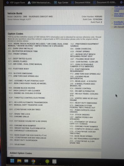

Here’s my Silverado rpo list for HD 2500 wt with good load options, I think it may be diff for suburban but it shows what each value means to gm ...
GK torsion bars, FT keys. That definitely helps.
Y'know what does NOT help? RPO YD6 is far too common across the entire GMT800 family; it says nothing if EVERY GMT800 has YD6!
GMT821s/Tahoes & GMT831s/Suburbans 1500 use the same rear coils, right?
What about the GMT805/Chevy Avalanche 1500? Do they also use rear coils?
