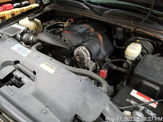

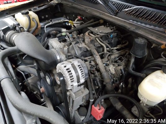

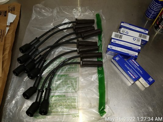

05-16-2022 Spark plugs and wires for the Redneckinator. 8 wires. 7 plugs. Guess at least one Amazon worker knew how to count when packing loose items that day.
The two-day tune-up completed, thanks to 8th plug showing up a day late

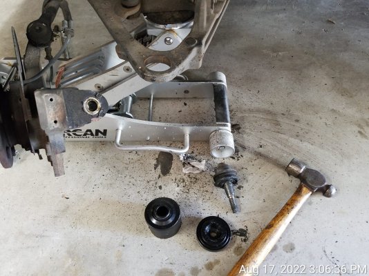

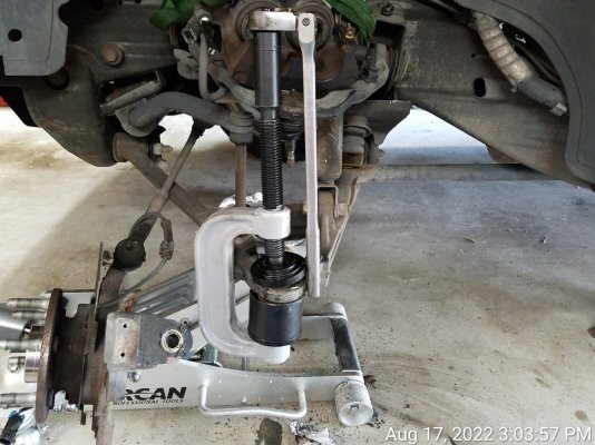

08-17-2022 New lesson learned: just because a tool maker says their tool fits your truck, doesn't make them correct. Or possibly, I may just be a dummy and using the tool wrong. I may need to use it "backwards"..

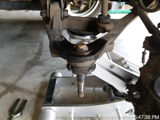

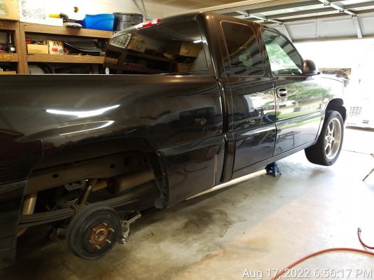

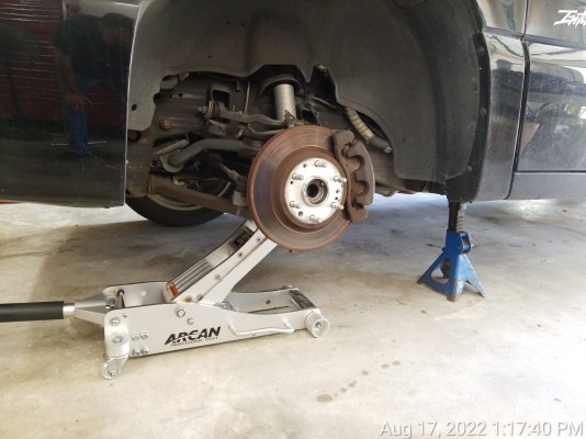

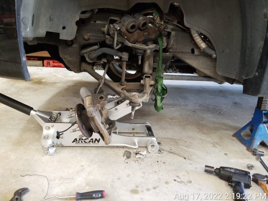

Lower ball joints on the Redneckinator. Jeezus H effin Christ on 3 crutches. You can't get the knuckle out of the lower ball joint without the upper being loose, too. Massive beating with hammers and fork to get it loose. Lower joint attaches under control arm, can't really use spring tension to pop it. Lesson learned: do uppers and lowers together, which I will on Amy's truck next.
Knocked the grease fitting and the dimpled ridges around the old joint off with a chisel, got the thing to break loose
Trusty old ball peen to the rescue
FML the other side refuses to let go
Wrapping it up. New joints installed and greased, and throwing a front/rear tire rotation in while I'm at it. I'm beat

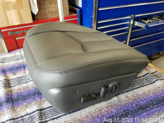

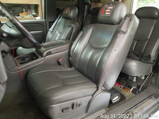

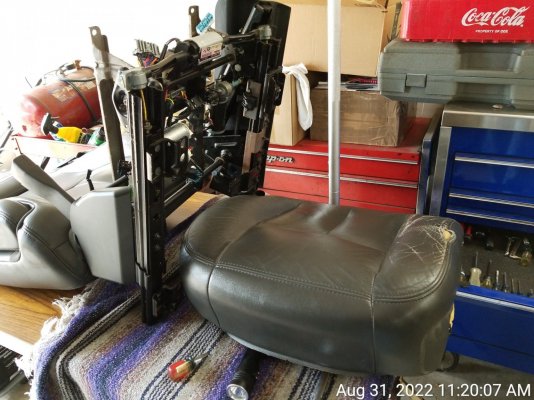

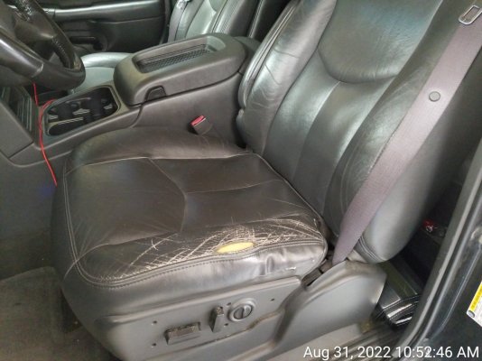

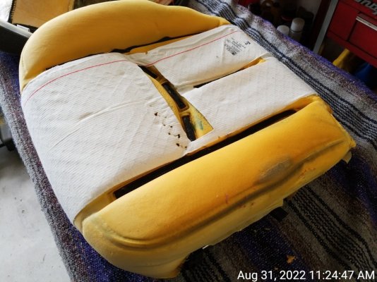

08-31-2022 Little job for today, replace the seat bottom leather on the Redneckinator SS. Wasn't too bad but I learned a few lessons, so I get to re-do it again in the near future. Foam felt OK but once I got the old cover off, I could see it's starting to crumble at the edge. Heating element has burnt spots so it needs to be replaced. Truck is my daily driver so I went ahead and put the new leather on and will have to order more goodies to do it "right" the second time around. About 1.5 hrs from door open to door closed, including a little vacuuming. Oh, and some fighting with the cover to get the middle stitch lined up with the top part of the seat, still getting it wrong, then realizing the factory did a crummy job, too. ;)

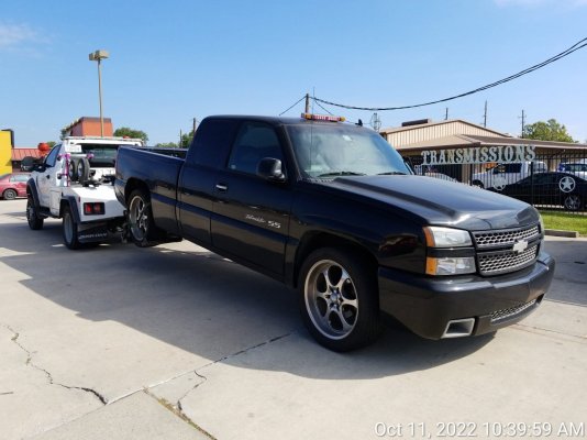

10-11-2022 F M L

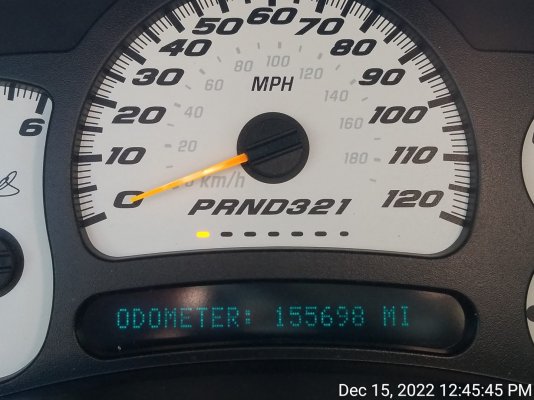

12-15-2022 After an extended stay at the transmission doctor, the Redneckinator is back in action. We'll see. 155K for the record and 3rd transmission. Next time it just may get a swap.. or sold first!

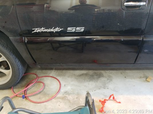

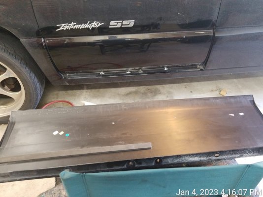

01-04-2023 Today's fun: after getting the bluetooth receiver/aux input gizmo working in the 300 again, attention turned to the Redneckinator. Tried repairing the cluster dimmer switch one more time before replacing it, and also hope cleaning the contacts on the radio faceplate helps the display not conk out randomly.

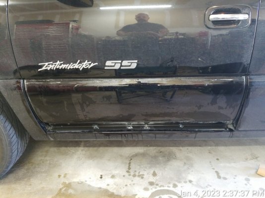

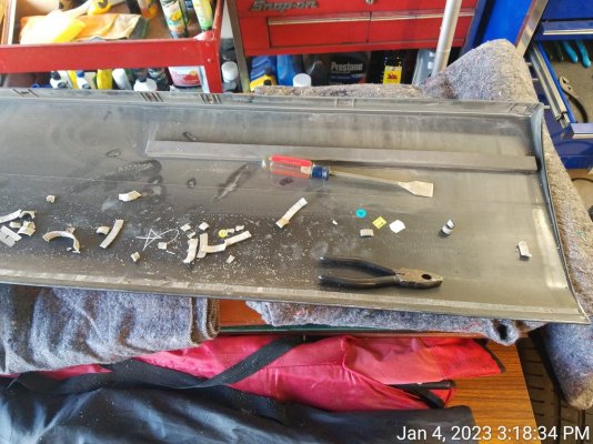

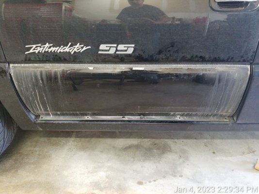

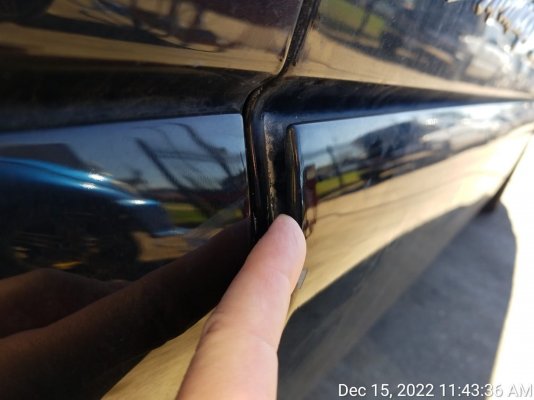

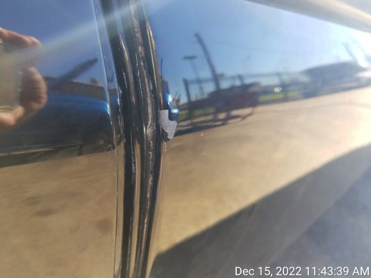

Then.. dealing with this crap I've just been sick about. While the truck was at the transmission shop, the body tape let go at the front of the door molding and the guys chipped the paint. Required me pulling the fasteners at the bottom bracket, break the rest of the tape loose, clean all the old tape and residue off, prep spray everything, and apply new tape then reinstall the molding. All is well now, except that glaring chip in the paint :(
