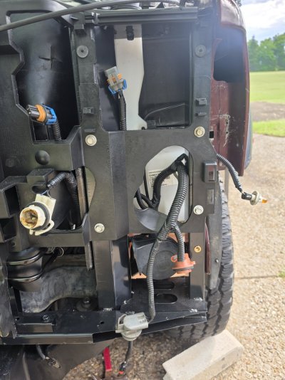

Here is my blinker area. I have 3 large sockets. Not sure why I have 3 considering the blinker assembly only takes two. A white Grey and brown one. Anyone have a clue?

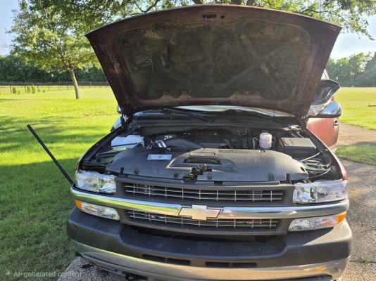

Next stop is the tuner. Got the outside back together. Will fill fluids tomorrow.
Grille and bumper is pretty busted and will be replaced at some point. The interior is ripped apart, but that can wait until after tuning.
Still didn't find an answer to the small plug next the bottom of the radiator on passenger side.

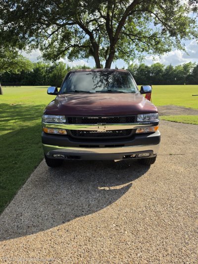

Decided to buy a new bumper cap and lower valance for the bumper. The bumper has some small dents and dings but it still looks nice. After taking it apart, i grabbed a can of never dull to brighten it up. I rubbed it down and then went back over it with aluminum foil, then back over it with never-dull and wiped it with a lint free rag. Looks brand new now.
I also have a grille on order since mine is a bit beat up. After ordering it, I realized mine is actually from a silverado 1500 or a tahoe or something. Its definitely not a 2500 grille. Funny that I never noticed. It actually doesnt look terrible.

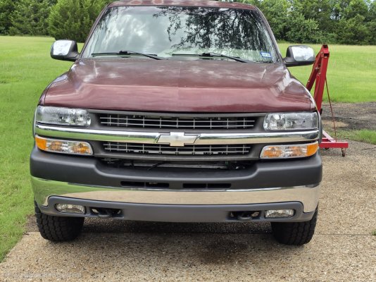

Got the HD grilled installed. I guess the bowtie emblem is ridiculously hard to find unless you buy a blacked out or plain billet one. I think the other grille grew on me because the inserts are metal and you can see it thru the grille. But ill roll with this for a bit.
I also installed two kill switches. One for the ignition coils and one for the fuel pump relay. Eventually ill install an auto start with an alarm so I can change the front door handles to the rear crew cab handles to get rid of the locks. Just being proactive to even I eventually make this truck more of a looker.

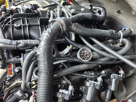

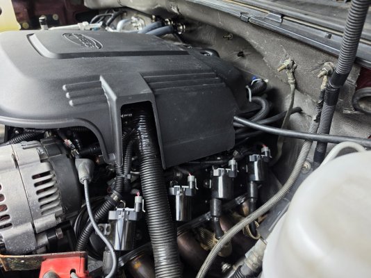

When Start the truck up it kind of sputters and takes a second for it idle out. I assumed it was that the fuel rail is losing pressure or not enough but the TBSS fuel rail has no Schrader valve to verify. So i decided to go on the internet for a solution so I can verify my fuel pressure.
I found a QD adapter where you can screw in a pressure sensor or a gauge. I went with the fuel pressure gauge so I can verify pressure before turning the key on. I pieced it together with some Loctite 565 and let it set overnight to cure. I put the contraption on the output of the C5 fuel pressure regulator before the C5 fuel feed hose that leads to the fuel rail. It fits cleanly under the intake manifold cover. So far it doesnt appear im losing pressure at the rails.
Link to Gauge
Link to QD adapter
