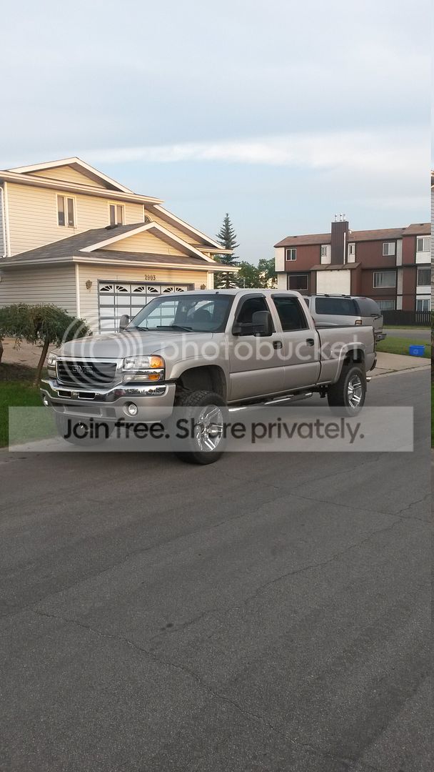

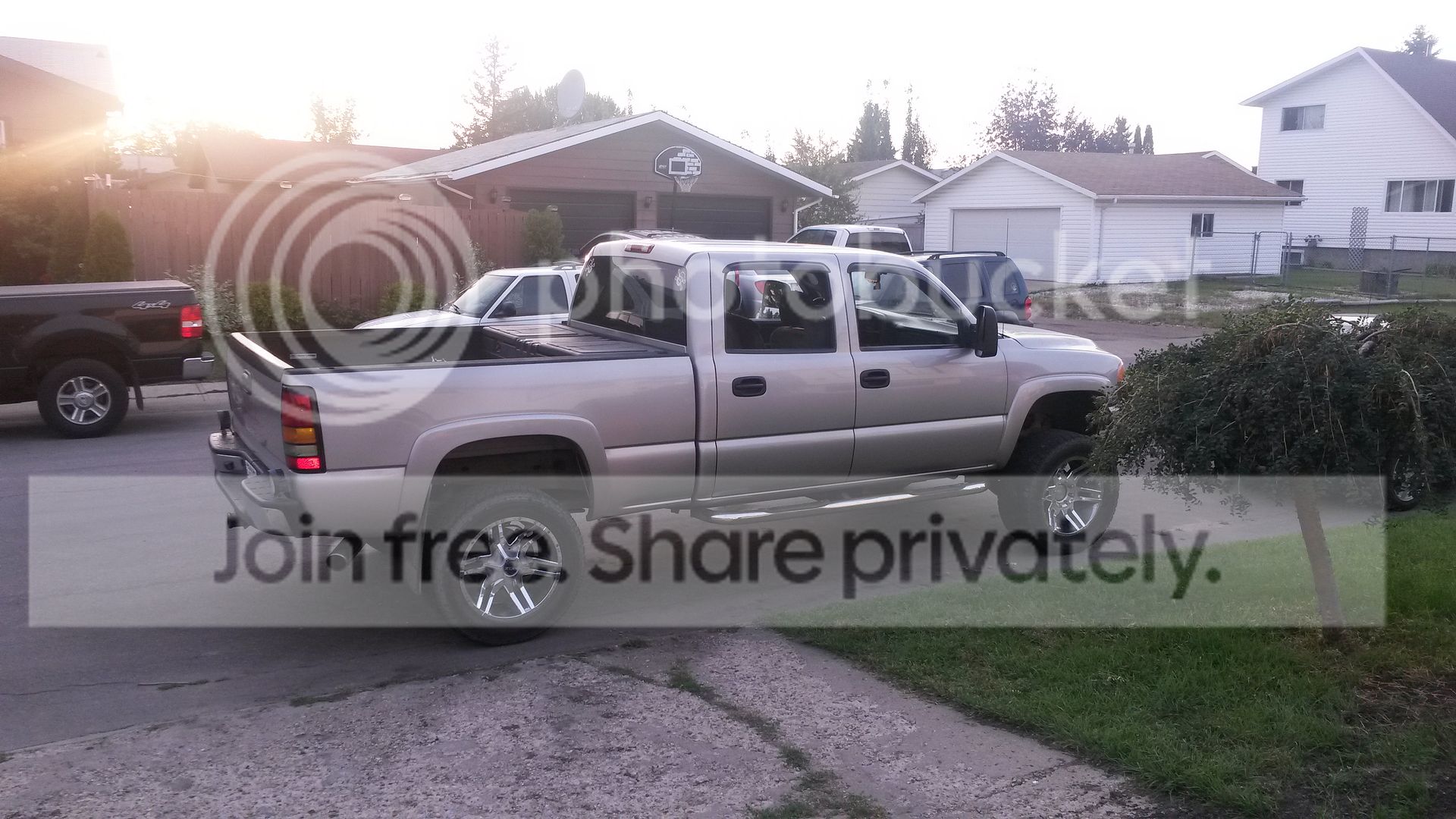

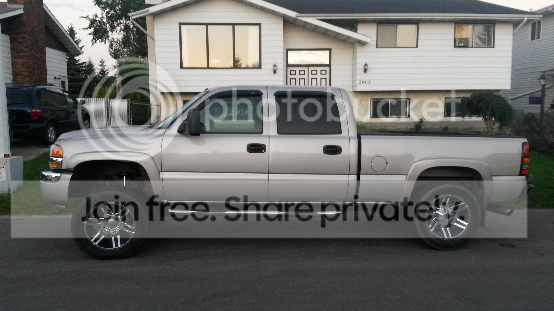

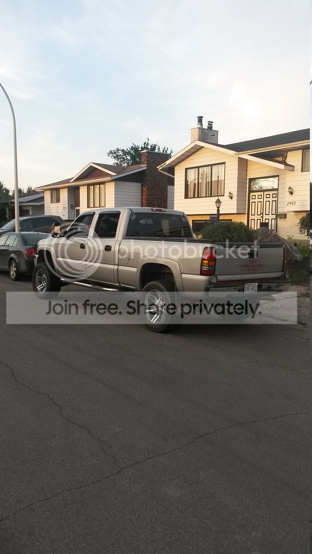

Yes front is higher right now. I have not installed any blocks in the rear. I still have the one inch block in the rear that I had before. Lift is rough country 6" with stock keys and no crank. The lift came with 4" blocks for the rear. I need to measure to find out how much I want to go up in the back.
I'd put the rear blocks in, it'll make it sit level and you can choose to leave the keys where they are or crank up, give a little more clearance, looks like a Cali lean at the moment
Sent from Team Sierra
Measuring the ground to fender on front and back probably see a difference of about 3 inches, usually the back is an inch or inch and a half higher
Erki
May 3, 2014
220
19
Alberta, Canada
Yep your all correct. I measured it tonight. 43" in front and 40" in back. Taking out the one inch block and putting in the 4" should put it right level. Probably wait until after this weekend so I don't have to rush and lift the trailer for camping. Just sporting a 3" cali lean or is it Carolina squat at this point. Haha.
