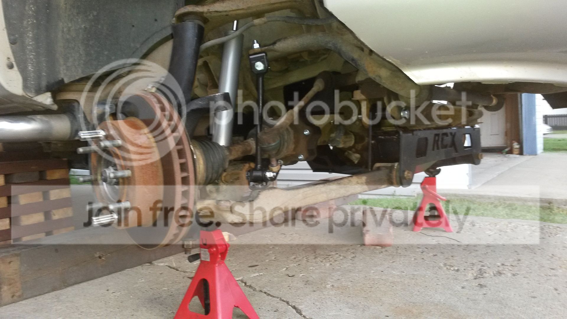

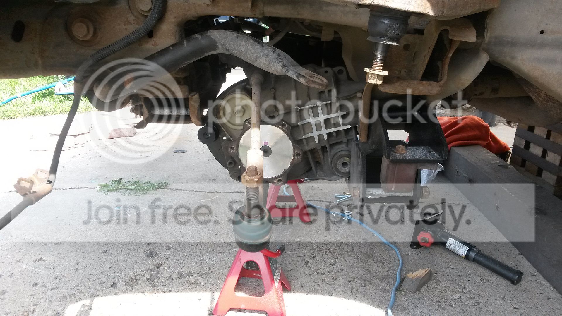

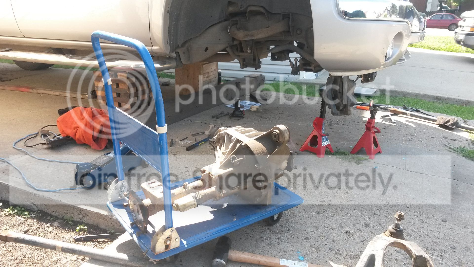

Put in about 11 hours today. The front is so close I can taste it. But I need a 9/16 drill bit to bore out the bottom of the tie Rod hole on the nuckle. That's about it. Other than loading up the torsion Bars and putting the wheels back on.
About noon. It was time to do some cutting,grinding, and puttin stuff back together.

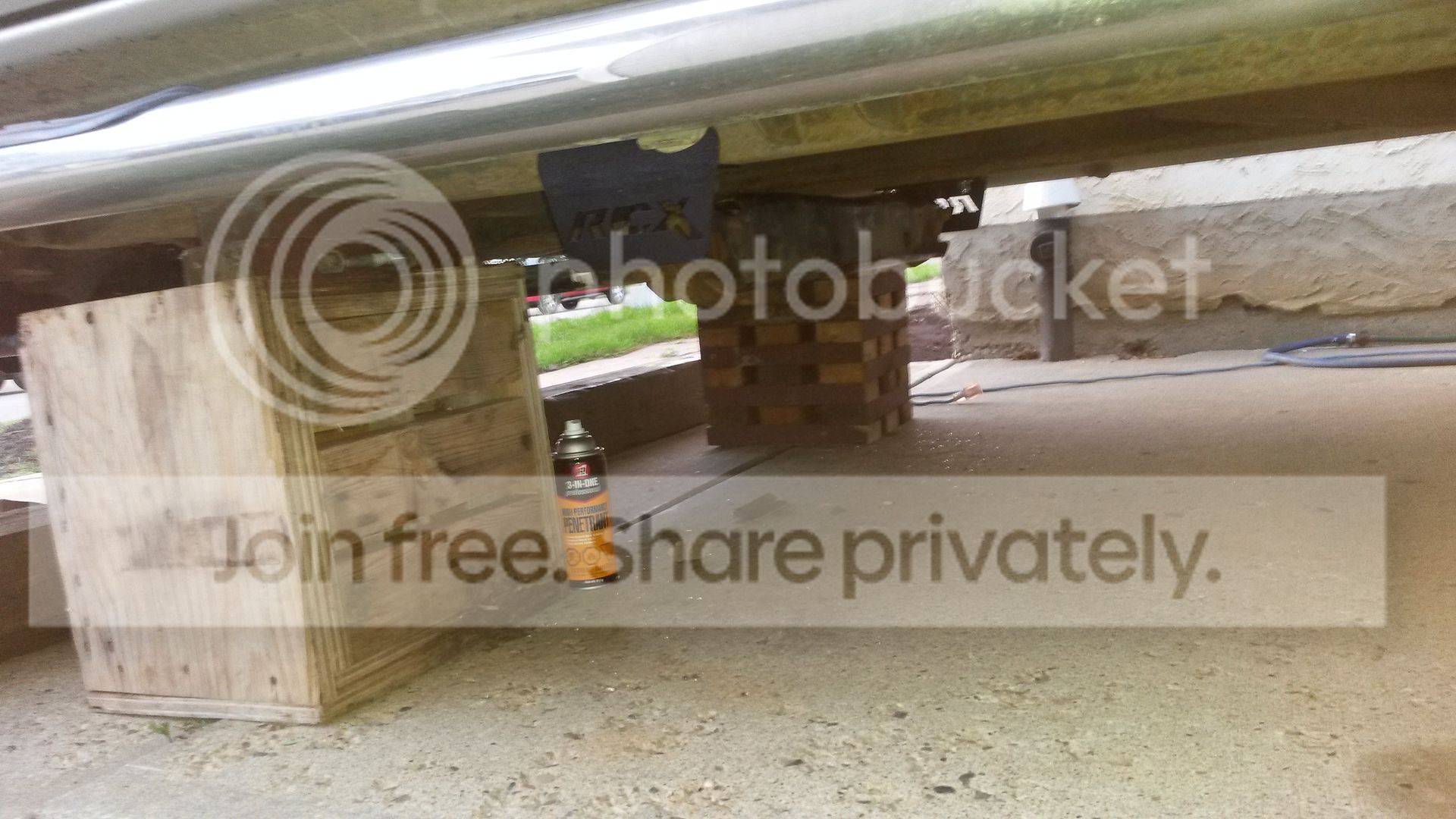

The fin grinding with trial fitments.

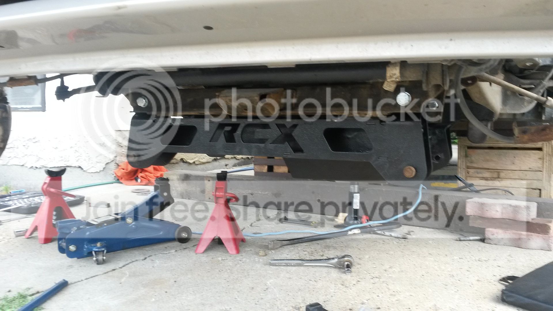

Starting to look better.
Got some help again.
Where I left it for the night.
