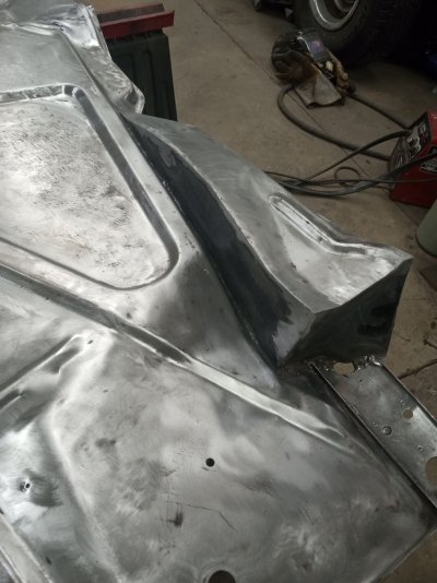

Since this dent is shown in pictures here, I should tell the story. Otherwise everyone will wonder why we didn't pull it. First picture is no dent, second picture shows the dent.
I used four ratchet straps and hooks in the ceiling to remove the cab from the frame once. My thought was, that I could release one strap at a time slowly and set it on the ground. That was a very stupid thought! When I pulled as hard as I could on the tail and released the strap, the cab became a battering ram as it smashed through me and some bins on the wall and hit the ground. That's not to bad of a dent for the fall, so me or the other three straps (which unhooked somehow in all the violence) absorbed enough energy. Since its not seen, and serves as a reminder to not be stupid, we left the dent.

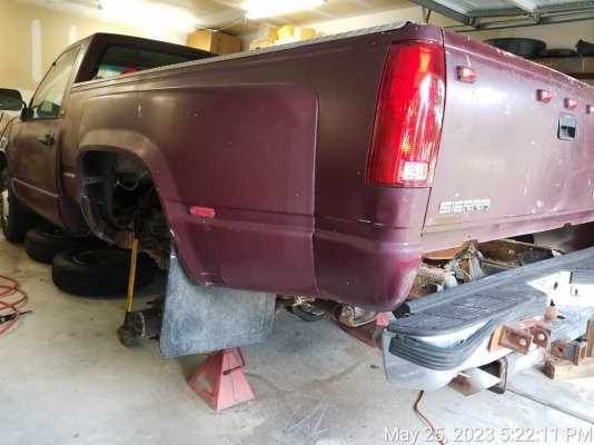

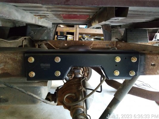

Now where have I seen that wheel chock method used before? ;) Gave me just enough room using 4 of them to prop the bed up on Critter so I could chop out the homemade gooseneck mount and cut the frame for the C-notch. Y'all should've seen me using a combination of scissor jack, and floor jack with a piece of 4x4 lengthwise to jack the bed up to get the chocks under there. Sketchy is a good descriptor.

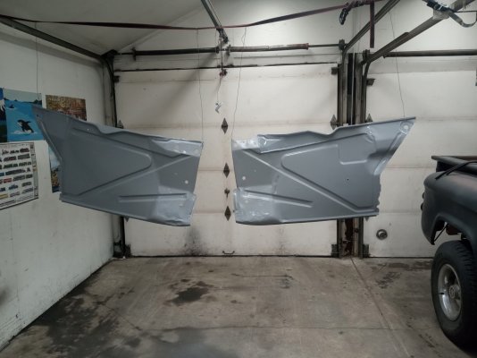

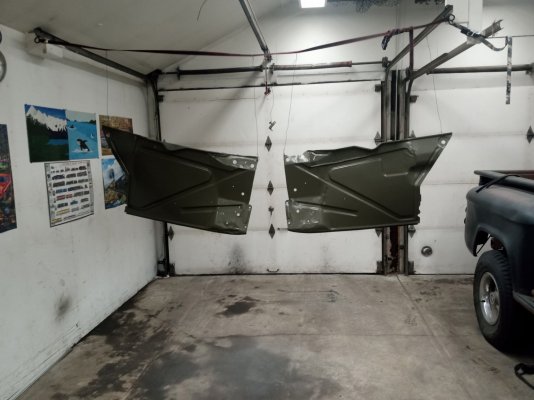

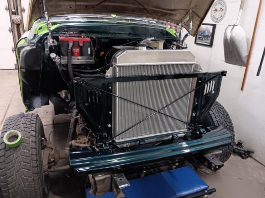

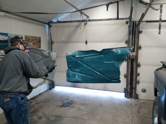

No worries of overspray with the truck next to it?
Yes, its a problem! We have a cover coming for the truck, but from previous over spray the plan is to sand and clear coat the painted parts of the truck again. Kind of a lessons learned item, we hope to do better going forward. We didn't realize how far the spray would travel.

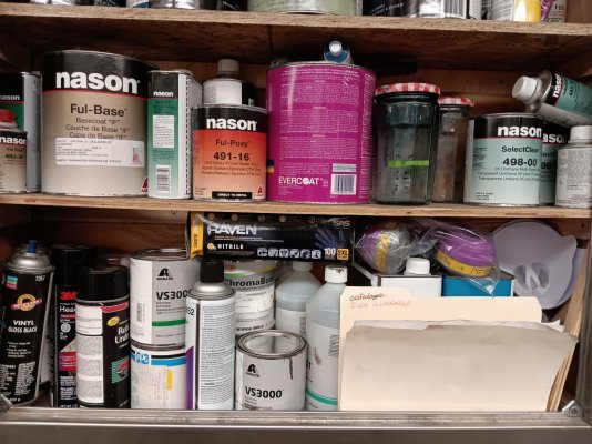

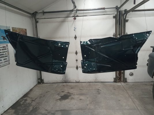

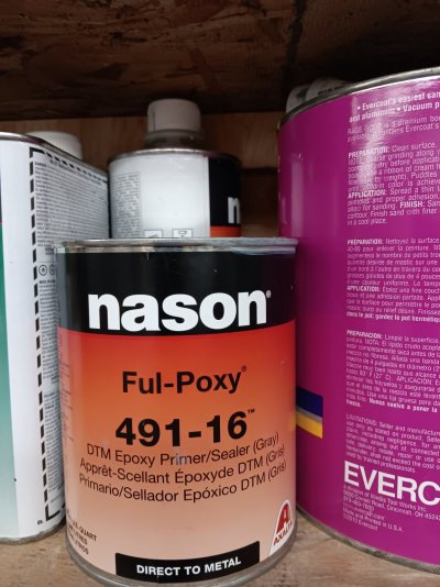

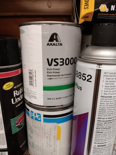

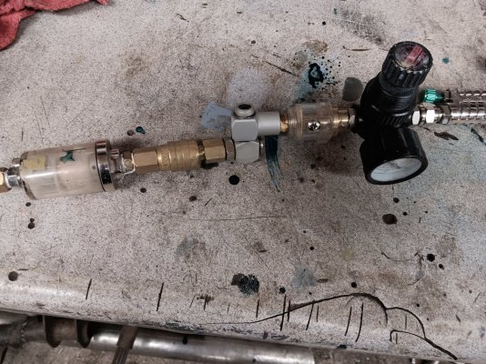

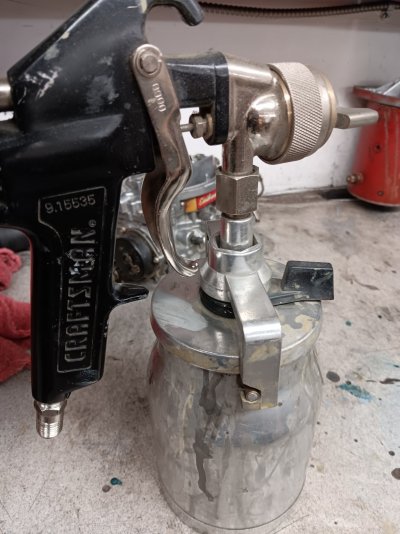

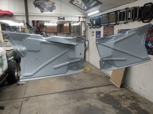

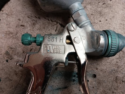

I was reminded today that I should show what we are using to paint. For primer we are spraying with this old Craftsman at around 24 psi. We are currently using the Axalta VS3000 primer. We heat the garage to around 75ish and open the door a bit to vent. We dont spray steady as I watch the fog as my boys sprays, I stop him and let the garage vent, and them tell him when he can start again. Might sound dangerous to some, but I have had a lot of training in explosive environments and play it really safe.

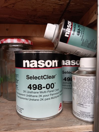

We have found that it takes half the sealer as primer and a little more base coat than primer, then we mix the same amount of clear coat as sealer. Here is what we are using for base coat and clear coat. All four stages we follow the directions for mixing, pot times, and re-coat times.

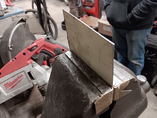

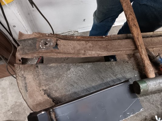

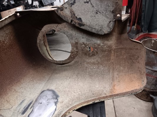

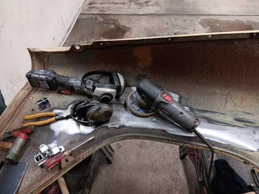

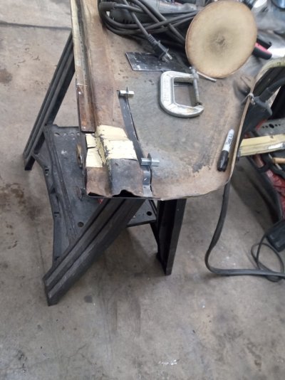

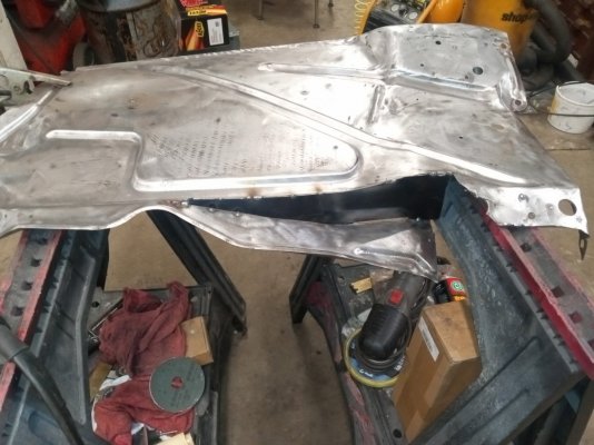

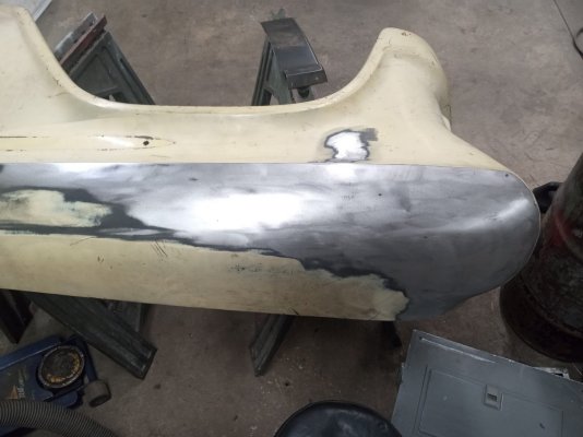

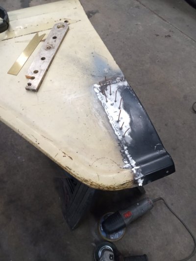

Building a patch. We cut a piece of old steel out of a junk fender. Then we shape it into what we want and weld it up. I will post final pics when its done. 20250213_200106.jpg
