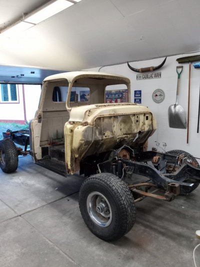

This tuck was my sisters dream truck and she had it in her shop collecting parts to build it. However, she died of cancer in 2012 and never started it due to being sick, and well, fighting for her life. At first it became my oldest daughters truck and her and I started on it, but she didn't really like it or working on vehicles that much. IMG_7777.JPGIMG_7790.JPGIMG_7918.JPGIMG_0511.JPG

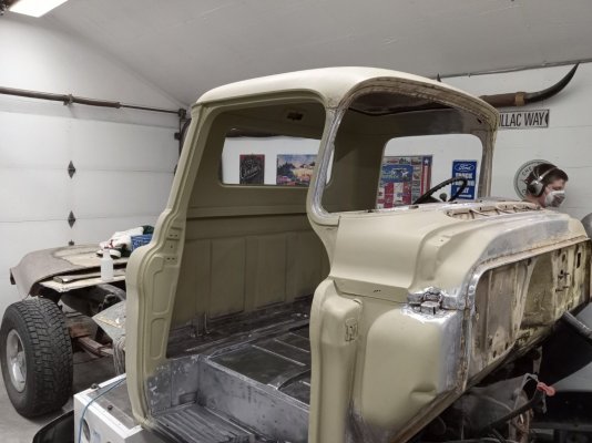

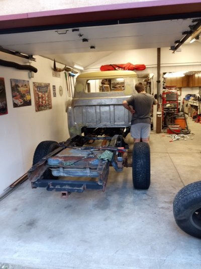

Fast forward a few years, two of her younger siblings and their vehicle projects, and my third son wants to build the 55. This kid jumps in with both feet and learns everything he can, works on it every chance he can, gets a job to pay for parts and material. I know its getting built this time!IMG_20220726_194804497_HDR.jpgIMG_20220815_193823626.jpgIMG_20220815_193927301.jpgIMG_20221122_112849429.jpg

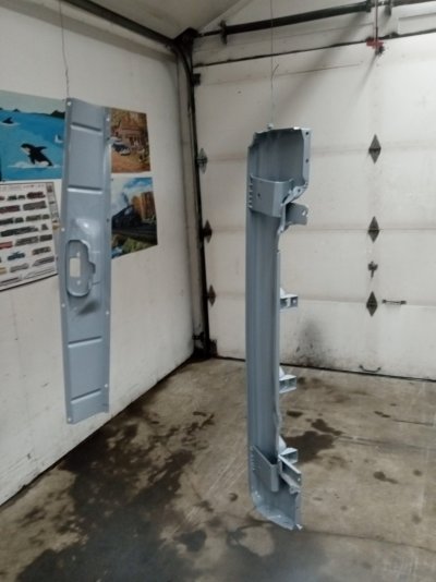

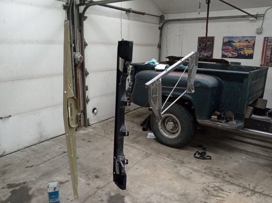

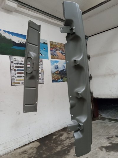

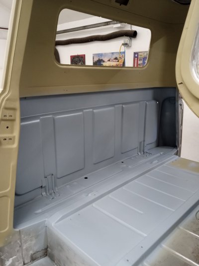

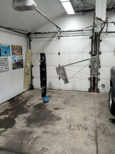

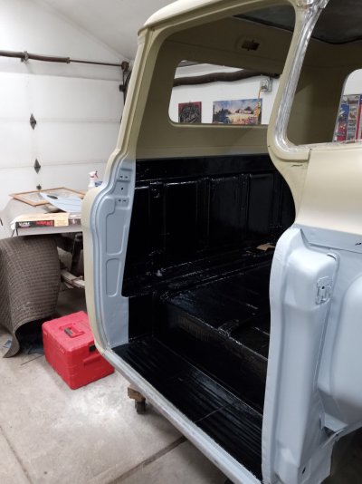

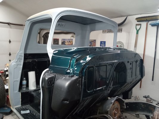

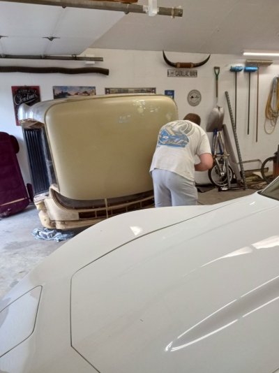

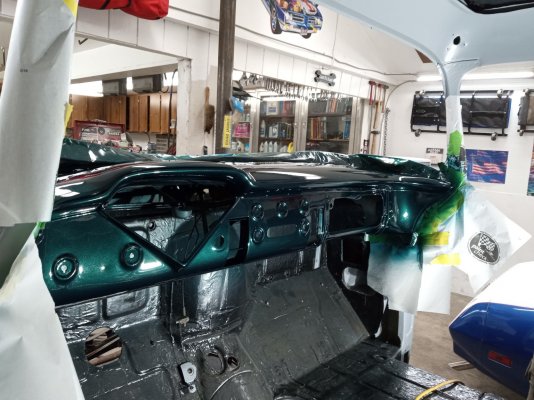

And then the painting began. I showed my son how to spray and then got up the nerve to hand him the gun knowing we would spend a lot of time sanding till he learned it right. He was a natural, and way better than me, and has held the gun from that time on.IMG_20230419_121711674.jpgIMG_20230426_141017960.jpgIMG_20230502_220528788.jpg20230714_160236.jpg

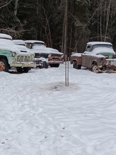

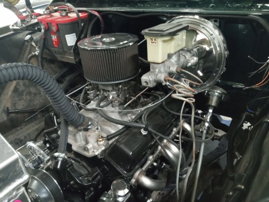

During this time he start collecting parts trucks. The big 57 GMC has a running 270 I6, he used the doors for his and I trade him a shotgun for the remaining. So the 57 is mine now. He also picks up a running fresh 350, 700R4, and NP208 from a local yard cheap. He is also buying nice parts like the brake booster, headers, carb, etc. He helped get me a 2002 parts truck so I gave him the red top battery out of it.

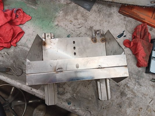

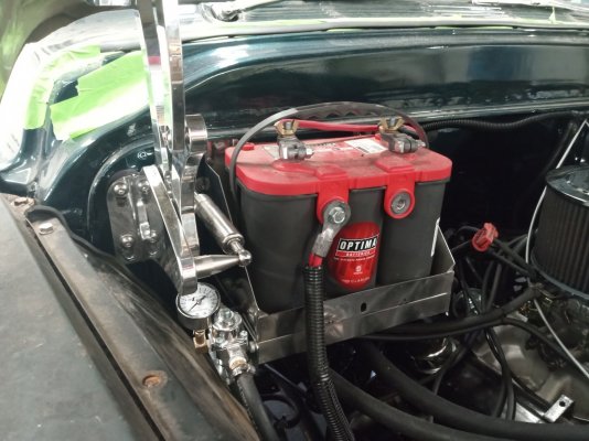

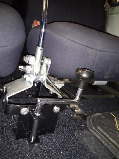

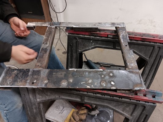

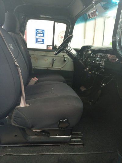

Part of the reason this has taken a few years it the we keep making stuff, and the other reason, I will get to later. Seat mounts were built from an old frame in the yard. Battery tray was bought, but we cut it apart and rebuilt it. Shifter is a TH350 shifter, but we made it a cab mounted cable shifter and t-case shifter.You can see the finished seat mounts in the shifter picture. I am making a leather boot to cover the whole shifter assembly.
20231017_170423.jpg20231025_145821.jpg20240416_202654.jpg7221753567154276188_083951.jpgIMG_20240831_164722084.jpg

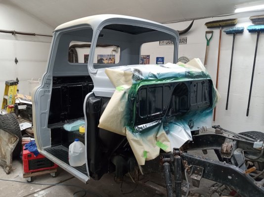

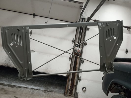

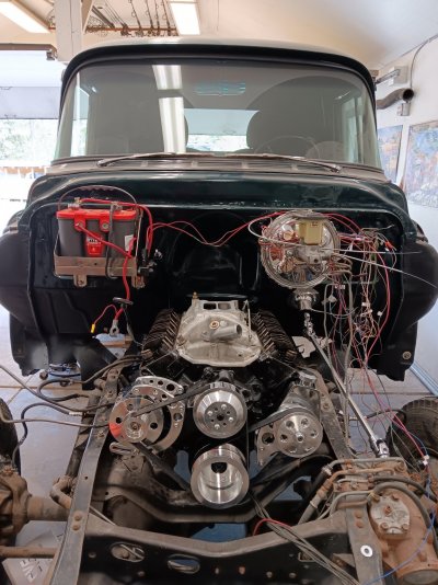

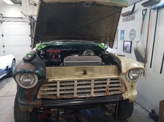

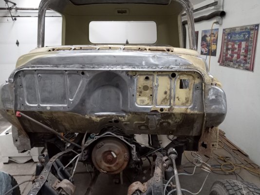

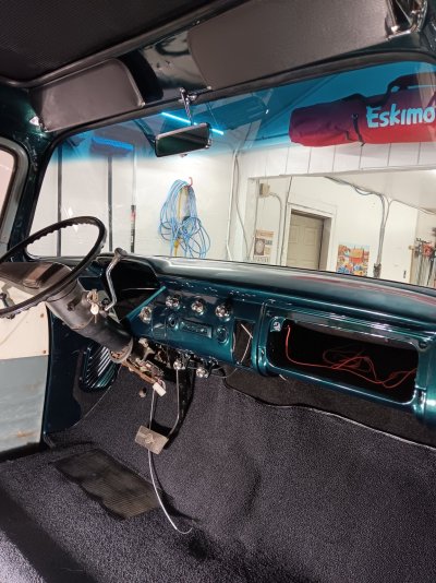

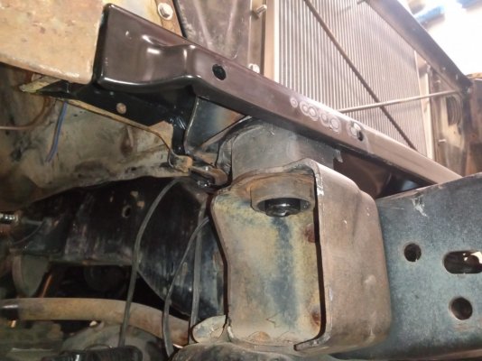

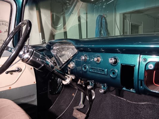

This is where we are at today, an almost finished cab and just finished getting the front clip worked out to mount on the 87 square body frame.IMG_20240831_164912832.jpgIMG_20240831_164928814.jpgIMG_20240831_164655863.jpgIMG_20250114_211108.jpg

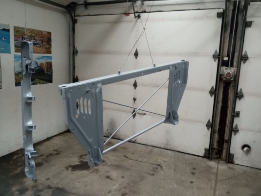

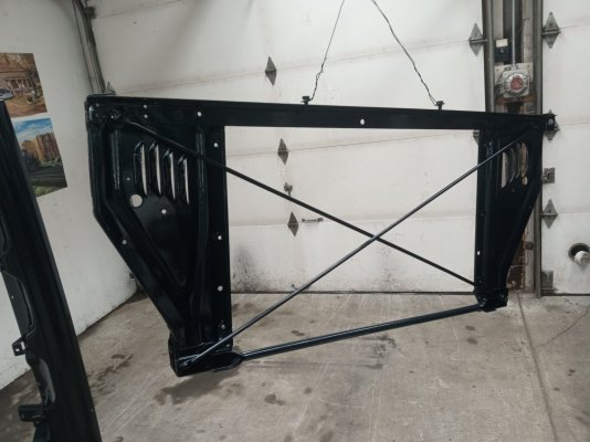

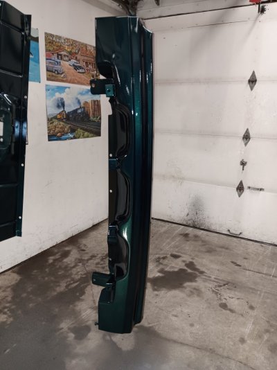

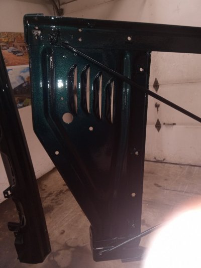

Now its back to body work and painting! Primed last night and painting today! The lower grill bar is reinforced to be a core support adapter to the frame because the steering box was preventing us from making a mount for the core support. Now I am off to paint, have a good day my GMT800 friends!

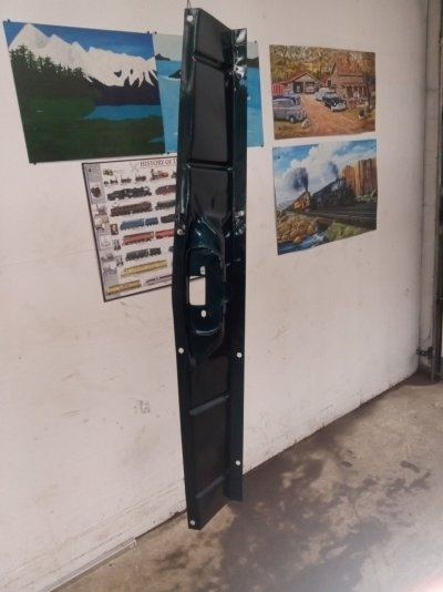

IMG_20250124_200525.jpgIMG_20250124_200530.jpgIMG_20250124_200531.jpgIMG_20250124_200533.jpg

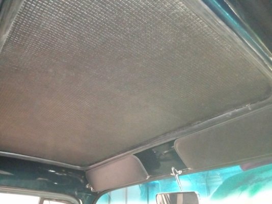

Parts are still hanging, family has a flu! Hoping to install tonight if we are able. This is shining some light to bring out the color, sunshine is best but we don't really have that in Alaska right now.

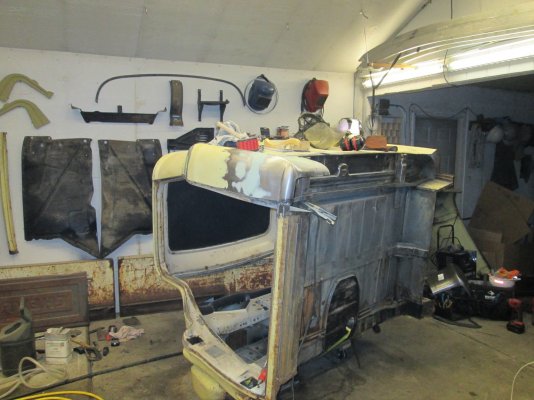

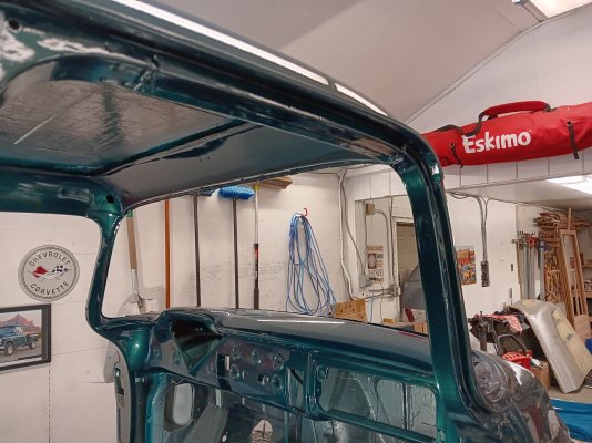

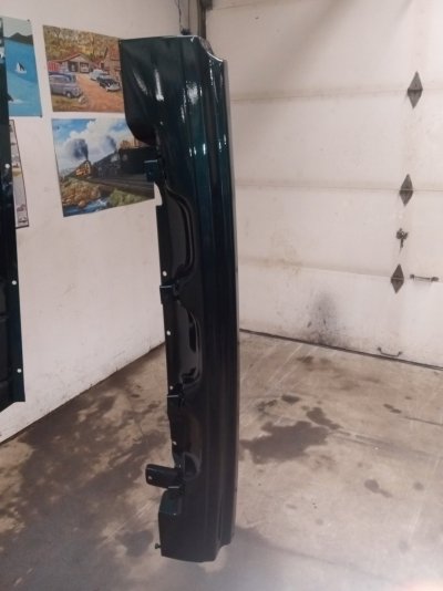

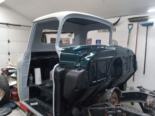

Since this dent is shown in pictures here, I should tell the story. Otherwise everyone will wonder why we didn't pull it. First picture is no dent, second picture shows the dent.
I used four ratchet straps and hooks in the ceiling to remove the cab from the frame once. My thought was, that I could release one strap at a time slowly and set it on the ground. That was a very stupid thought! When I pulled as hard as I could on the tail and released the strap, the cab became a battering ram as it smashed through me and some bins on the wall and hit the ground. That's not to bad of a dent for the fall, so me or the other three straps (which unhooked somehow in all the violence) absorbed enough energy. Since its not seen, and serves as a reminder to not be stupid, we left the dent.
