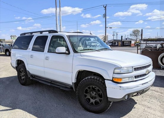

Hoping she stays in the family a long time.. would love to powdercoat or CeraKote those snowflake wheels black at some point, like below. Anyone done that with success?
[not mine, black wheel reference]

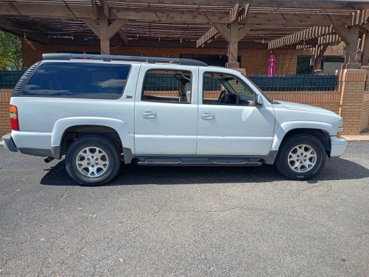

Thanks Stu, I was super impressed first time I saw her in person. Front bumper is cleaner than my wife’s 18 Denali.
I washed it after my 4 hour drive home, this is her good side (drivers side has some embedded dirt down low on the door panels hope a clay bar cleans that up)
