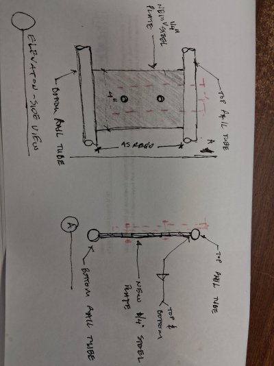

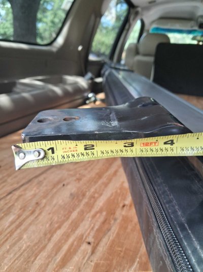

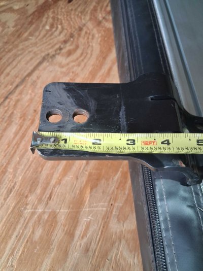

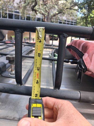

Sorry fellas. Here are some pics of the setup. I should have known that question was coming lol.
So basically I will just weld this sheet metal to the outer tube of the cargo rack. Then drill 4 holes for the mounting bolts. I have access to a MIG welder only. No SMAW or FCAW, which probably would be too hot anyways as mentioned.
It's to be used for camping while the vehicle is stationary and has some support poles that come down the ground when it's in use. I am more concerned with driving and the leverage that the thing will have on the mounting bracket during rough rodes, bounces etc.
Will that work? Use a thicker plate, something thicker that 3/16". You can use the thicker plate as a heat sink to prevent burn-tru of the horizontal rails.
And weld both front and back. By making the width of the plate generous, you lower the stresses being resisted by the horizontal rails.
You'll likely need to install shims between the 2 pieces because the plate will be centered, or cheat the plate towards the front.
