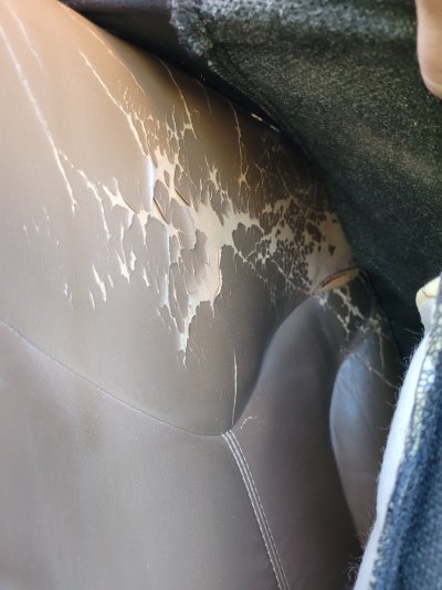

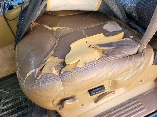

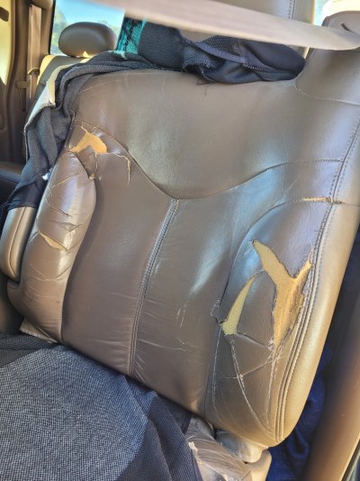

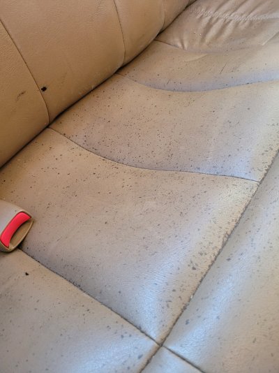

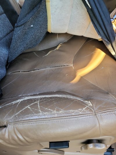

Both front seats have bad bushings in the tracks as the seats slide front to back a little. So I ordered up the repair kits for that.
Here is a couple of pics of the LF seat. Now you know why there are seat covers.
Eventually I'll see about ordering replacement seat covers & foam again.

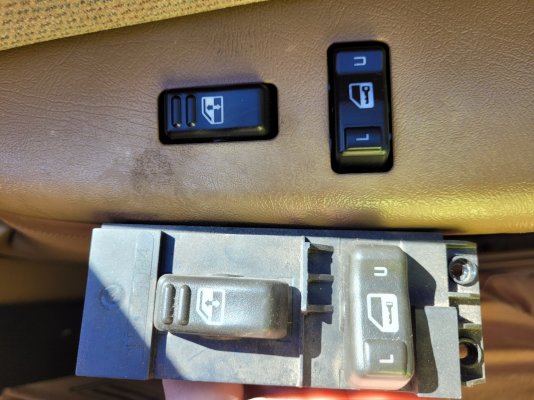

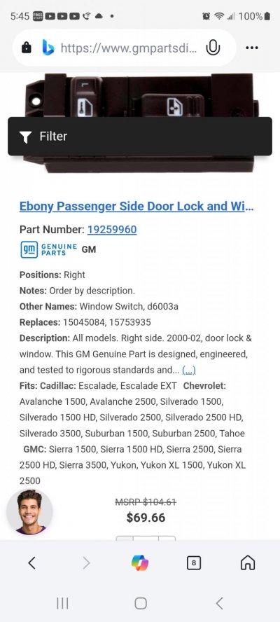

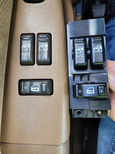

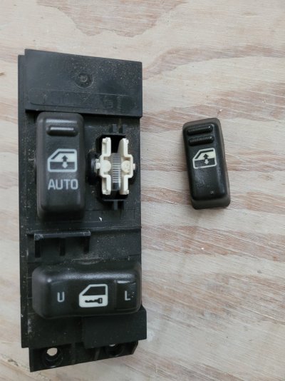

My brand new aftermarket passenger window switch came in. Got it from ebay for $12.74 shipped.
Looks identical to the original except it's fresh black vs faded black.
The oem unit is made by TRW, part # 15045084
Now my plug will stay put.
Yeah, yeah, I know that I still gotta clean the bezel. But I still gotta take the panel off a couple of more times.

Drivers window switch just showed up, so I installed it.
Again, aftermarket switch off of ebay $16.15 shipped.
Clean bright black vs faded black.
The oem unit is made by TRW, part #15054161
When I removed the Oem switch, the passenger button fell off. The tab is broken.
The new unit works just as the old one did.
But didn't solve my pwr locks not fully cycling.
I was always pretty sure that it was one of the lock actuators. Pretty sure that it's the driver's side that is bad as the interior lights do not come on when you pull the exterior handle.
But I had planned replacing all of the switches anyways.

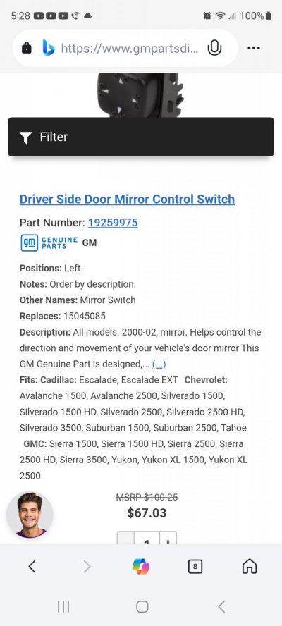

The new aftermarket pwr mirror switch also came in today.
$12.09 shipped on ebay.
Again, shiny clean black vs faded black.
The oem part # is 15045085
But this switch actually fixed something. My pwr mirrors now work as they should.

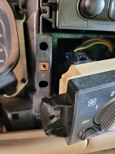

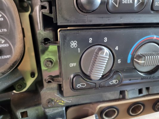

I also noticed that my HVAC controller moves when I hit bumps in the rd. So I pulled the bezel.
All 4 mounting pins on the back of the climate controller are broken.

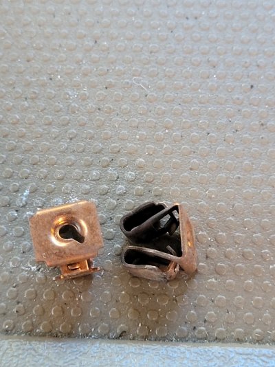

So I raided my GM interior hardware bin & grabbed 2 (for lack of the proper name) nutserts & 2 screws.
I put the 2 nutserts in the dash, then screwed the HVAC unit in, using the holes that were already there.
That's one less interior noise & one less project.

That driver's seat is as bad as I have ever seen.
