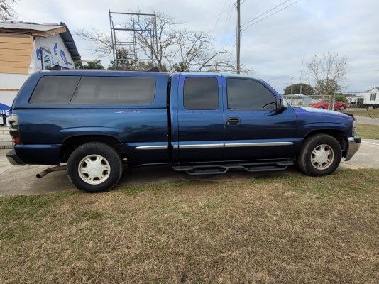

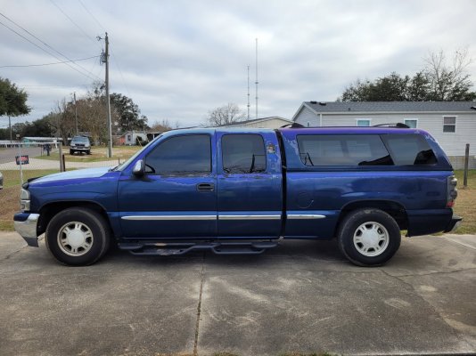

I bought a pre-faded color-matched A.R.E. cap.

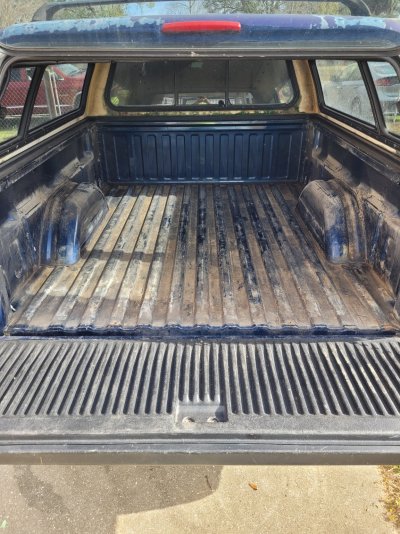

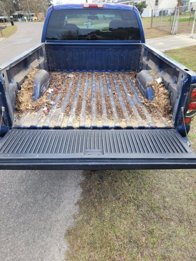

Pulled the rot-liner
This is why we northerners call them rot-liners.
Because this was a southern truck everything was dry under the liner. Best of all, no rot.
Swept out the bed
Said cap
mars2878
Apr 29, 2025
341
789
Florida
I like the topper, but how did you find one the matches? Patina and all!
Just Luck, lol
It was on a black Sierra.
Funny thing is that I was thinking about a clean red one near me, I just going to paint it black. But I didn't want to pay his asking price.
A couple of months later this Blue one popped up.
Meanwhile the Red one is still for sale.
Just Luck, lol
Its perfect, looks like it was on there since new.

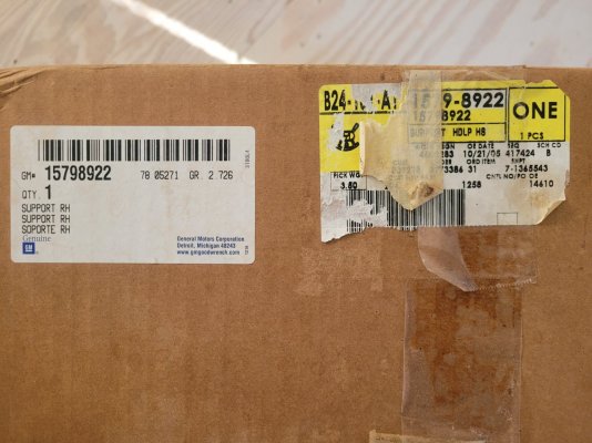

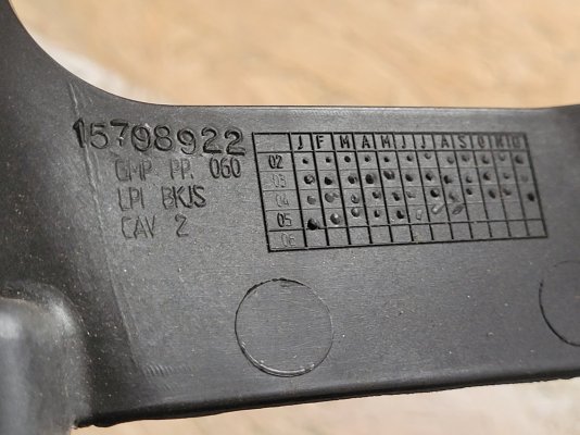

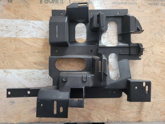

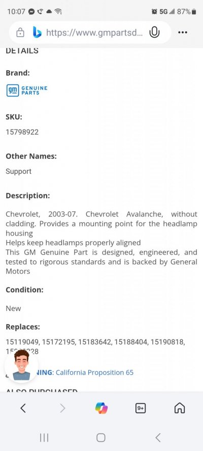

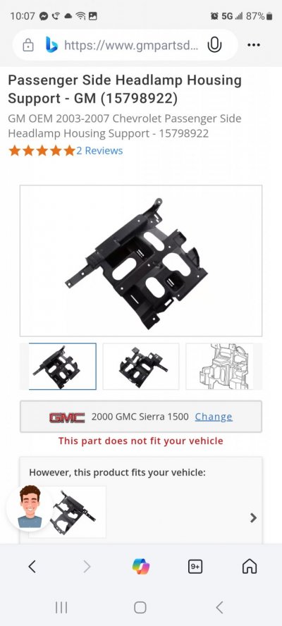

Soo...I thought that I did good. On marketplace, free OEM NOS passenger headlight bracket for free. Advertised as Silverado/Sierra. I didn't verify, I just grabbed it.
Doh!!
Nope.
Negative.
2003-2007 Silverado & non-clad Avalanche only.
Now I get to unload it.
Hurray, as if I didn't have enough work to do or things to sell, lol
Guy said that he bought it 2005 after hitting a deer in Indiana. But never installed it. Then moved to VA, then moved to FL. No longer has the truck & cleaning out the shed.

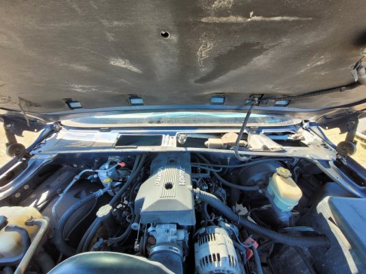

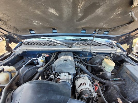

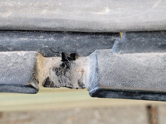

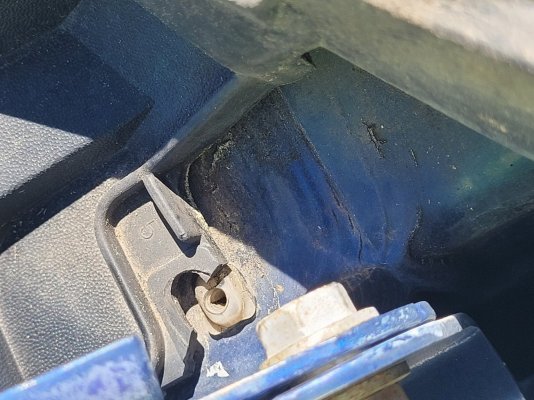

Soo, on that drive to Tampa the Sierra drove great. But there was a weird slapping sound while on the highway. I've never heard this noise before from the truck. But I couldn't tell you the last time it was on the hwy.
But the last time it was on a hwy, it didn't have the cap. Was the noise coming from the cap?
I was confident that it was coming from the front, but where?
My mom thought that it was coming from the roof.
While driving, we are touching one interior panel at time to see if it changes pitch. Even pressed on the overhead console as ive previously done some plastic welding on it.
Nope, nothing.
It sounded like a cargo strap slapping a body panel.
When I get out, I'm checking the windshield molding thinking that it somehow came loose. Nope, not that either.

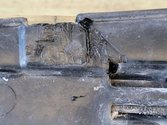

Ahh ha, found a potential noise maker. The driver side of the wiper cowl was loose. I pull the end cap off & find that the screw mount is broken along with the screw is missing. I also find that 2 clips on the fwd edge are missing.
Someone has clearly been in here before.
Also, one mount is broken off of the driver side end cap.
And the rubber seal is damaged on the passenger side end cap.
The 2000 cowl part # is: 15047072
The 2002 cowl part # is: 15060065
I did not notice any differences between the two parts.

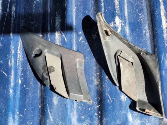

The 2000 L cowl end cap part # is: 15045455
The 2003 L cowl end cap part # is:
15045455
Again, didn't notice any differences between them.
The 2000 R cowl end cap part # is:
15045456
The 2003 R cowl end cap part # is:
15113341 15753702
Still no noticeable differences. But I know that the R cap is different between with & without a Fender mounted antenna. I currently don't remember the years that are involved?

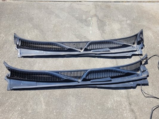

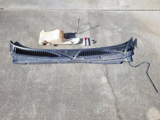

That brings us to the salvage yard haul on Saturday the 14th.
Wiper cowl & washer fluid reservoir from a 2002 Silverado.
The 2 end caps from an 03 Yukon.
Plus the missing screw & clips.
Extra (not needed) door panel courtesy lights.
Oh and the receipt for this lot. $36.08 for everything. Not too bad.

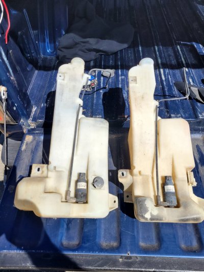

Step one, bag & label the spare parts & put away.
Step two, start stripping so that I can swap washer fluid reservoirs.
Before buying the used one, I filled it with water at the yard and walked around with it, it never leaked.
On mine, while still fully installed, I couldn't determine where the leak was.
Was it the tank? Was it the pump motor? Was it one of the two Seals in the tank? Was it the elbow from the pump to the line? Was it the line?
I have no clue, figured it was safe to swap the entire assembly.
mars2878
Apr 29, 2025
341
789
Florida

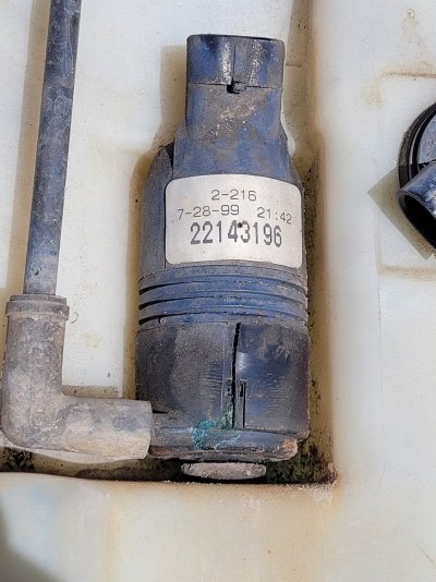

Nope, I'm partially wrong.
Now, knowing that the electrical system changed with the 2003my. I'll stick with the 99-02 electrical parts. Especially if I can't cross reference it. Which in this case, I couldn't on the tank.
As you can see in the pic, the washer fluid tank changed also as is the top half of the washer fluid line.
My 2000 Sierra tank is on the Left.
The 2002 Silverado tank is on the right.
Notice the left side of the tanks.
The 2000 tank is larger. Also, the bump out on the left has clip mounting point for the wheelwell liner. What does that mean? Well, that means, if you don't also swap out to the matching wheelwell liner, the inner spot will not be clipped in , leading to a potential slapping sound when driving?
I'm undecided if want to punch a hole for the clip or swap back to the original tank & just swap motors?
Part # on the 2000 tank is: 15035069
Part # on the 2002 tank is: 15073651
Now that the original tank is out, I'm confident that the pump itself was leaking?
Both pumps have the same part number on them. # 224143196
So that means either in 2001 or 2002, both the washer fluid tank & LF wheelwell liner had revisions and neither can be considered as 99-02 parts.
Funny thing is that on ebay, people are selling my 2000 part number as being correct for 99-06. That is a dimensionally large part to be screwing up on.

Ahh ha, found a potential noise maker. The driver side of the wiper cowl was loose. I pull the end cap off & find that the screw mount I'd broken along with the screw is missing. I also find that 2 clips on the fwd edge are missing.

While I decide on what I want to do about the washer fluid tank, I'll start prepping for swapping out the cowl panel.
Everything out of the way.
1st things first. Visual inspection for differences & damages. Especially considering that the part numbers are different.
I don't notice any differences, so onto the repairs.
Now for a slight repair. All of the cowl panels were either missing or broken due to morons.
A little plastic welding and good to go.
These clip areas are thin, so a little on the tough side.
All back together.
