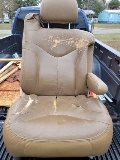

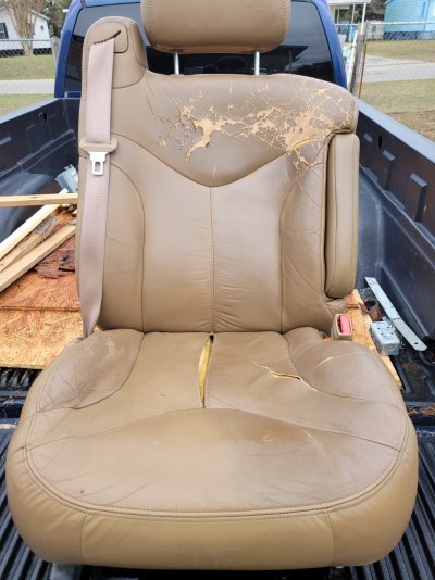

So I lightly cleaned up the passenger front seat. Yes, I know that the leather is shot & that I'm putting the cover back on it. I just wanted to clean it up a little first. Plus if it had any smells to it, it would dissipate it some.
Before:
Half way through:
It did lighten up a little.

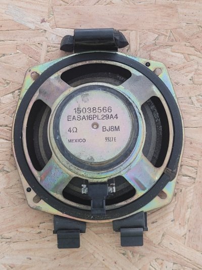

1st, the removal of the 25yr old stock speakers. While they sound great at lower volumes, it's when you get about half-way in volume and it starts to crackle.
OEM part # 15038566
Surprisingly, the cones were intact still.

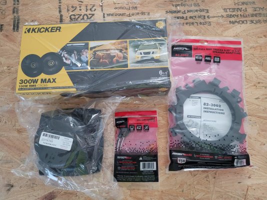

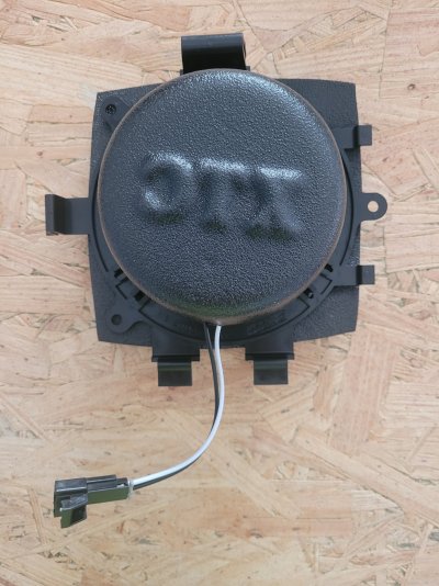

Now on for the new speakers.

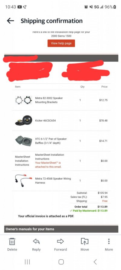

I chose 6.5" Kicker 46csc654 speakers for the doors.
Stock size, so zero mods to the door.
Crutchfield retail was $100, on sale for $80. The next level down retailed at $80.
Plus they came with free Metra harness adapters. That was a $10 savings in of itself.

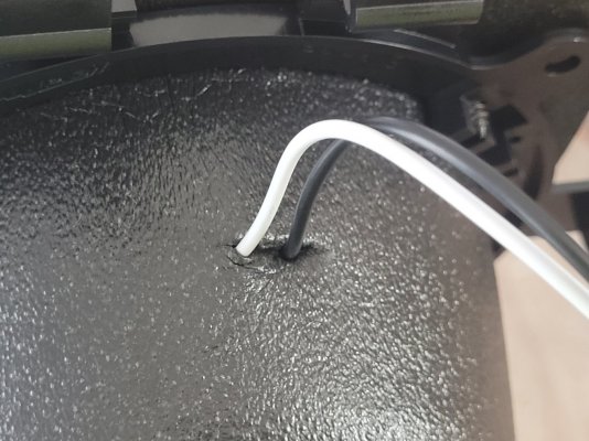

I also picked up XTC speaker baffles.
A: they help direct the sound into the cab with less lose in the doors.
B: if your weatherstripping happens to leak water into the door, it helps to protect the speakers from the weather, which in turn helps them last longer. I've been using them for years and put them on everyone's install.
Now for the pics, because who doesn't like pics?

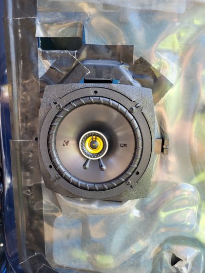

And yes, I also use the Metra speaker brackets. Like I said, zero mods to the doors.
I just cut a small slit into the bottom of the speaker baffle and insert the harness adapter 1-wire at a time through it.
When done, the assembly is essentially a small speaker box.

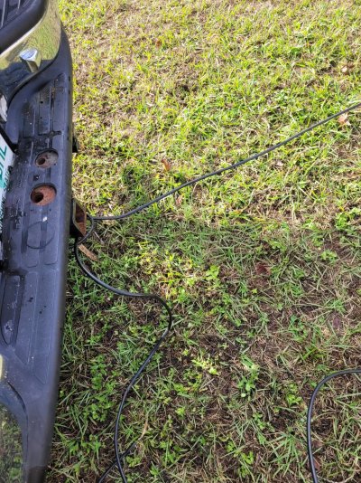

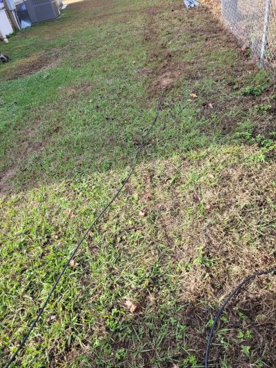

Seeing how my helper didn't show today, I used the truck to pull a coaxial wire.
Yeah, you read that right, lol.
The coaxial cable was buried about 4" in the ground & not encased.
Because I am doing a full rehab & the coaxial was either damaged or disconnected in the house, I just gutted all of it instead of wasting time tracing the mess.
I'll run all-new cleanly.
Seeing how it rained heavily yesterday & last night, the ground is softer. I'm not willing to hurt my back or hands trying to pull it through the spidergrass roots. So I tied it to the Hitch and drove extremely slow. It broke a few times. So I just retied it & pulled again. Ended up pulling about 50' of cable.
After I pulled it up, I just pushed the lawn back into the hole & stepped on it. I'm not overly concerned with the lawn condition yet. Maybe next yr I'll get it fixed correctly?
mars2878
Apr 29, 2025
342
790
Florida
Work smart not hard...worked! I'll keep that mind if I ever come across that task!
Funny enough, this is the second cable buried in the yard. I pulled the other one a few months ago. It was only buried about 2".
Lazy people.
If you went & did actual yard work, these cables would get damaged because you didn't know that they were there & why would you?

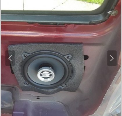

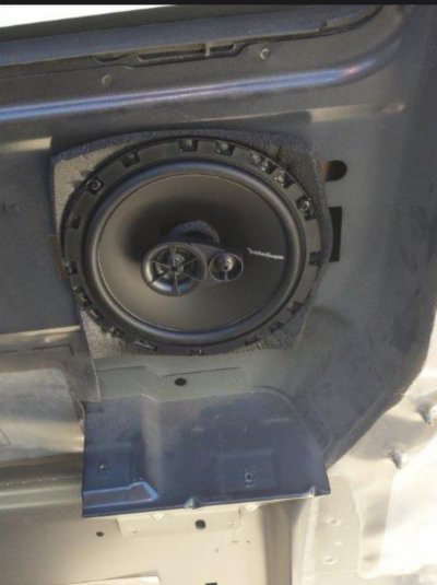

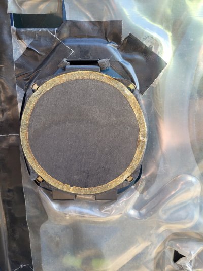

4silverado
Aug 21, 2014
480
1,085
Somerset, KY

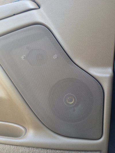

In the extended cab doors, you can fit 5 1/4 or 6 1/2 round if you don’t mind opening the hole a bit. You just have to watch the mounting depth. I’ve done both in extended cabs. Red is current, gray was last truck. I’ve always used those baffles.IMG_8949.jpegIMG_9110.jpeg

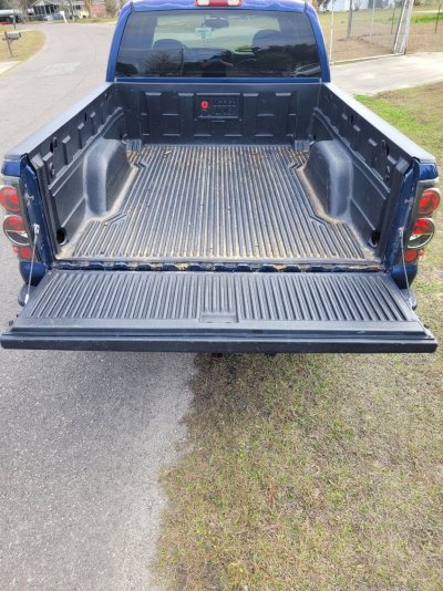

The following picture is the hint to something that I did to the Sierra.
No, I didn't put a bedliner in the truck, the rotliner came with it.
