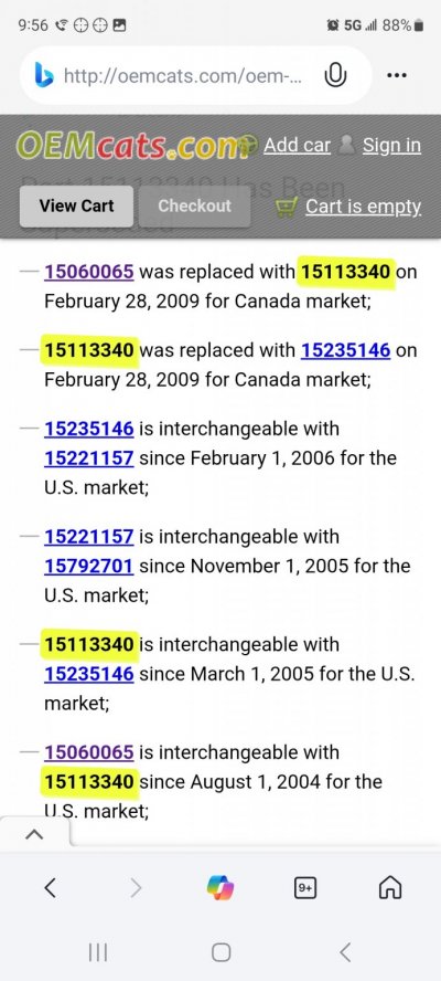

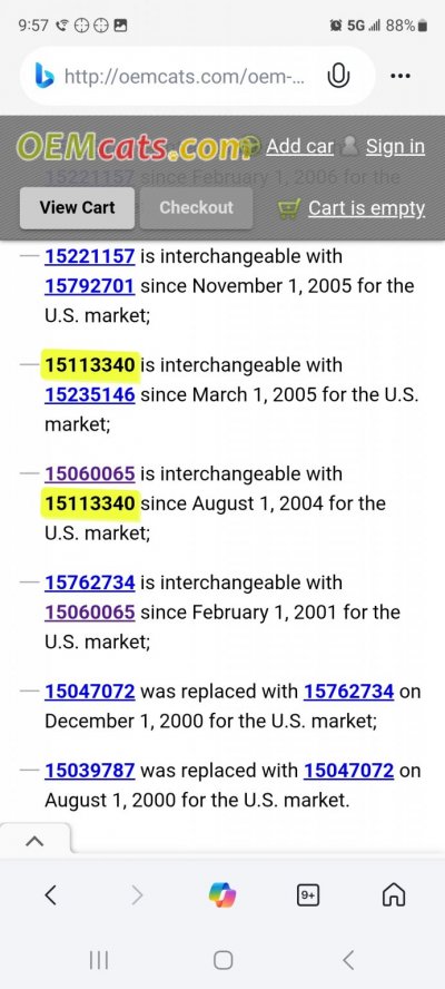

Here is the part number interchange list for the cowl panel.
That's alot of part # revisions in a short time period.
I wonder if there truly is a part difference that I didn't visually notice or just a corporate money wasting shuffle?

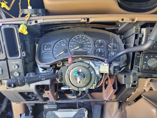

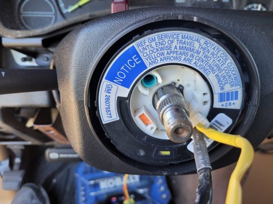

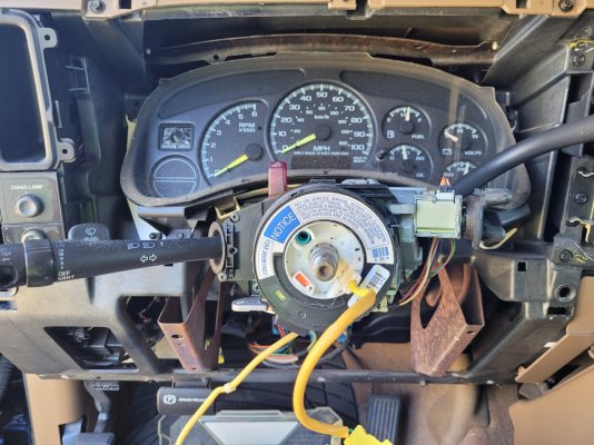

I'm finally swapping out the clockspring & steering wheel cover to add the factory steering wheel radio controls from a 1999 GMC Jimmy.
Relative easy straight forward job.
Disconnect battery & wait 15min.
Remove steering wheel airbag.
Separate and remove steering column clamshell cover.
Remove dash bezel.
Remove steering wheel.
Remove knee panel.

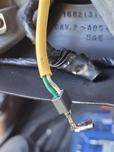

Unplug & fish out clockspring harness.

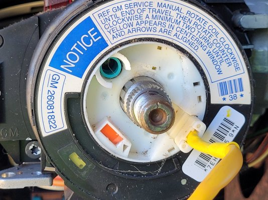

My clockspring part was #26081822
Remove clockspring.

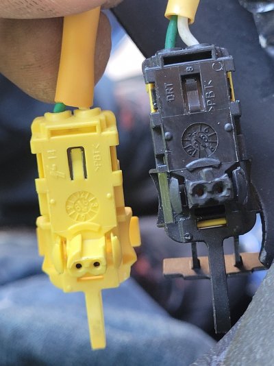

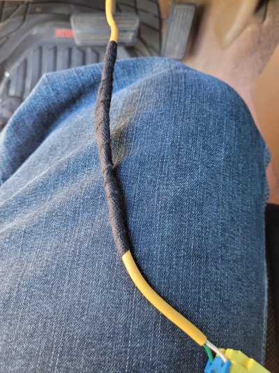

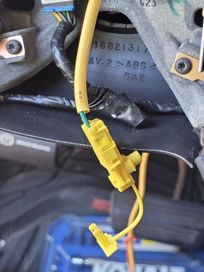

Now reverse the order to put it back together with the donor parts but with a potential mod or change depending upon which donor parts you got?
In my case, I have to change both plug ends on the donor clockspring.
Now if I had also gotten the Jimmy airbag, then I wouldn't have needed to change the airbag plug. But because the plug housing is easy enough to open with a pick, I just swapped the housings.
Sierra plug is yellow. Jimmy plug is black/yellow.
By swapping the plugs, I didn't have to buy an airbag to.

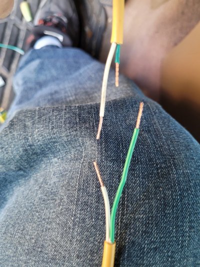

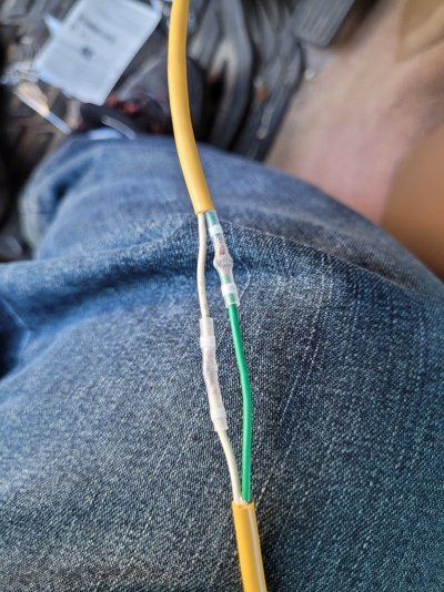

Now for the fun part, swapping clockspring pigtails on the harness under the dash.
The pins inside the housing are not even close to the same shape, so you can't swap just the housings. Gotta cut & swap pigtails.
I offset cut the wires so it's not too fat in that area when put back together.
Always give a pull test to verify that it's nice & tight.
Now plug the harness back together.

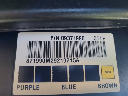

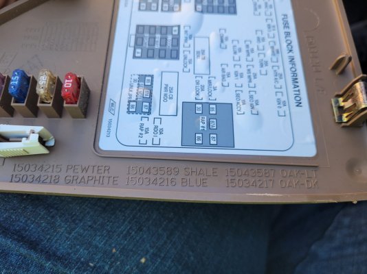

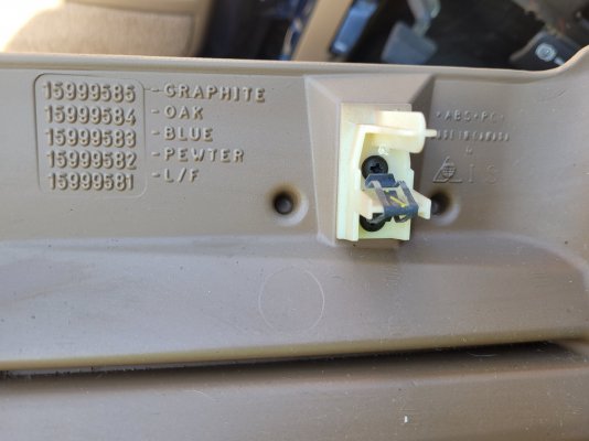

Now reinstall the knee panel.
Graphite # 15999585
Medium Oak # 15999584
Blue # 15999583
Pewter # 15999582
L/F # 15999581
I'm not sure what color L/F is?

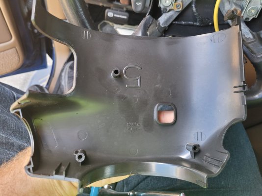

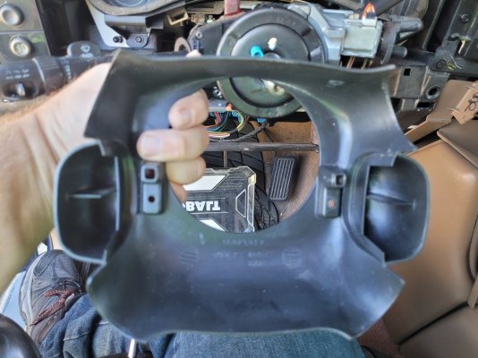

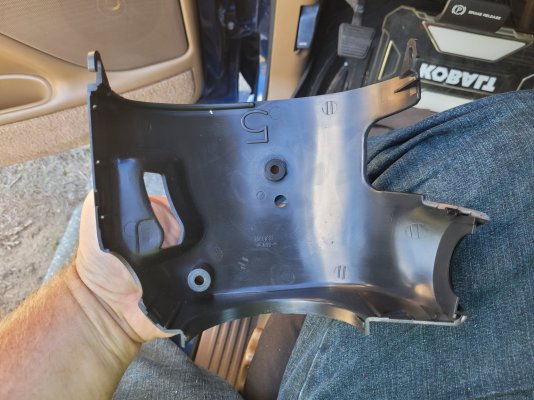

Reinstall the steering column clamshell.
Upper part # 26061834
Lower part # 26061832

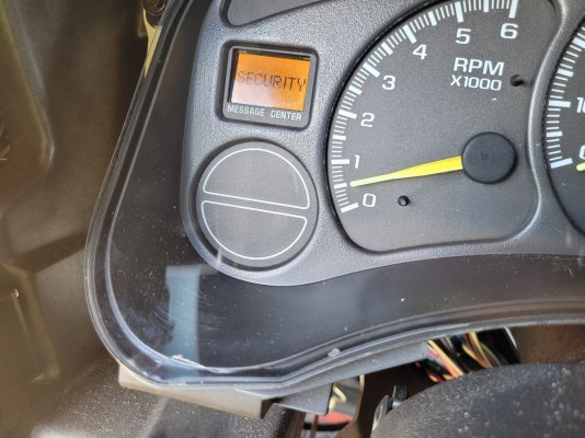

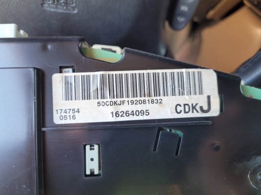

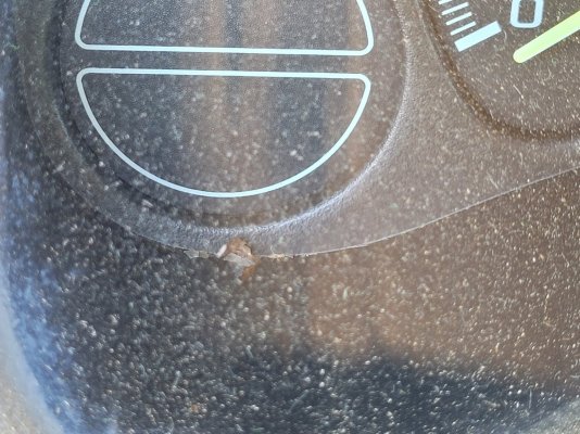

Before putting the dash bezel back on, I'm going to do some cleaning first.
Got a dead friend inside the cluster.
My cluster part # is 16264095
Took the lens off. Gave a quick wipedown of the cluster & inside the lens. Knocked off the flaking coating that was the Message screen. Reinstalled the lens & cleaned the outside.

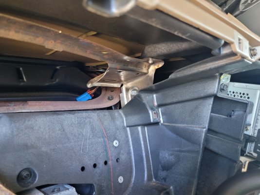

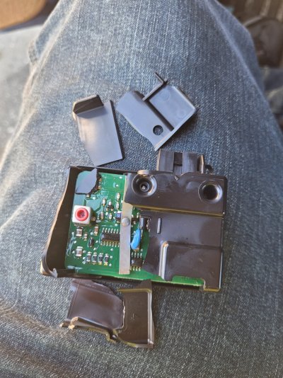

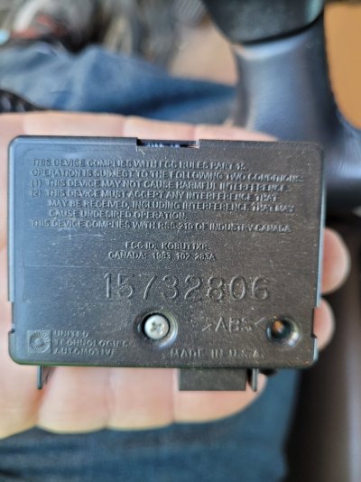

While the cluster was out, I noticed this black box dangling there not attached in place. Most likely one of the noises that I occasionally hear?
I unplug it to A: see what it is & B: see how it's supposed to be attached so that I can reattach it securely & potentially eliminate a noise.
Keyless Entry Receiver part # 15732806
Bad news, this box crumbled in my hands.
So the next time that I visit the salvage yard, I'm going to get a replacement. I also fished out the other broken pieces that I could find.

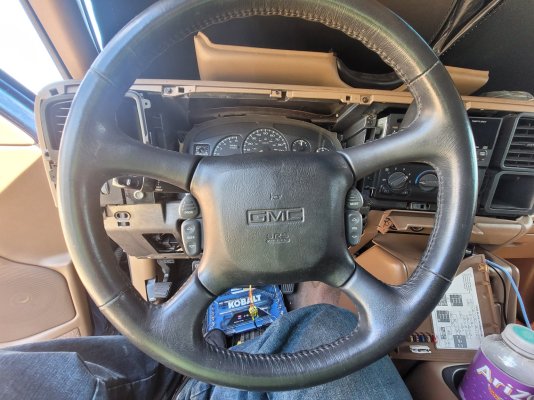

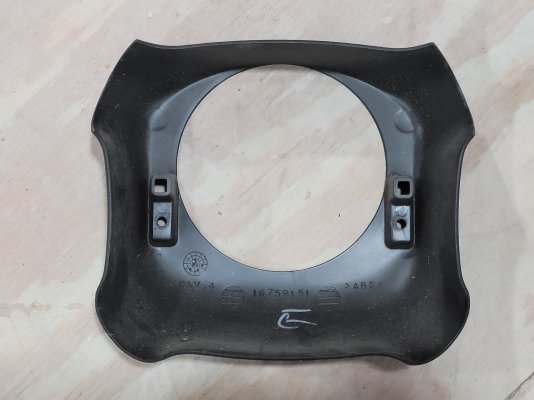

Now to work on the steering wheel. The leather on the donor steering wheel was in bad shape, so I am swapping all of the parts onto my steering wheel.
1st, remove all of the screws to remove everything.
Remove the rear cover.
My original cover # is 16759151
Then install the donor cover. Part # 16821317
Plus install the switches & harness. Because my steering didn't originally have the switches, the holes weren't pretapped. I little extra oomph & the screws will thread the metal of the steering wheel.

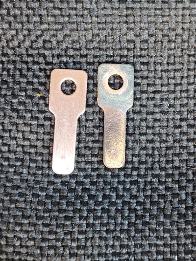

I cleaned the contacts before reinstalling. Left is clean, right is dirty.
Reinstall the steering wheel and airbag.
Tilt the steering wheel up. Reconnect the battery. From outside the vehicle, reach under the column & turn the key forward. Then start the vehicle. If you didn't screw up the wiring, the airbag didn't deploy. Therefore you didn't eat the airbag by sitting in front of it when testing.
Just did my heater core, and this little guy broke off on me too. I need to go get one myself or just rig something up and velcro it down. But my key fob has been weak even with a new battery so I think changing it is the best route.
I hope/assume that you did the a/c evaporator while you were in there.
