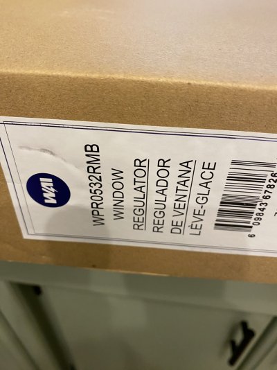

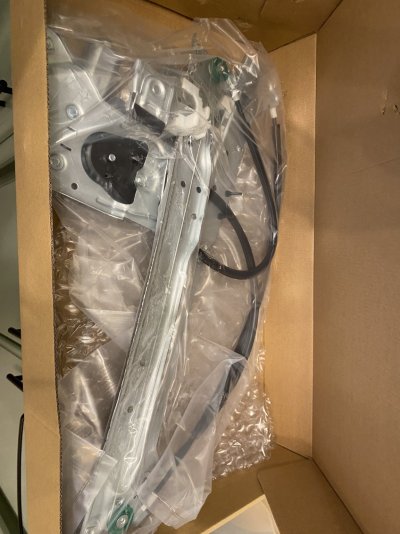

Not much happening recently, finally ordered and received my passenger rear window regulator. It hasn’t worked since I bought it and my son is finally old enough now that he’s forward facing and wanting to look out of windows. So I figured now was the best time to fix that for him IMG_1518.jpeg

You will see that the "remove the old and replace the new" is pretty easy. I have done 3 of them. Tape that window up out of the way and it will go pretty smooth.

Not much happening recently, finally ordered and received my passenger rear window regulator. It hasn’t worked since I bought it and my son is finally old enough now that he’s forward facing and wanting to look out of windows. So I figured now was the best time to fix that for him View attachment 3478
I replaced a friends regulator on his Avalanche last year. The funny thing was, he was driving down the highway in a full tilt rain storm when his window dropped all the way down. We have very few big rain storms, and very little highway, so the odds of him getting completely drenched from this about one in a million.
