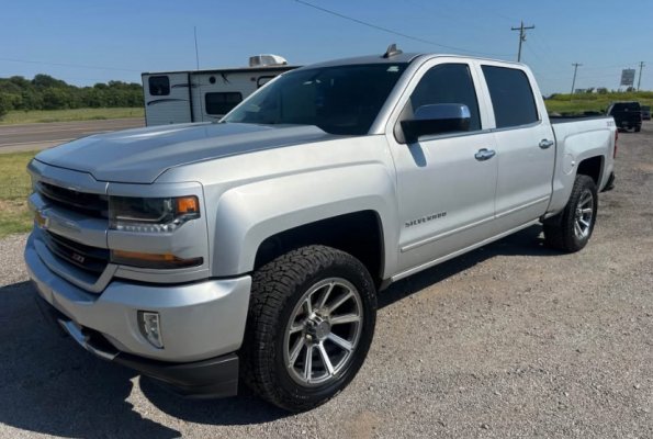

I’m no stranger to it, beat preventative maintenance is on time oil changes for it. Anyways, here’s the new family hauler. I ended up buying the 2016, the dealership with the 2014 could not give me a straight answer on whether or not it sold. And when I spoke to the sales manager he asked me “what were you looking to accomplish by coming here?”. Talk about enough to make blood boil… why else would I come to a place that SELLS CARS AND TRUCKS?? Anyway, I paid 12,400 for the 2016. Super clean truck, new trans last year and brand new tires (still had the nipples on them). I used the fact it had a torn CV shaft boot to talk them down from 13,000. Put over 100mi on it today with no issues. IMG_1760.jpeg
