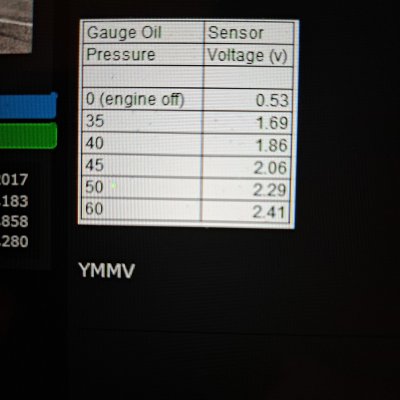

So another question. I’ve noticed my oil pressure gauge never really moves. It’s pretty much always at 60. When I kill the engine it’ll sit at 40 with no power. Under throttle and it’ll move a little bit but no really noticeable changes. Is this normal? What should typical readings be? I plan on changing Oil and rear diff fluid tomorrow and filters (Oil,fuel,Air). Probably going to grab tester gauges for oil and fuel pressure as well. 1st pic is otw to work this evening after warmed up, 2nd is “cold” start after sitting for 6hrs
Because of this, I would assume your stepper motor is on the way out. This is a very common issue with GMT800 clusters. When one stepper goes, it is common for the others to follow. I replaced my cluster at 230-ish because of a failed oil pressure stepper motor. Mine would move to the right when I started then engine and then get stuck. When I re-started the engine the next time it would move again and then get stuck at a higher pressure until the needle was stuck maxed out all the way to the right.
IMO, The fuel pressure gauge is a good idea, but a decent scan tool will be able to tell you your oil pressure as seen by the ECM. This would be a good way to verify gauge/cluster issues VS oil pressure sender issues (these can also be somewhat troublesome on LS based engines). When you have the diff cover off, jack the truck up and put it on jack-stands. Pull the rear brakes (this eliminates drag on the axles) and drop the rear of the driveshaft. Spin the yoke by hand and feel how the bearing is moving. Try to move the pinion up and down at the yoke. Also try to move it in and out. You are looking for play here and don't want any. This is different from backlash, which you will feel/hear as a bang-bang as you turn the yoke back and forth before the gears engage. If you have some grease, it works OK as gear compound and you could run a pattern on the gears.
FWIW, the 99 4.8 in my Sierra holds 30PSI oil pressure at hot idle. I see just over 40PSI cruising at temp on the freeway in overdrive. That is with my preferred 10w30 HDEO. Somewhat recently I was seeing 20PSI at hot idle, but that was a one-off type of situation.
Like @INW-Iron-Steel has said about the oil pressure stepper motor, I bet it is bad. I bought my listed truck on Dec. 1 and all was good. Then it started to act like the 40 psi level was actually the "0" pressure level. Everything started at 40 psi and worked from there. It is not unusual for the gauge to shut off at around 30 psi to 40 psi when you shut engine off. When you then do the KOEO, it should drop close to zero and then of course show actual pressure when start the engine. Is also likely that the other stepper motors will start to malfunction. You can use a live data scanner and measure voltage that will equate to oil pressure. I bet yours is off. I would contact Digital Dash Solutions and look at the site and you can customize the look if you want and even add a transmission temp gauge that is just plug and play. I am going to supply a link for them and an oil pressure voltage pic to compare with.

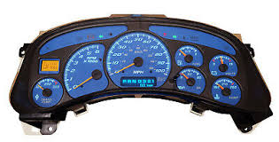

I think the clusters may be a little different. 99-02 looks to have the information readout over on the left, while newer clusters moved this down underneath the gear selection indicator. Blue gauges are the 99-02 cluster. I wonder if these are interchangeable between all years?
View attachment 2359View attachment 2360
99-02 will only work in 99-02 trucks and full size SUV, same goes for the 03-07 gauges.
But, 99-02 gauges that have trans temp(Denali, Escalade and hd trucks) will work in a truck that originally did not have a trans temp cluster.
