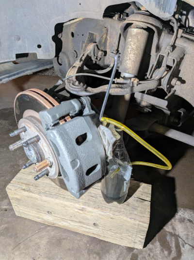

New front brakes! One of the calipers was frozen, which turned out to be a slide pin. I intended to just rebuild the brackets and push the pistons back. One of the piston seals ruptured, so new calipers! That was probably the third brake job on those calipers, and autozone was happy to warranty them. This is what a 10pm gravity bleed looks like after you procrastinate a simply job to the point where all the shops are about to close...
I ended up flushing the lines too, the brake fluid I was initially seeing had a green hue to it. Copper = not good!
Totally budget, I like buying reputable closeout pads from RA. I think these were carquest flavor metallics for $12 with hardware. Dusting is bad, but they stop good.

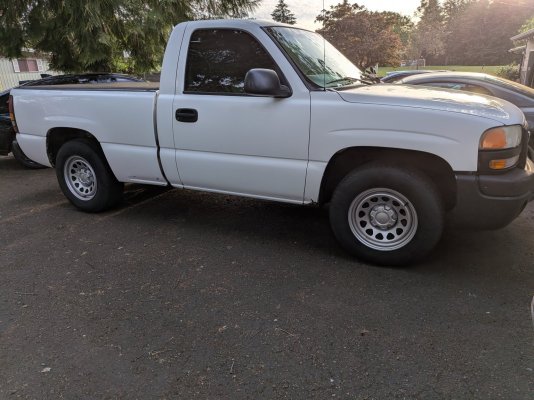

New look! I scored these on marketplace. I was told takeoffs from a 24 Sierra, and that checks out because the DOT numbers are same year. I'll take that for under $200.
The 18s with 285s are on the Suburban (and look amazing). The black 17s that were originally on this are goin to my old man. He has been asking me about them for a project he's working on, I decided I'll just give them back.
