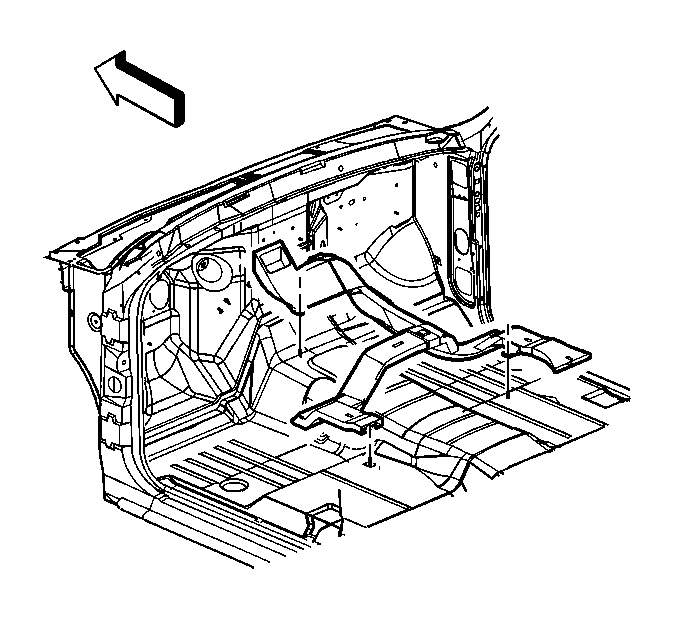

[H3]Removal Procedure[/H3]
  1. Remove the floor console. Refer to Console Replacement in Instrument Panel, Gages, and Console.
  2. Remove the seats. Refer to Front Center Seat Replacement in Seats.
  3. Remove the HVAC module assembly. Refer to HVAC Module Assembly Replacement .
  4. Roll the carpeting back to expose the rear floor air ducts.
  5. Object Number: 363114  Size: SH
  6. Remove the rear floor ducts from the floor studs.
  7. Object Number: 363016  Size: SH
  8. Remove the rear floor duct.
[H3]Installation Procedure[/H3]
  1. Object Number: 363016  Size: SH
  2. Install the rear floor air duct.
  3. Object Number: 363114  Size: SH
  4. Install the rear floor ducts from the floor studs.
  5. Position the carpeting back into place.
