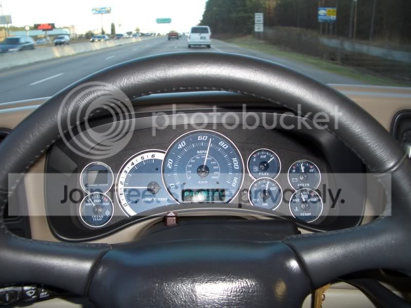

2000-2002 are compatible. 2003+ use completely different wiring.
Here's my 01 Tahoe with Esky cluster

i do have a couple of junk yards that ive found and re sold obs esky clusters but never have i seen a nbs, does the trans temp work?

trans temp work fines. All the wiring is there, just the cluster is needed... it's plug n play
