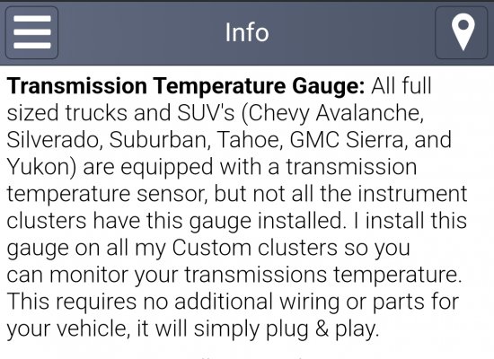

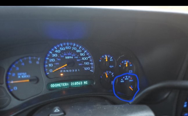

Is this what you mean?
Yes, like @someotherguy said and the info page, the wiring is there already. That way when GM made the harnesses, they saved money making them instead of having two different lines for them. Once you plug it in, if the sensor is still good at the transmission, you will see transmission temp while driving.

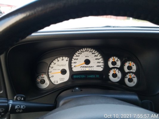

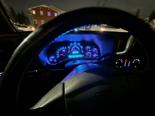

So you got that carbon fiber look and the different color and the transmission temp gauge too.

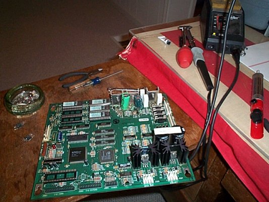

I can't help but tinker with almost every damn thing so I just broke out the tools. :) I've got them for numerous other reasons already, so why not.

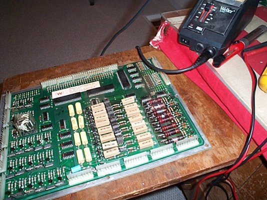

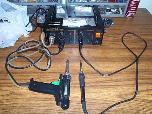

Etc., etc. in other words it just feels natural to me to whip out the soldering iron and go to town. That USA-made Weller unit has served me very well; bought it about 25 years ago when I lived in ATL .. I've got a really nice old Hakko solder/desolder station that I still need to repair the vacuum pump on it but never seem to get around to that.
