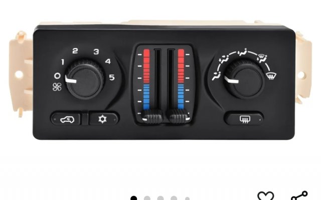

What color are your climate controls LED’s? I’m pretty sure mine are blue and it’s definitely stock.
They're not LED's stock. The only LED's in the dash, stock, are the indicator lights in the gauge cluster. All the general illumination are small incandescent bulbs. Some of them depending on location have a small blue sleeve over the bulb that doesn't really give it a blue appearance, just a very slight tint of the color to remove the yellow.

The blue I was thinking of was the digital segmented display.

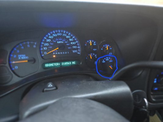

I placed my cluster order last night from digital dash solutions. I just hope it was the step motor that caused the temp indicator to go wonky. Also I ordered a Headlamp Dimmer Switch Replacement and climate control module from Amazon. Can't wait to install everything.

I've got the blue backlit gauges in my 04. It looks really nice. I've got a picture of it in the build thread on my truck, and a picture of the stepper motor failing and telling me I had astronomical oil pressure...

Mine haha
Mine haha

If you have a live data scanner, you can compare stepper motor readings with actual scanner readings. I was getting way high oil pressure readings, like @INW-Iron-Steel had.
