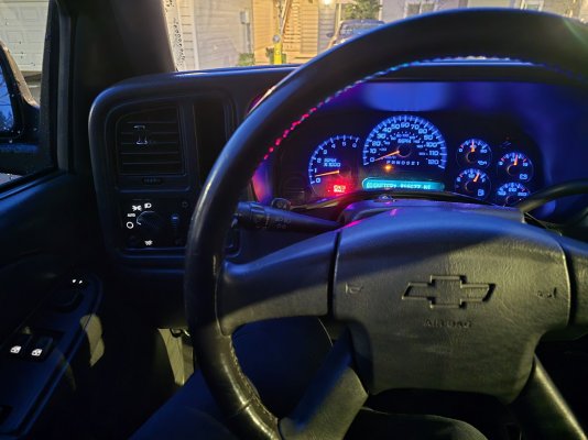

I've got the blue backlit gauges in my 04. It looks really nice. I've got a picture of it in the build thread on my truck, and a picture of the stepper motor failing and telling me I had astronomical oil pressure...

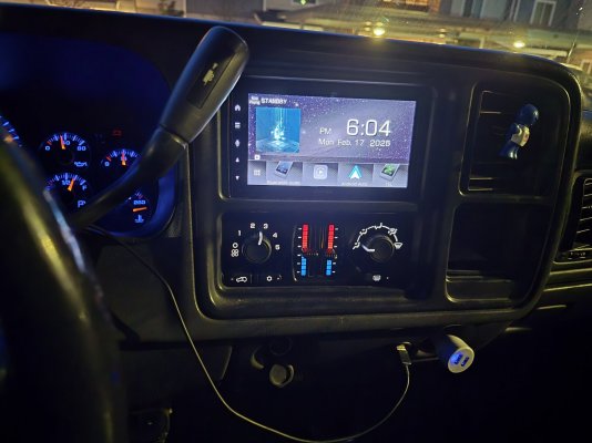

Welp, both went in pretty easy. Nice to see lights and Dimmer works perfect.

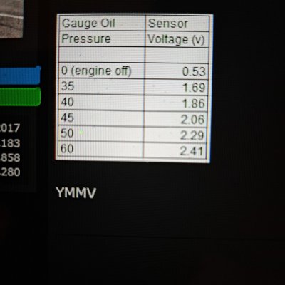

You know it is not gonna give actual oil pressure, right? It is gonna give you voltages and there is a scale for the equivalent psi to that voltage.
