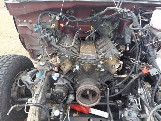

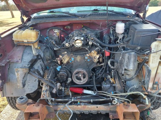

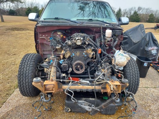

Well i had a few hours to kill before some friends came over for a crab boil, so i decided last night i would just remove the hood and fenders to make thing simpler if a problem comes up. I was worried about a broken header bolt and having to drill it out. From there I moved all the wiring and throttle cables out of the way, unplugged the coils and fuel lines. Removed the intake manifold, and slowly worked on removing the headers. I have been PB blasting all the hardware since yesterday and everything came right out, luckily. Next week I will remove the heads and pick up the 799 heads.

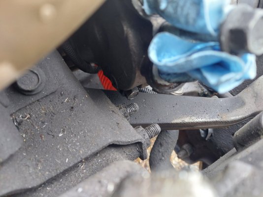

The only hang up ive had so far is removing the dang AC compressor. I can remove 3 out of the 4 bolts. The last bolt is directly behind the engine mounting bolt. I didnt mess with it too long, since i had friends coming over soon. I will have to look at it some more and deal with it next week as well.
