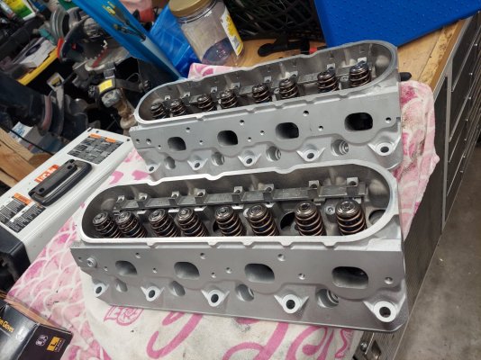

So haven't done much to the truck. I took the heads off to give as cores for the 799 heads.
The heads were remanufactured and milled. They look excellent.

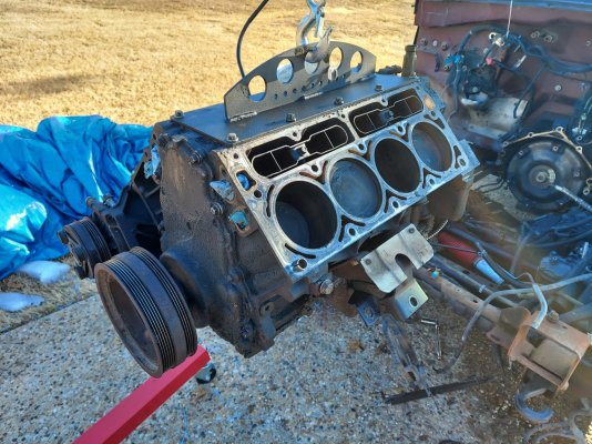

She's out boys! I ordered the best (cheapest) Chinese cherry picker and engine stand that amazon had to offer. The cherry picker seemed to be okay, but the hardware was definitely Chinese trash. Bolt heads stamped incorrectly or not at all, but was still able to use them. The engine stand box came to my doorstep like it was bombed in Afghanistan. Half the hardware and piece were missing. So now the engine sits outside until Friday when my other stand shows up.

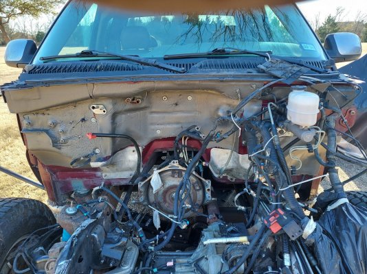

My engine stand is coming in Monday so I opted to degrease my engine bay and power wash it out. Still could use more. But for now it's good. Thinking about getting POR-15 to paint the frame.
I also went ahead and took off what little of my fiberglass firewall was left and put on this sound deadening and heat insulation mat all over my firewall. I'm not a professional by any means. I'm not looking for it to get an award either. I'm hoping this does some good for road noise and heat.
Link for sound deadening/heat insulation mat
I'm hoping this Sunday to take off all the wire loom and redo it. Most of it is crumbling.

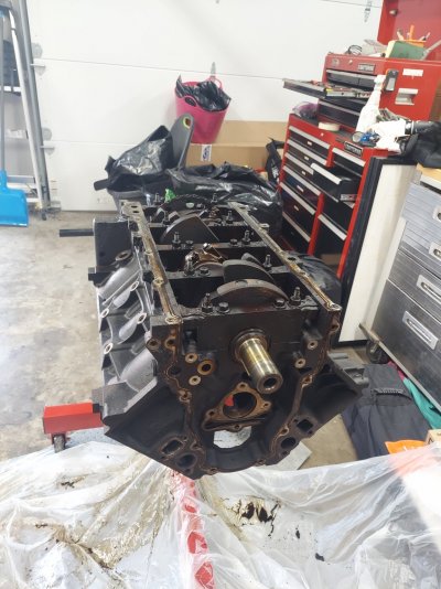

Finally got my new engine stand and it was Chinese crap, so I ordered a quality one and don't regret it. I decided to break it in right away and throw the block on it and strip it down to the short block. As much as I didn't want to, I'm going ahead and doing the full send and doing the bottom end. I couldn't justify getting to this point and not doing it. I did, however, decide to take it to a machine shop to bake the engine and clean it up and mill it and hone the cylinder walls, replace the main bearing and cam bearings, gen 4 connecting rods and new pistons, and grind/polish the crank. I opted to let a professional do all that because frankly it scares me. There are a lot of tolerances to look at, and the last thing I want to do is screw something up after dumping all this money into it.

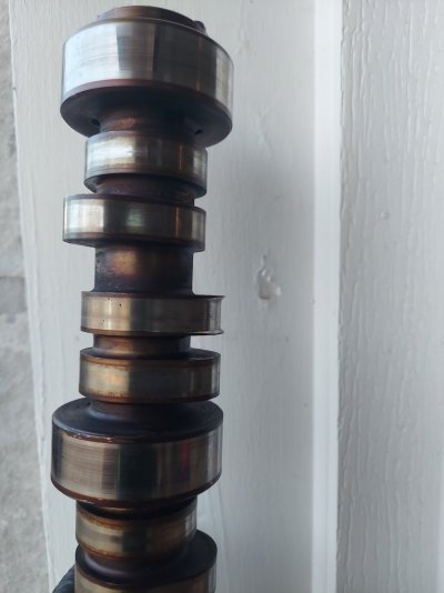

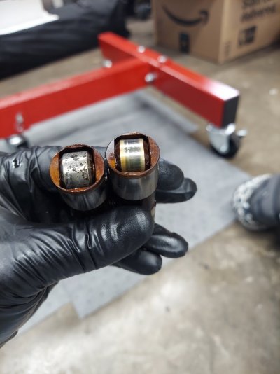

Did that wear account for any noises that concerned you?
Honestly I hadn't drove it enough to notice any noise. It had sounded normal to me, or at least i didnt notice anything. Maybe this attributed to my misfire P0300 misfire code and it running rough.
