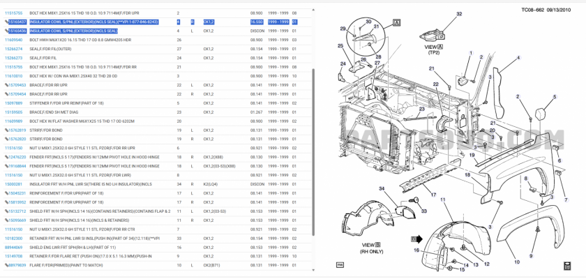

So my buddy said his 99 Silverado doesn't have that, but his 06 Sierra does. So that leads me to think it was something that was added later on the production run. I checked my 04 project Suburban and that one has it also.
according to this, 2500 4wd in 1999 came with them, if you want to buy them theres the part numbers

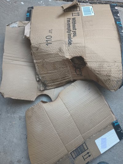

Just did a regular oil change. While I was under the truck I noticed a piece of cardboard (from my last landfill run must have fallen thru the cab/bed) and got caught between the muffler and driveshaft. It was charred at the exhaust pipe. I'm lucky it didn't caught fire and burn down the truck! SMH
Otherwise truck is running good.

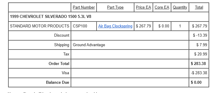

I've had an airbag code for the last few years, and I believe it's the clock spring. I ordered a replacement from Rockauto for around $280 shipped with the discount. I've never done that job, so will be looking at YT videos on how to do it.
Before you go through the trouble of replacing that, on these trucks the front impact sensors go bad frequently and are much easier to change. Out of curiosity what makes you suspect the clock spring
I have a code, and my buddy sent me a few screenshots from the service manual and I remember going through the troubleshooting tables and leading to the clock spring.
It's been awhile, so I should revisit that before replacing it...thanks.

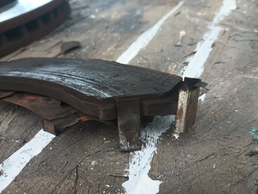

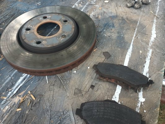

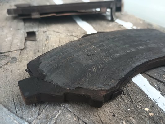

Then wife mentioned our 13 Chrysler minivan made some "sounds" when braking. I went for a test drive and sure enough, she was right. Mileage is around 95k and I had replaced the brakes around 65k. The current brakes dust badly and last week I had cleaned the wheels and this week after I drove it I noticed the front passenger wheel was completely black from brake dust.
Well, that brake pad was gone! I bought pads and rotors from the local AAP. After I replaced the other front side, that one had about 50% pad life left! So likely sticking caliper? I did lubricate the pins in that one side. I will keep an eye on it...is there anything else that could cause this?
I had just found an article on these vans. 2013 was a transition year and vans built later that year got dual piston calipers, larger rotors and a larger brake booster, and 17" wheels. Missed the opportunity to do "big brake swap" like on our GM trucks. SMH

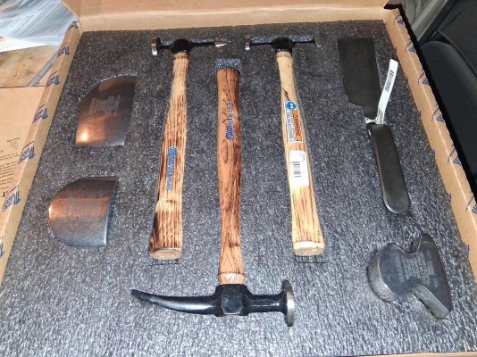

I ordered a basic body work tool kit. I've got some hail dings on my roof on the Silverado and a few dings here and there.
Got the 7 piece Martin set. Made in the USA. My Dad and uncles worked at the Dallas foundry back in the 90s, mid 2000s, which made (and still does afaik) heavy industrial sprockets, gears and stuff...I guess that's what ordered this instead of the $40 set, SMH.
Metal body working seems like an art...I gotta start somewhere tho. I think the 'ol K3500 is gonna be a ginnea pig, it's got a ton of dings and dents...hang tight, lol
Dual pistons as well as bigger rotors and pads def would have helped here. But i see pads that were unlubricated. did you lubricate the new ones?
The one side sticking is most likely from not being lubricated. The inner pad will always wear more on a floating caliper, and the leading edge should wear more especially when the pad is large and the piston count is low (Single piston life) The caliper pins may have bushings on them, they are sometimes ONLY able to be in one spot, sometimes the bushing stays in the caliper, if you double up unintentionally you will drag as well. the pins should be relubed on the other side no matter what, and the sliders/hardware needs to eb lubricated to keep from rusting and sticking again

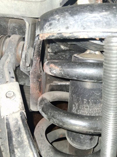

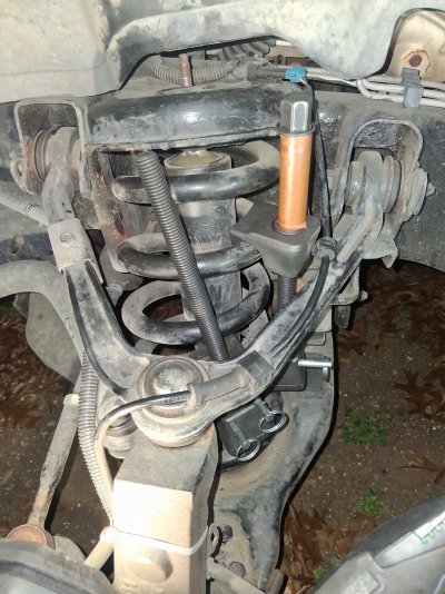

Well, that coil binding noise got on my nerves. I went and rented a coil spring compressor and tried to compress the coil. Did some sketchy copper pipe spacer gadgetry, banged on it with a small hedge hammer and did some cursing. I think it's no longer binding on the shock tower.
Will need to drive it tomorrow to see if it's fixed...
