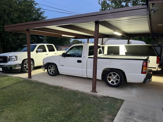

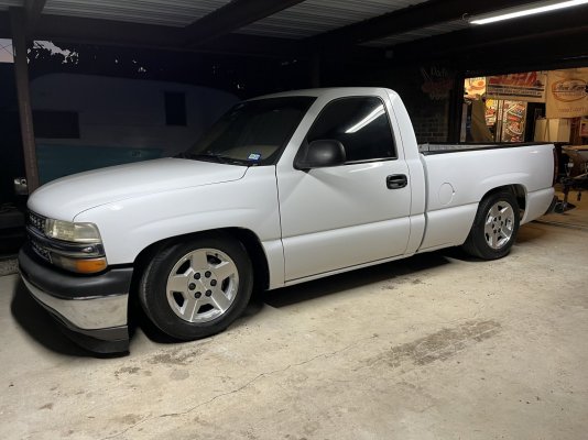

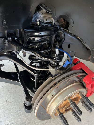

This will be a very simple build. It might take a while to finish but it will get done. WE have been wanting a street truck ever since I sold my drag truck (6.50 index s10) The better half gave me full permission to order a whipple f150 but I couldn't justify a large payment for basically a toy. SO I'm going to do what I do best, build a truck. I wanted a v6 truck and it had to be a 99-02 rcsb in white. It was already lowered on really ugly wheels.
Plans…
Mild 5.3, 400 to the wheels (building)
4.10 gears and Yukon (completed)

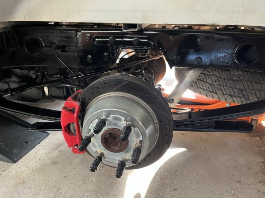

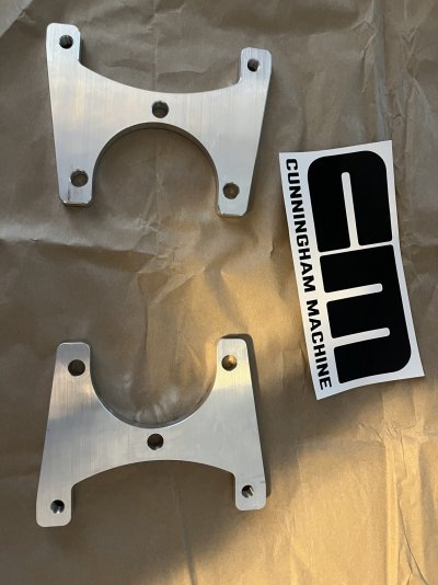

rear brake conversion for 15in wheels (completed)

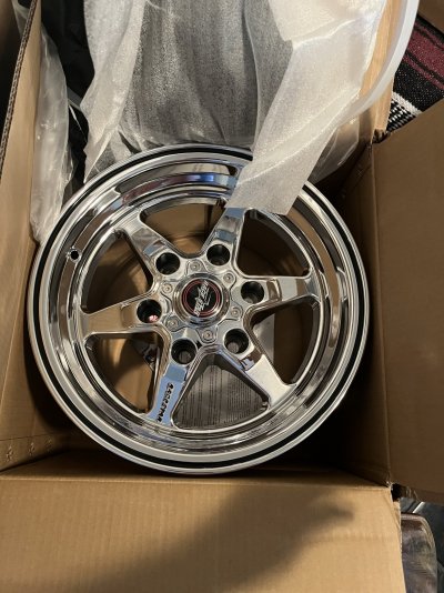

17/15 Chrome Race Stars (completed)
Traction bars (completed)
Get the body PDR'd
Carpet
White Esky style door handles
Tahoe/suburban mirrors with puddle lights or sport mirrors
New OEM lights all around (completed)

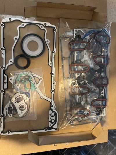

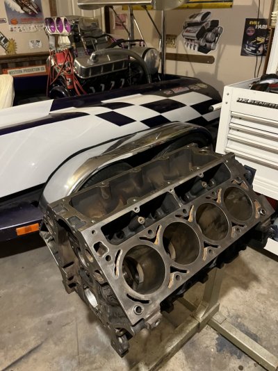

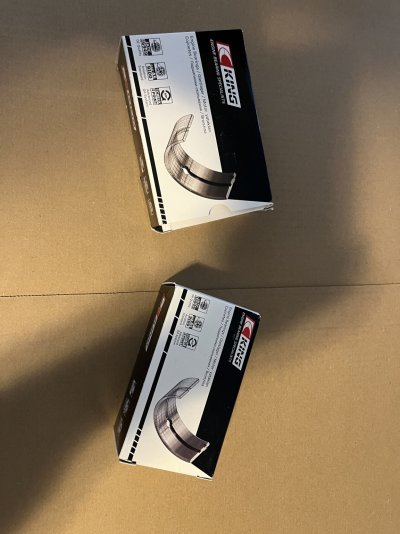

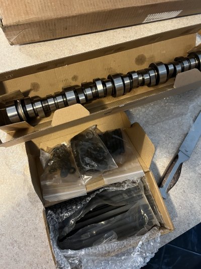

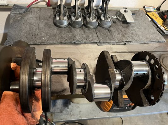

Still in the process of putting together the 5.3…
Amazon head studs
Richard holdener truck cam
King bearings through out
All new seals, gaskets, lifter trays etc.
Possibly a set of flat top pistons
Rings gapped
Get the heads cleaned up and milled.
Most likely run the Nitrous Outlet plate kit on the truck.
860
2,262
Amazon head studs
Rings gapped
Looking good!
What are thinking for the pistons? Hypereutectic or forged?
DateNight
Jan 19, 2025
237
726
Tx
Looking good!
Thanks! Probably get gen4 rods, cheap summit forged pistons and gap the rings @30. I argue with myself a lot about this since there is a ton of SBE 5.3s on the bottle also.
I really wish I would have found a 6.0 4l80e to start with, build a 407 and call it a day.
860
2,262
Yup. You absolutely can't beat a 6.0/4L80e combo. Heck, I would take STOCK 6.0/4L80e in a lightweight RCSB, LOL. I bet that would be a fun truck to drive around and do burnouts on the way to Starbucks or whatever.

That’s the goal. Won’t be the fastest but if I can hang with the 5.0 mustangs and corvettes I would be happy.
Another option I was thinking about was boring it out and putting 3.898 pistons in it and making a iron block 5.7
860
2,262
5.7 iron block LS would be cool.
I think if I ever yank out the 5.3 I swapped into my 99 Silverado, that's what I would go with...
