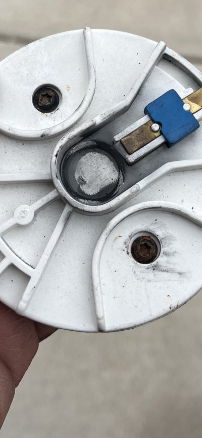

Curious, did you give it a turn either direction and at various points in that motion, give it a shove side to side? That's what it took for me to notice the wear on the 7.4 I put in the HD.
Seems odd a rotor could look that bad with so few miles. There's a root cause that should be a flashing red sign...once you find it.
No side to side movement, just a little advance movement.
I really think cheap china junk was to blame. The metal tab on the rotor broke and was MIA. That would explain why it would idle fine but at load and high rpm the ignition would cut out. I’m sure the distributor is worn but it “good enough” right now.
I can't believe that for some reason, I focused on the screws condition and did not see the cap button tab missing. Lot to be said for all that carbon firing off in there.

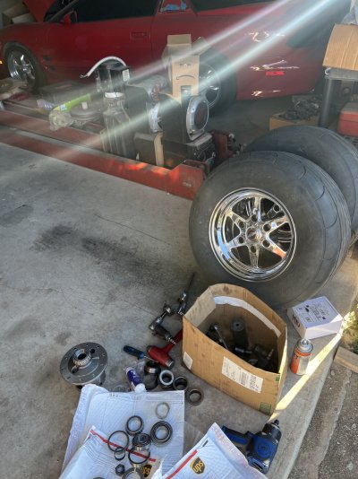

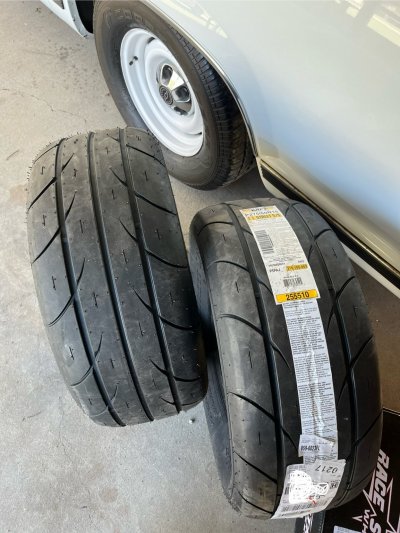

More pieces to the puzzle…
275-60-15 for the rear, they will go on the 15x10s
The fronts are 17x7, they showed up today also.

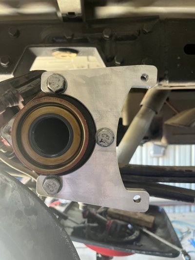

I have to pull the axles to remove the backing plates in order to run the gmt400 disk brakes and caliper. Snowball effect, should I go ahead and put gears and posi unit in the rear end. Right now it’s a 3.42 rear gear open diff, I’m goin to put 4.10 gears and Eaton style posi unit.
You already bought the new differential and gear set? If so, I would say, of course!
If you haven't then it's a budget question. But doing it now, you avoid doing of the work twice, right?

4.10 gears and Eaton posi are on the way from quick performance. Hopefully they make it before Sunday. I would like to get them installed Sunday and get my OBS brakes installed so I can test fit the 15x10s and 275s

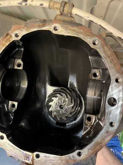

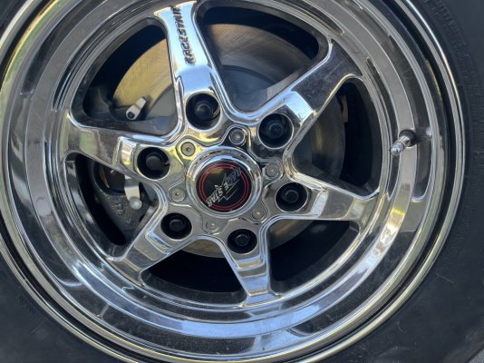

Installed the posi and 4.10 gears yesterday. Turned out good. Also installed the gmt400 disc brakes on the rear to be able to run a 15in wheel.
I put a few miles on it yesterday, the difference is night and day.
Nice, that is a sweet looking truck! I bet that leaves a stop light great now.
