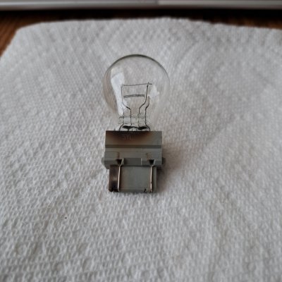

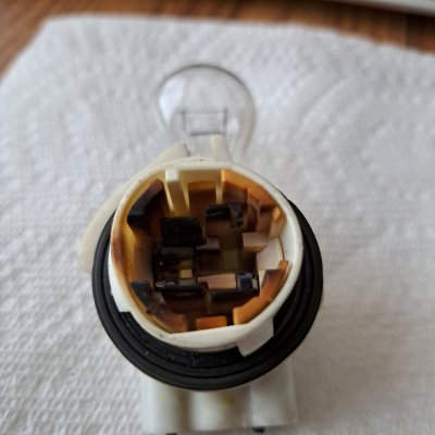

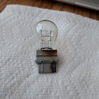

This is on my 2005 Tahoe Z71. Came back from tacos today and coming down my street and my landlord pointed at the d/s front and said my daytime running light was out. Sure enough, it was. Opened it up and the bulb/socket were both charred and slightly melted on one contact. Had to settle for a Dorman part and I replaced old with new and a new bulb and now, all good.
If you look close enough, you can see the socket got hot enough, that it is no longer round.

Yeah, those DLR sockets do get damaged from the heat over many years of use. I just changed one I had laying around. Can't remember where I bought it but it was an AC Delco one. Maybe going LED on those will solve the issues?

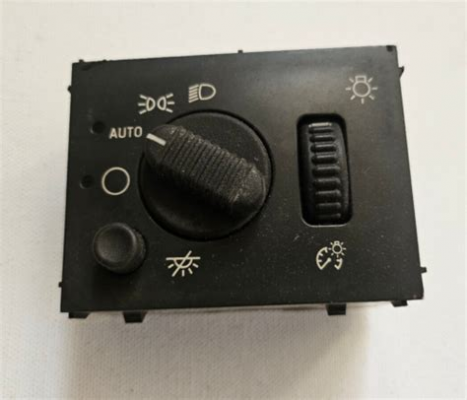

can't turn headlights off, my switch is pictured, you can move it to the O position, but it snaps back to A. in A lights come on/off randomly with changing brightness etc. Also headlights come on when you start it up anytime for some reason, then go out pending outside brightness.
unless i'm missing something?

Understand.
Oh, that's strange. Unless it's a Canadian thing (that's where I recall you live, right?), switching to the circle should override and turn them off. That's basically the OFF switch.
Headlights being ON on startup I think is normal?
But them coming on/off with varying degrees of brightness sounds almost like grounding issue. That's definitely NOT normal.
