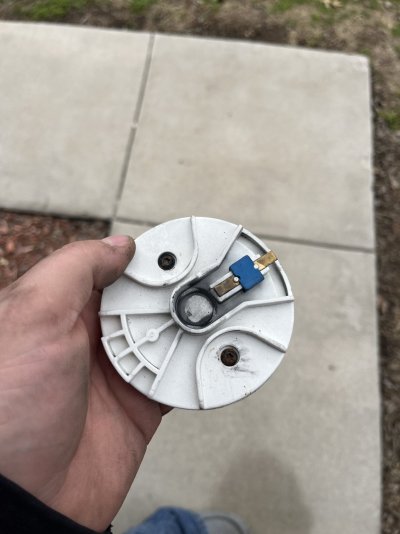

What does the cap and rotor look like?
New, maybe 50miles on it. but I’m going to pull it off again and inspect it.

At 275K if that's the original distributor, it's almost guaranteed to be worn out. When you pull the cap off next time, try turning the rotor either direction and simultaneously give it a gentle shove side to side as the rotor pops up.
Forever ago, my '96 C3500 wrecker with the Vortec 7.4 had.. can't remember the miles? But a boneyard engine with unknown miles on it. It ran strong but had a hiccup at highway cruise. Upper bushing for the distributor shaft was toast. Replaced it and no more issues. *edit for clarity - replaced the distributor.
Had another '96 7.4 that I swapped into my '94 3500HD when I built it into a wrecker, had 236K or so when I looked into ignition issues on it, and the upper bushing was so bad that the new rotor I'd installed had the little plastic ridges in it chipped away by smacking the terminals inside the cap.

Yea, all that carbon crap does not look good. How about the cap? How about the bushing?

Bushing in the distributor feels good. No slop. I cleaned up the old rotor with some sand paper and the inside of the cap too. That part had less than 50 miles on it
Curious, did you give it a turn either direction and at various points in that motion, give it a shove side to side? That's what it took for me to notice the wear on the 7.4 I put in the HD.
Seems odd a rotor could look that bad with so few miles. There's a root cause that should be a flashing red sign...once you find it.

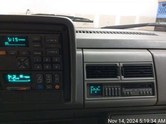

I used to be that way but I got tired of messing with it. In my '93 I swapped the non-working stock AM/FM/cassette with the upgraded stock AM/FM/cassette with the 5 band EQ; I'll be modding to add a bluetooth receiver inside the unit. A member on gmt400 is sending me another one of those EQ setups so I can replace the bad one in my '94.
It's a little hard to hear over the engine/exhaust in the '93 and the AM reception is a little static-y, almost certainly need to replace the electrolytic caps in the CDM before they go bad and start leaking all over the board (hopefully they haven't yet.) Dash speakers are working originals but the B pillars are dead. Should be easier to hear once I replace those since they're right by your head in the regular cab.
