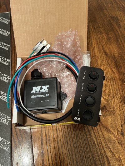

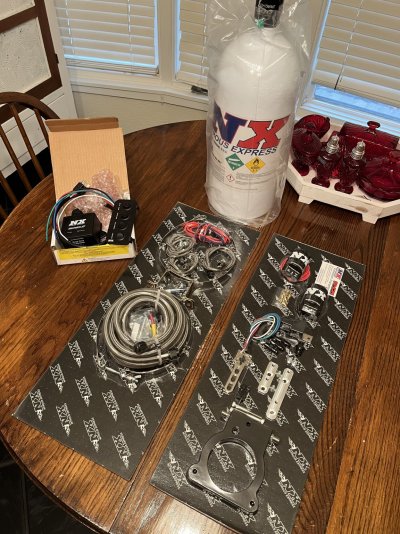

My goodies from Nitrous Express arrived. I’ve been busy doing family man stuff so haven’t had a chance to do anything yet.
I bought the 3 bolt nitrous plate kit with bottle. I now have 5 bottles, they are all blue NOS bottles and I needed a white bottle because I’m OCD. Also got a Nitrous express Progressive controller to help with traction and help with abuse. Lastly a NX switch panel that replaces the cubby by the headlight switch.
I’ve ways ran my bottles the the bed, but I’m thinking about putting this one in the cab since this truck will get a lot of miles and thieves suck.

Been a busy week, I’ve put in 71 hrs since Monday morning and still have 7 more days on call.
I decided to stay with the 3 bolt throttle body because it works well and I just don’t care to deal with the extra BS thats involved doing the nnbs/tbss intake for the power levels that this truck with NA. And later down the road if it gets a procharger then it doesn’t matter either.
Here’s some pics of the nitrous stuff.
