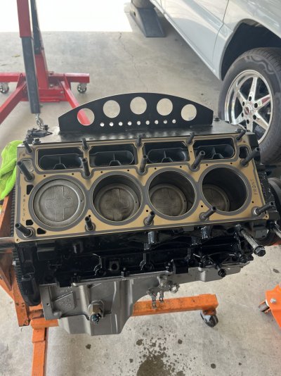

short block is assembled. Nothing fancy just a RHP cam, meilings oil pump, head studs etc. This is just to get it running and to enjoy. I have another engine in the works.

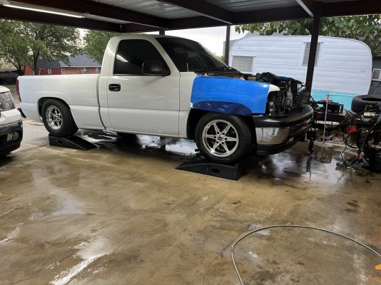

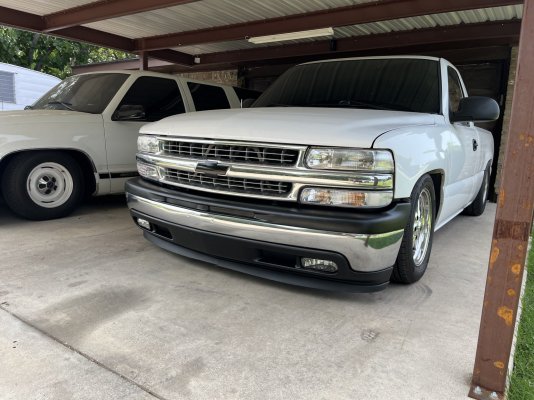

Overview of the truck…
4.10 gears
Yukon locker
Traction bars
RHP cam

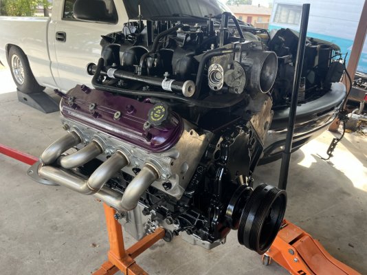

Shorty headers, cut and tucked catless Y with a spintech muffler
built trans

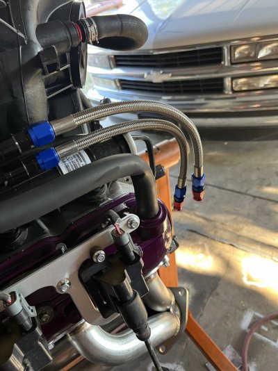

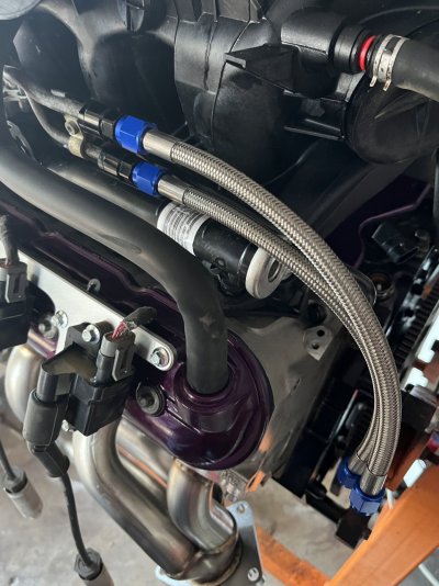

4k trans cooler with all new lines and AN fittings.
3k stall
Lowered
Race star wheels, 17s in the front and 275 Drag radials in the rear.

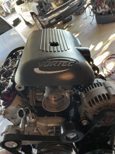

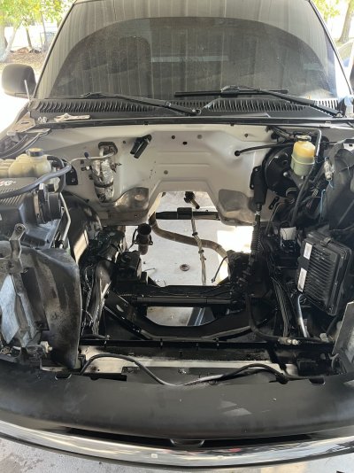

I’m want it to be as reliable as possible and the engine bay to be very stock looking but with little hints of performance.
Most people would have done the efan swap but not me, instead I bought new upper and lower fan shrouds for a v8 truck
I’m keeping the stock air box but running a smooth black intake tube from a cold air kit.

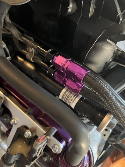

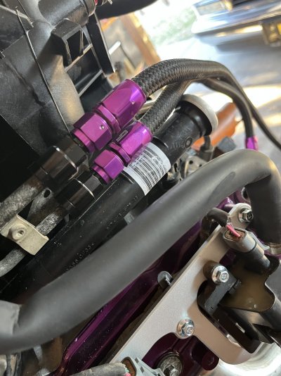

black AN fittings and hose for the 40k trans cooler

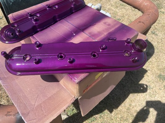

Only color I added was candy purple for the valve covers and valley cover to match the traction bars. Might do a purple catch can also.

Interesting. Looks like you have the black box ECU. I thought that was 99 only, but maybe it was 99-00?
I think 01 they went to the 0411 ECU on the V6?
Not sure when they went to the 0411, luckily I have one though. I will throw the black box on the shelf since I already have it unlocked and spent the credits. Never know when I might need it for another project.

Purple is a cool color, what is in your engine build?
I will add alittle more to that earlier post. It is a cam only 5.3 since I knew anything more would hurt the 4l60. So I decided to go way overboard on the 4l60 build to handle whatever came in the future. Turbo, procharger etc.
Cammed 5.3, btr Springs
Cut and tucked catless Y with a spintech muffler
4.10 gears and Yukon locker
3000 stall converter
Crazy built 4l60e
I will tune it myself with HPtuners
